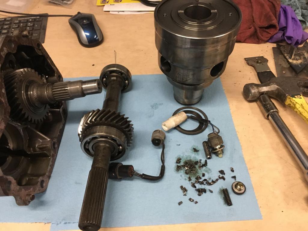

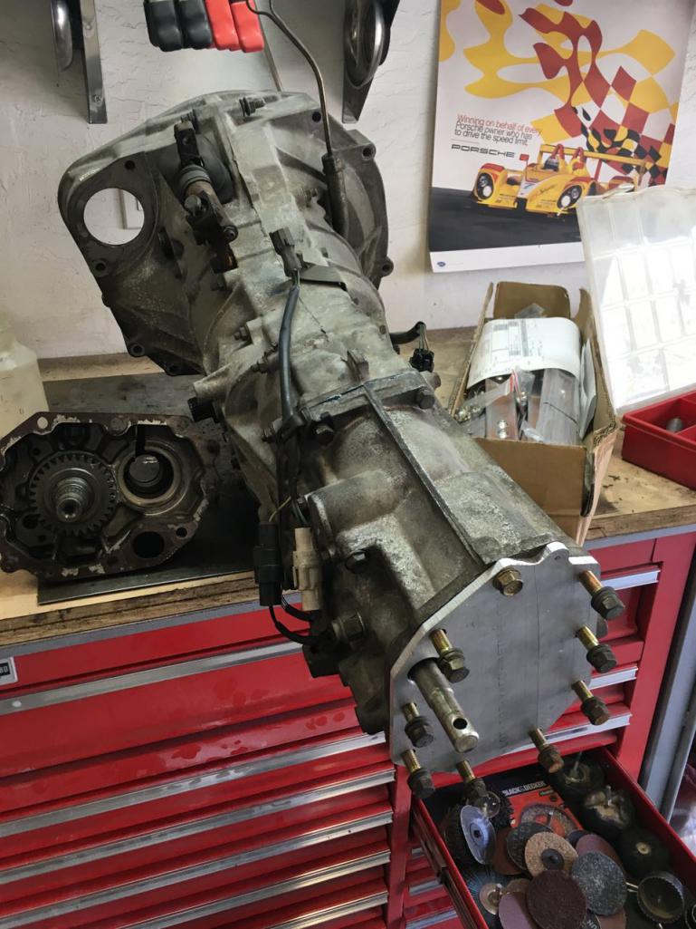

- converted my subaru trans to 2wd (found some ugly bits in there, turned out be harmless)

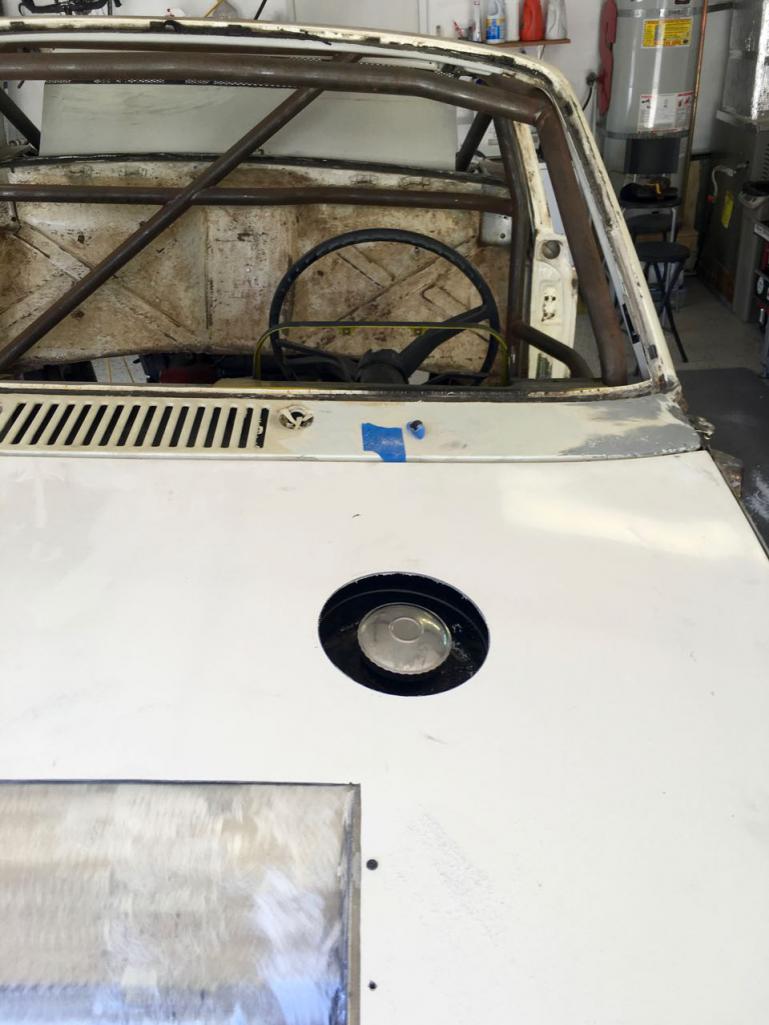

- installed my through-hood gas cap

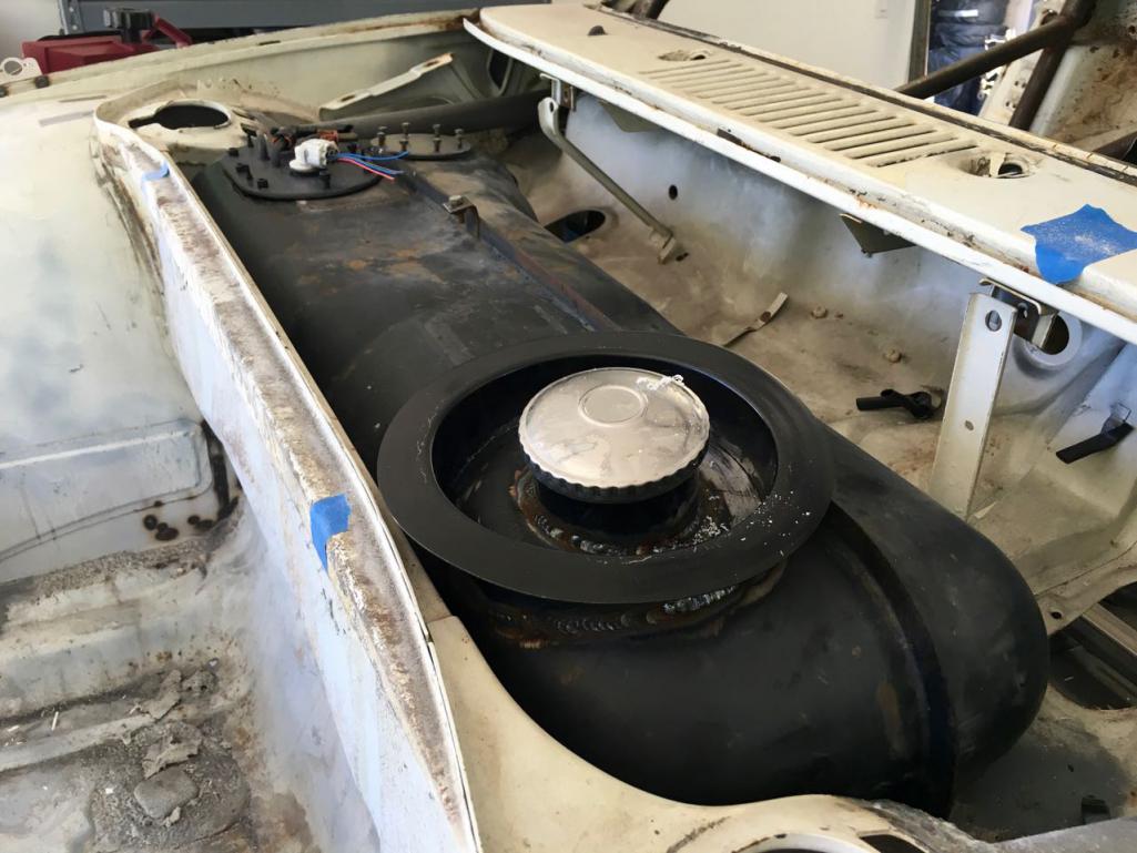

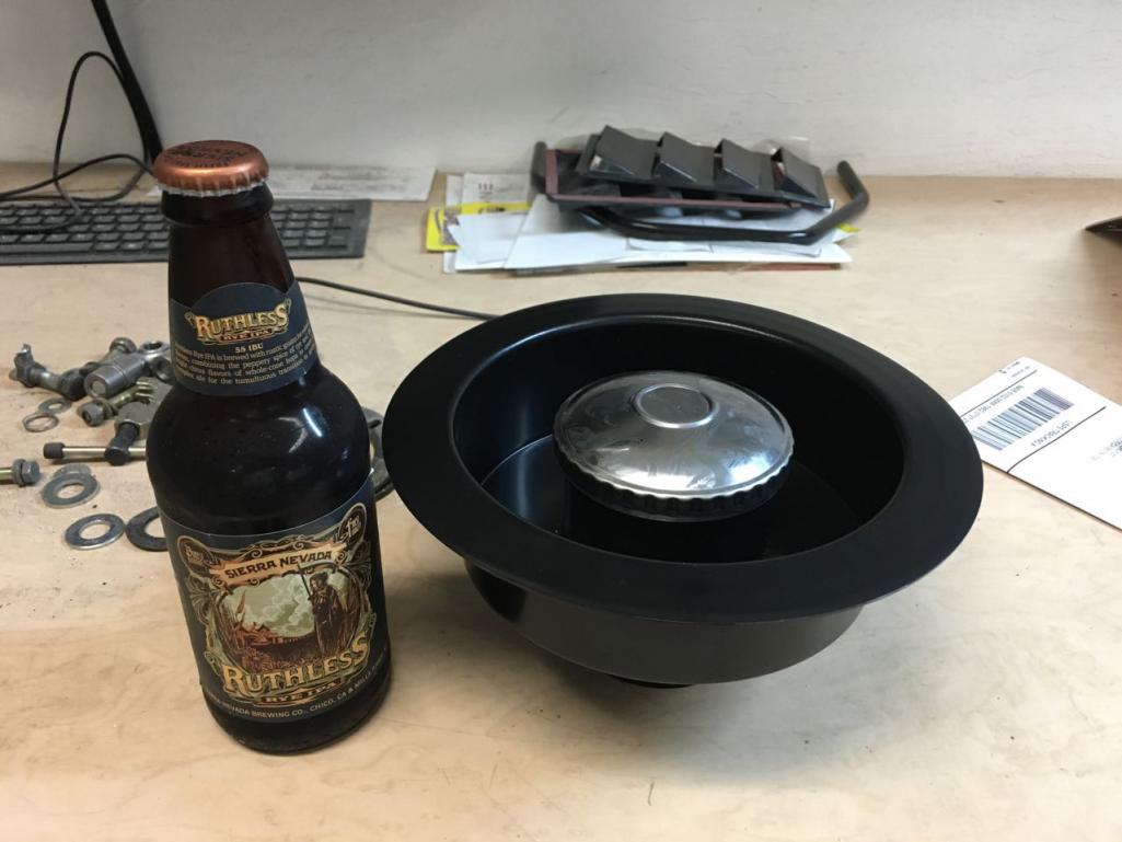

Generic gas filler from some internet site:
Installed. Separated the neck from the ring, welded in. Took off the bottom of the bowl and welded around the perimeter. Need to add a drain, but that ain't no biggie. Not a lot of room to work with in there!
Not a bad look, no?
Bits of ground up center-diff c-clip. Had me worried! Turned out to be just fine.
Tail panel bolted up after the conversion
