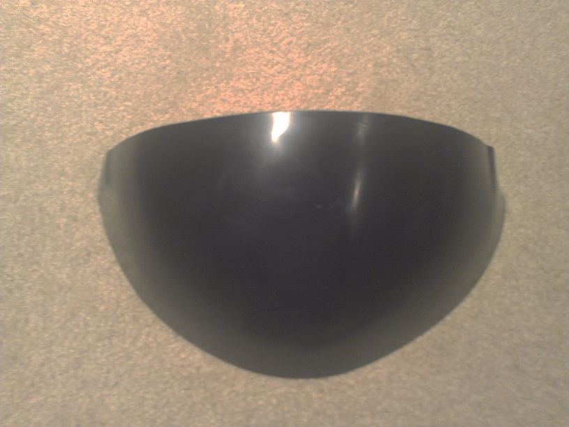

Should I paint the flat fan shroud?
Paint or not
Paint it Red to match the car [ 16 ] ** [22.86%]
Paint it some other color. [ 3 ] ** [4.29%]
Leave it the current amber fiberglass color [ 51 ] ** [72.86%]

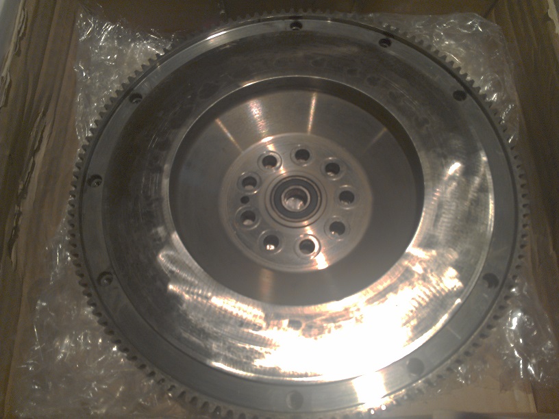

Used single mass flywheel and ring gear.

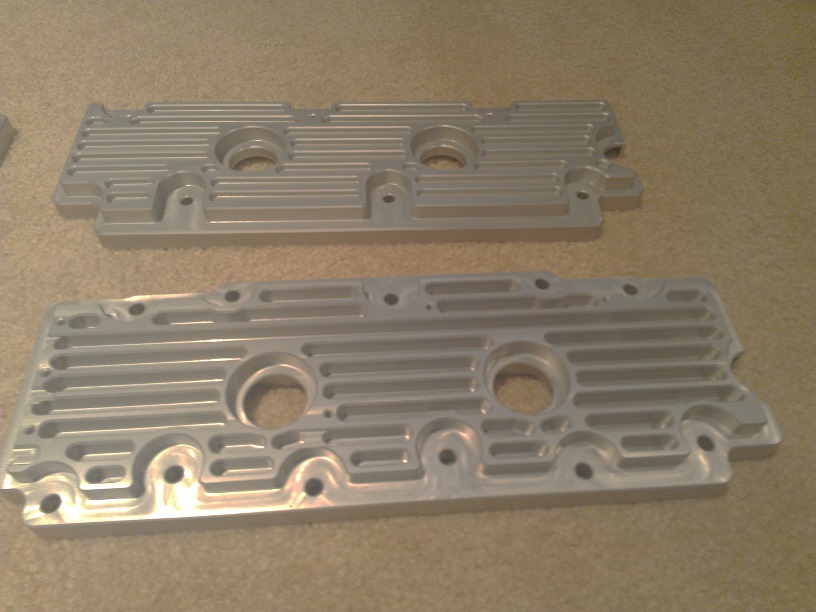

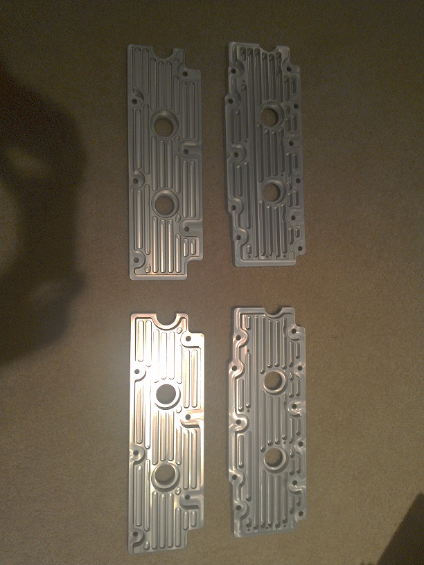

Billet 964 valve covers. They are about 25% of the cost of factory new valve covers, and they are supposed to seal better.
Block off for the top of the fan shroud.
