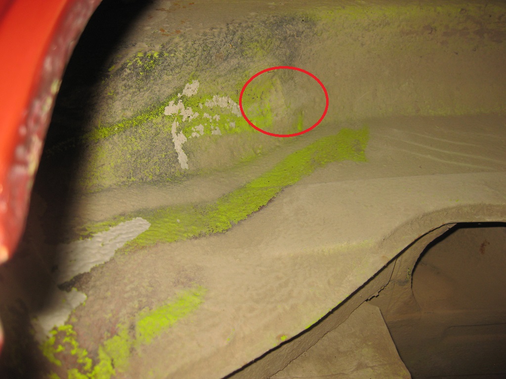

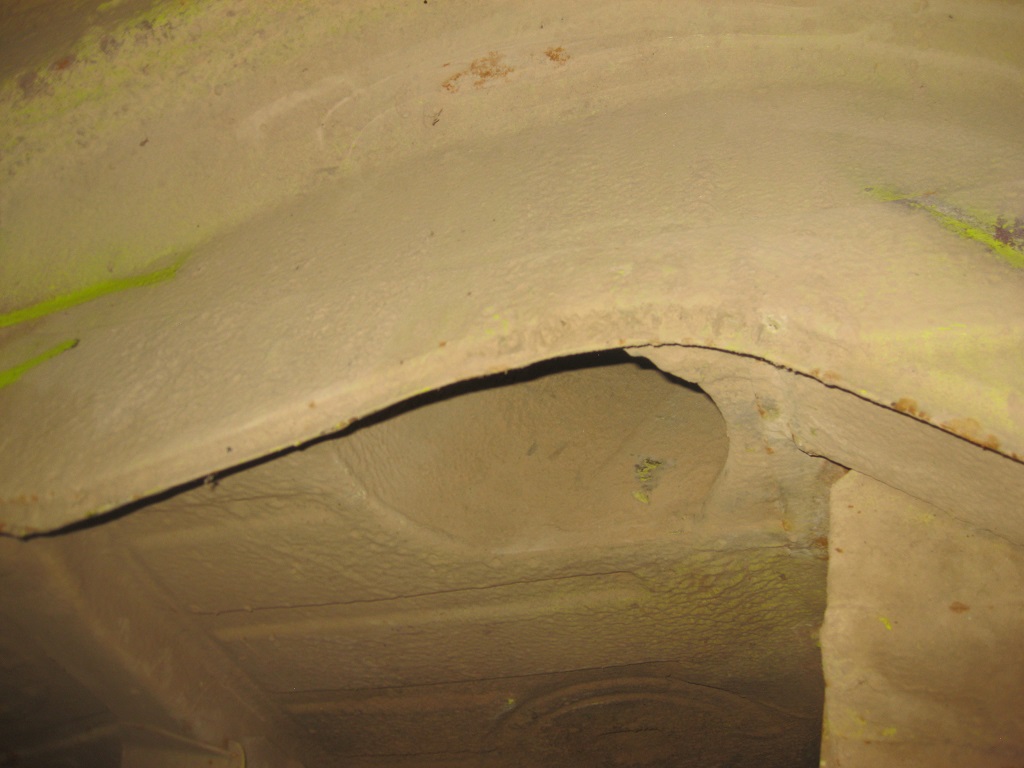

Driver's side wheel well. I had a friend look at it and he thought he saw a small kink that I've circled in red (there is a vertical crack in the undercoating that's hard to see in the pic), but it really doesn't look like a kink to me (but what do I know).

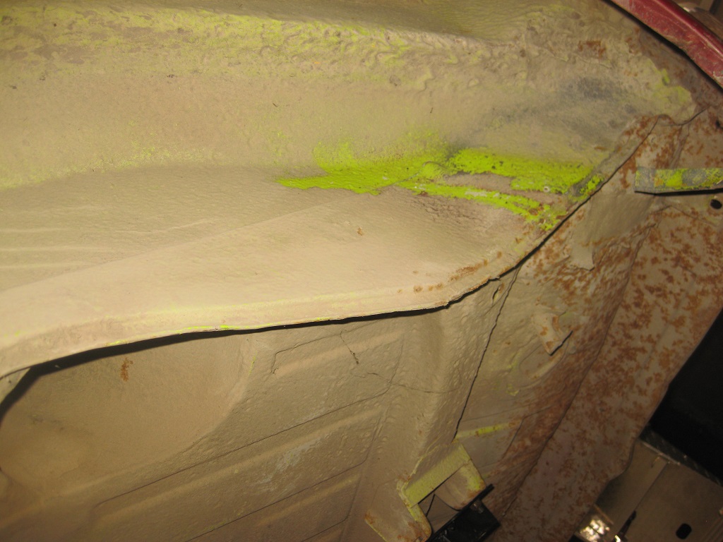

Passenger side wheel well:

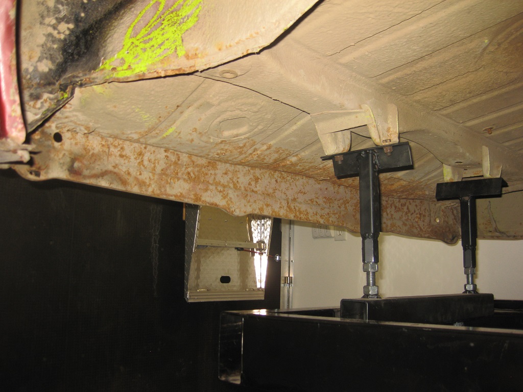

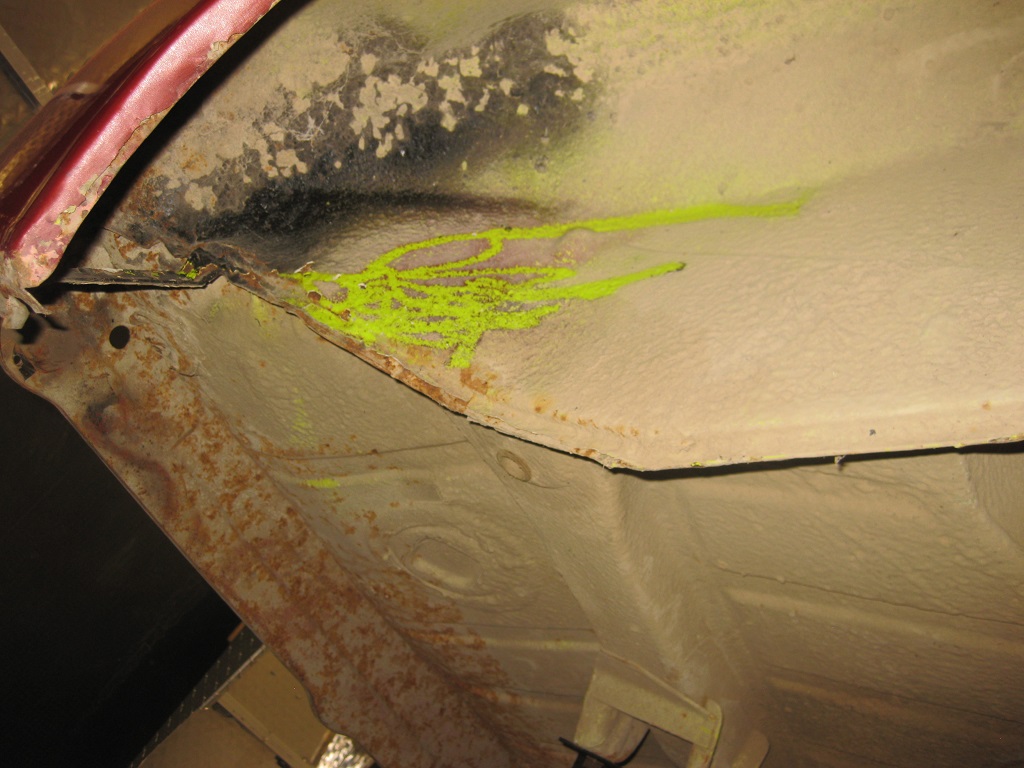

Another shot of the underside. You can really see in this one the difference relative to the trunk floor and if that bracket were present on the passenger side how far off the hole would be (when looking at it imagine that the trunk floor and trans crossbrace are level).

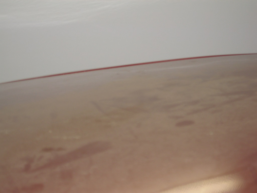

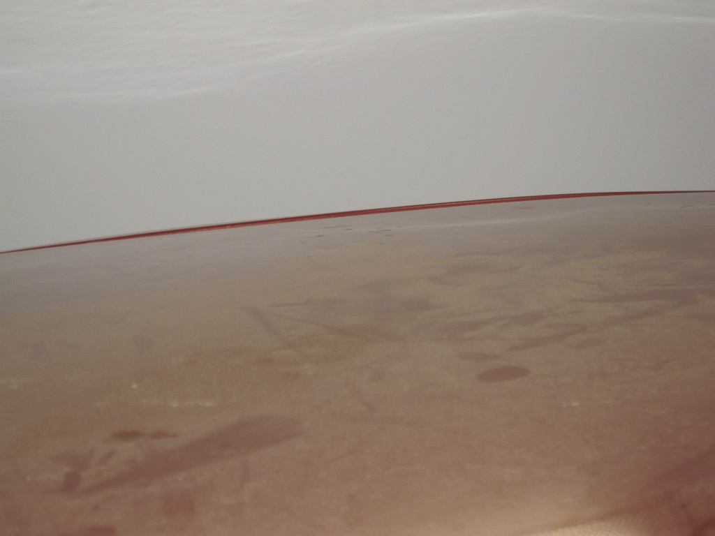

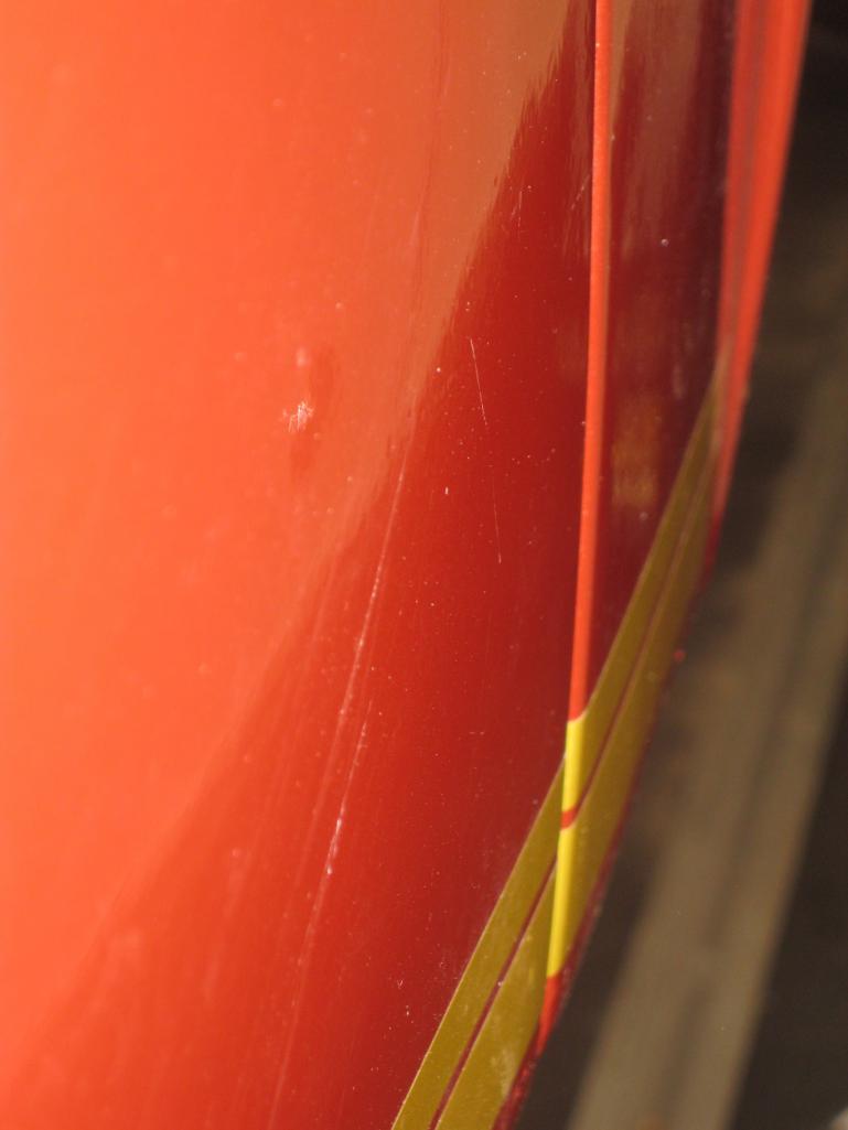

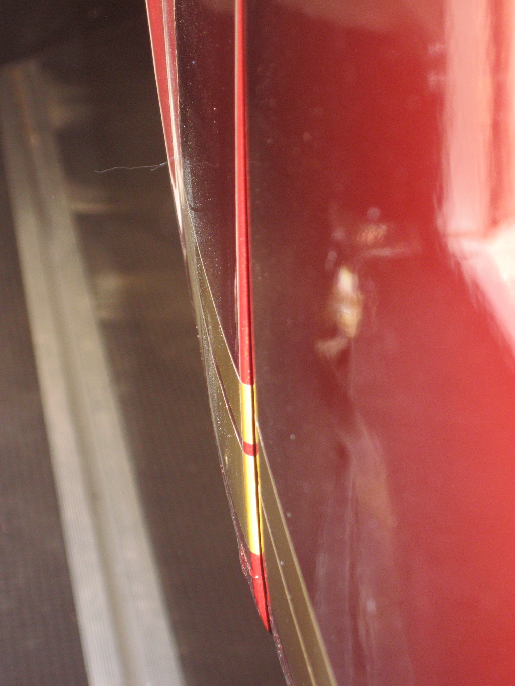

Here are some pics of the other trouble spots in terms of fit. The trunk lid is bent so in the two pics below I'm trying to hold it down with one hand and take the picture. The first pic is looking across from the passenger side at the line of the trunk on the driver's side fender. The fender doesn't quite match up. Looks like it bowed up when it was pushed in from the collision.
This is looking from the driver's side at the passenger fender-trunk seam. Not as bad as the driver's side:

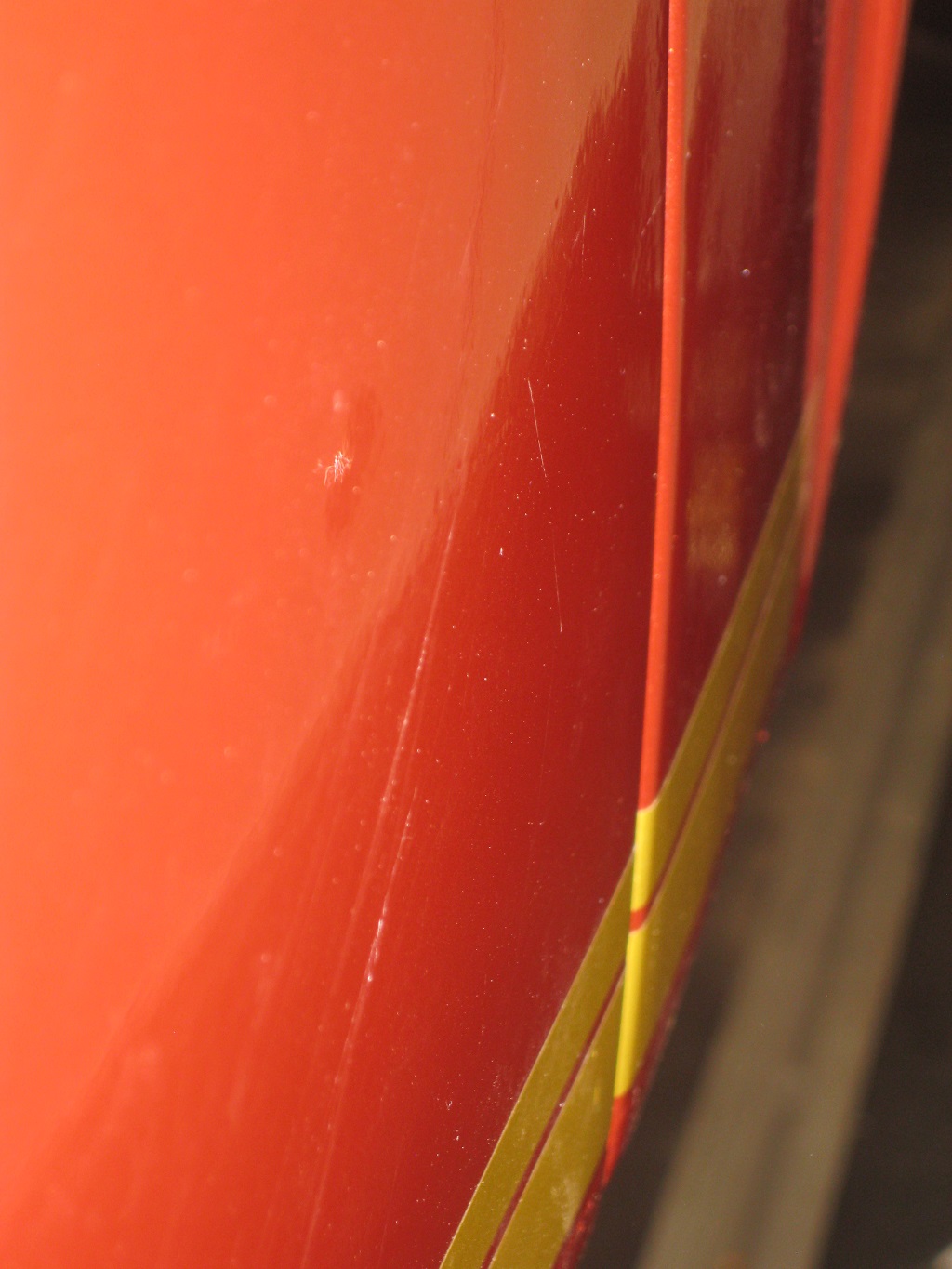

Here's the bowing I was talking about at the driver's rear fender where it meets the door:
Same on the passenger side:

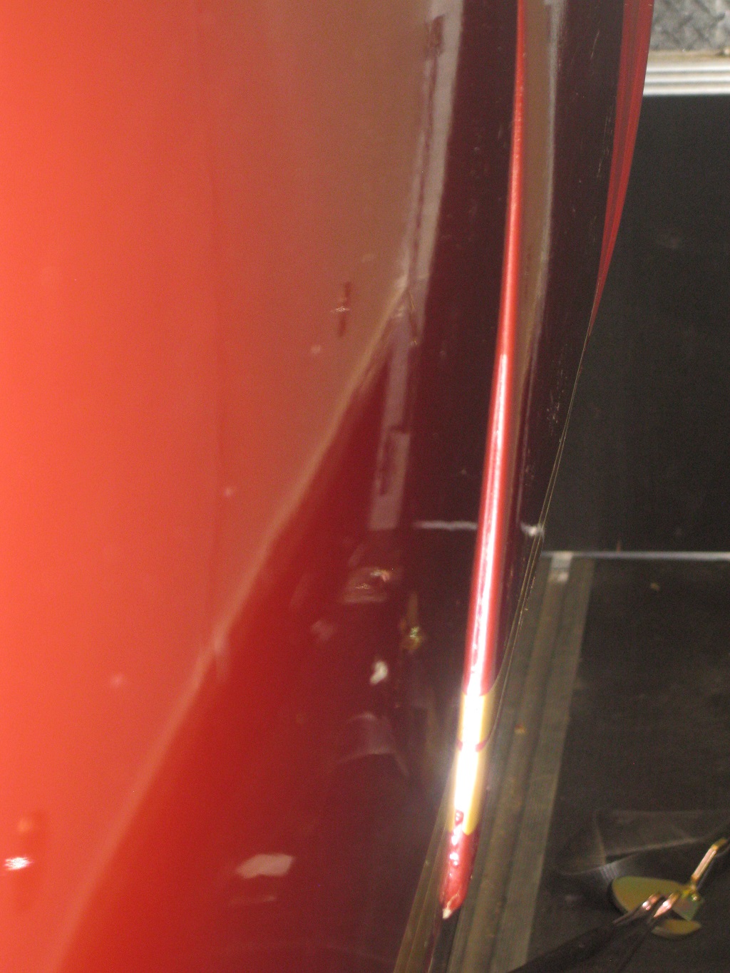

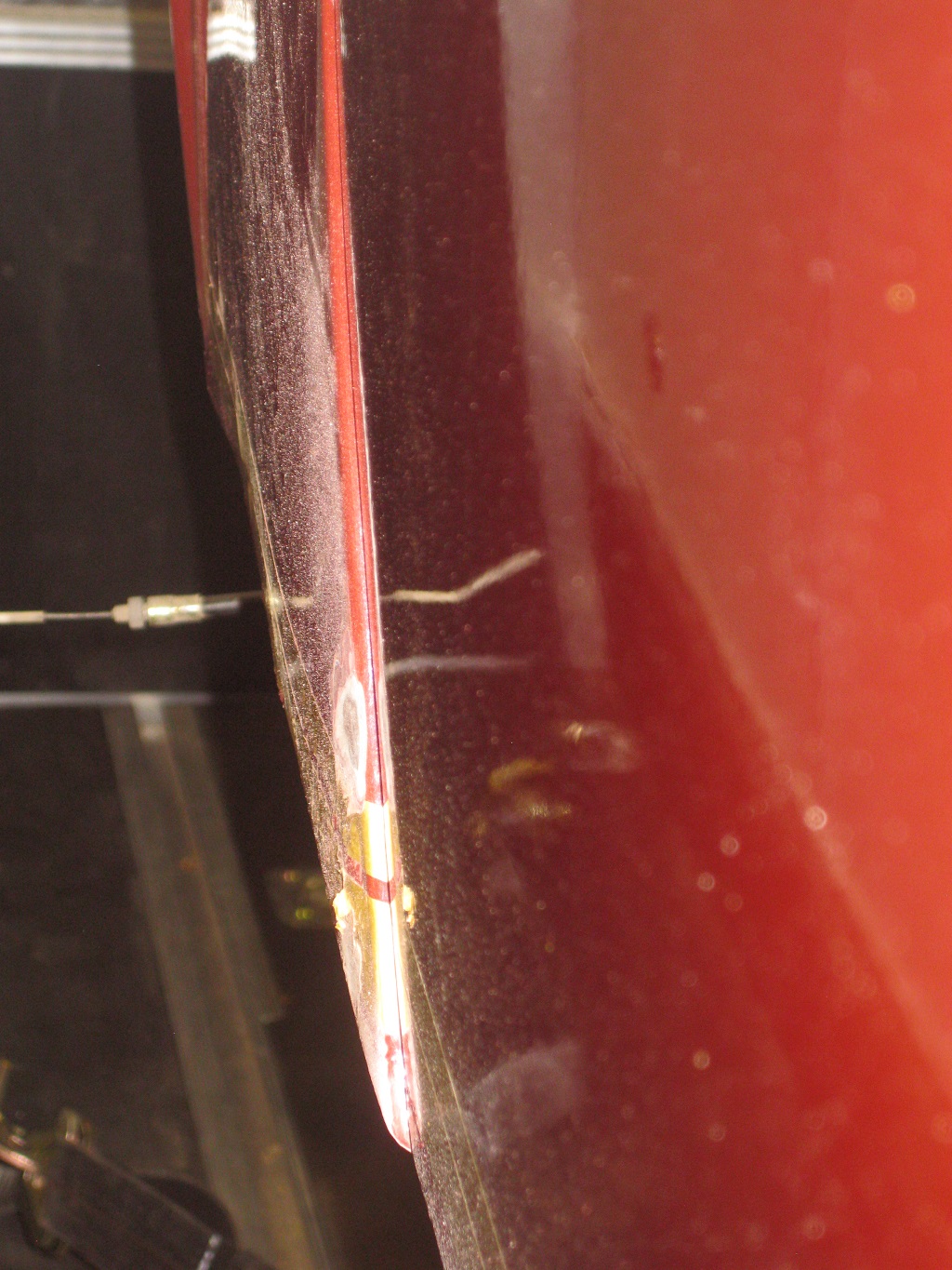

But the doors fit better at the front, suggesting to me that it can't be corrected by adjusting the door (but I've never tried adjusting the doors). Here's the driver's side door to front fender (I hadn't noticed before that it is a bit out):
And here's the passenger door to front fender. It also appears to be a bit out but in real life it looks pretty good.

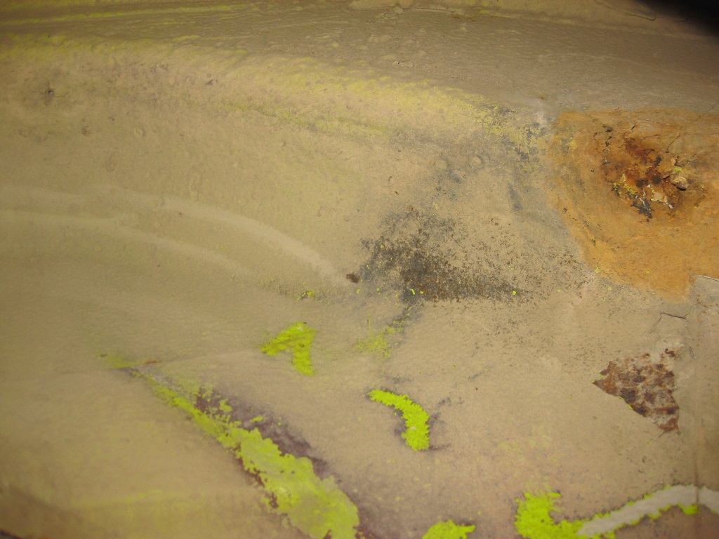

sixnotfour   that maybe from the trunk torsion bar slapping d...   Jun 5 2016, 08:25 AM
doug_b_928   Interestingly, that crack is exactly where the top...   Jun 5 2016, 09:52 AM
