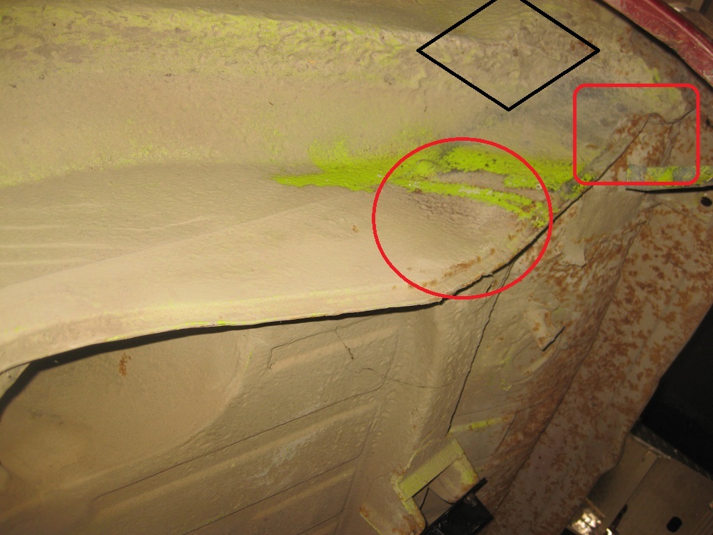

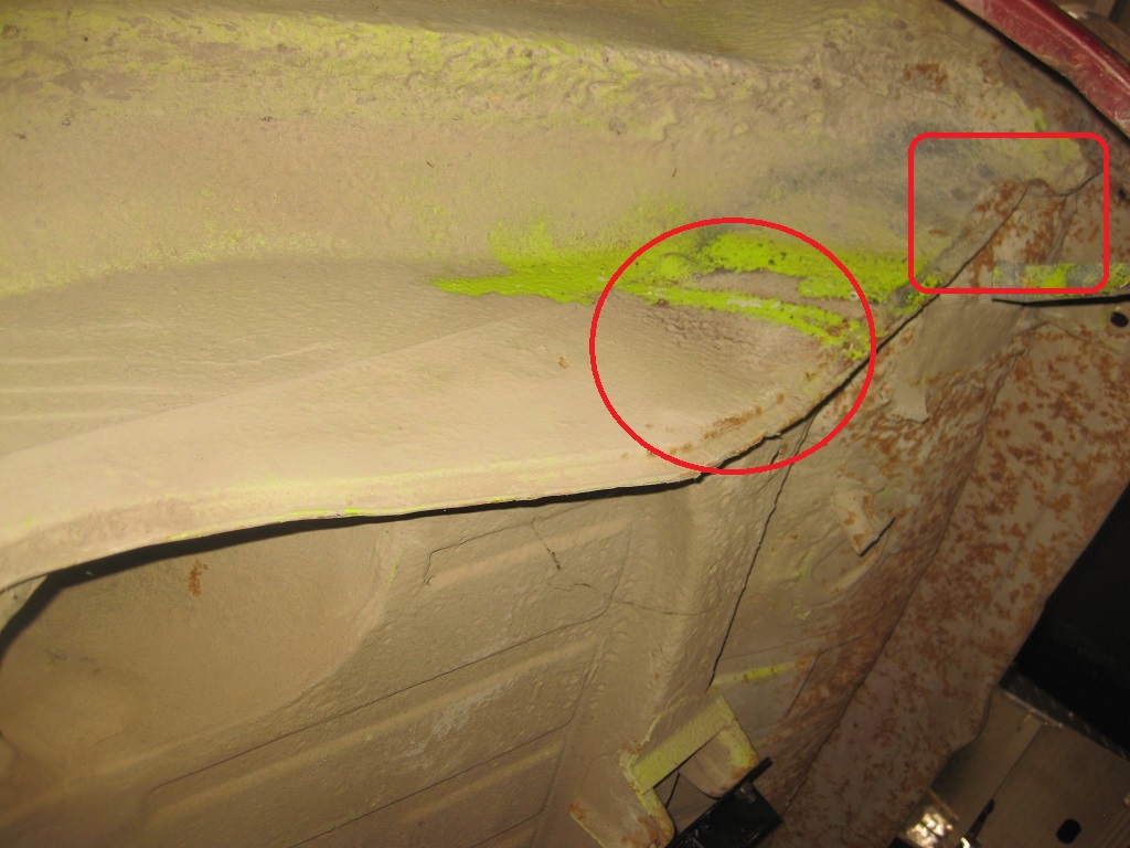

Here
And the more I look at it the more I see. This looks kinked too.

rick 918-S   Here And the more I look at it the more I see. ...   Jun 5 2016, 10:51 AM
