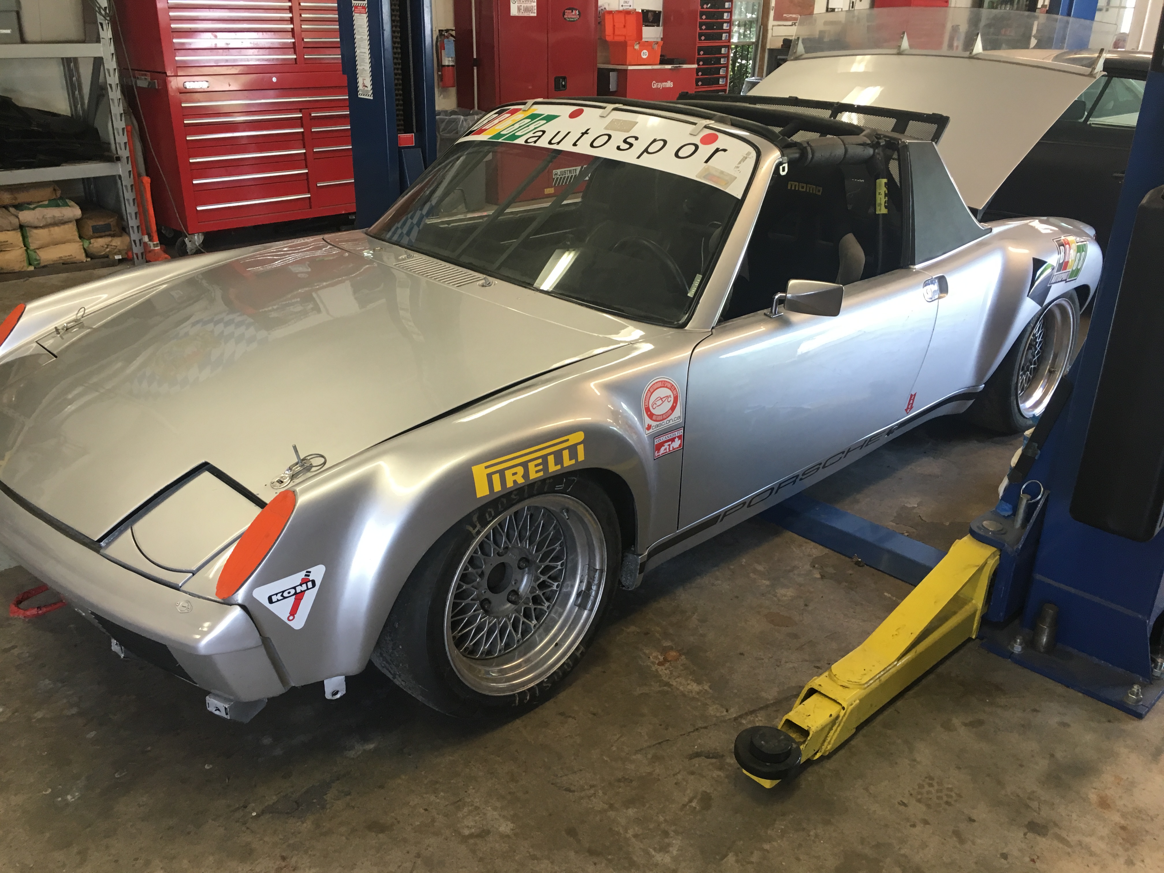

raynekat   So I'm thinking about a narrow body GT that is...   Feb 12 2015, 10:41 PM
raynekat   I love this car.... How close I get to it remain...   Feb 12 2015, 10:43 PM
