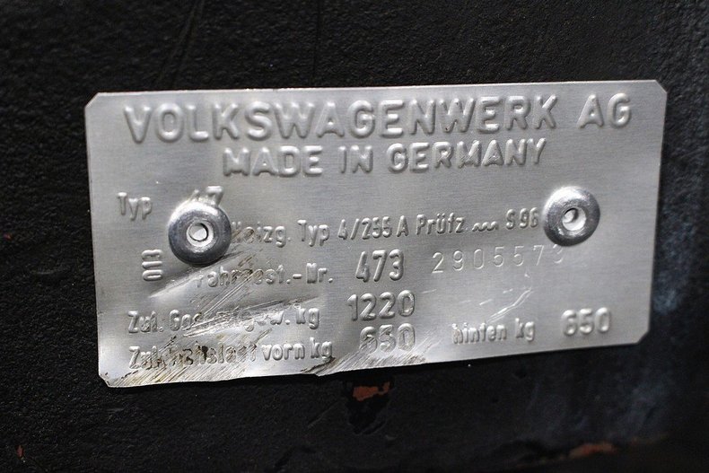

> Does this car have a fake VIN?
era vulgaris
post Jun 8 2016, 09:36 AM
J is for Genius
Posts: 986
Joined: 10-November 13
From: Raleigh, NC
Member No.: 16,629

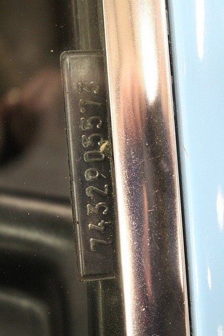

Check out the closeup pic of the vin tag in the windshield. Notice anything odd?

6freak   I thought the fours didnt have a windscreen vin ta...   Jun 8 2016, 10:36 AM

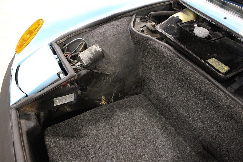

r_towle   Modern rivets on the plate in the front trunk.   Jun 8 2016, 11:00 AM
Mueller   Wonder where the car was restored, illegal in many...   Jun 8 2016, 11:09 AM

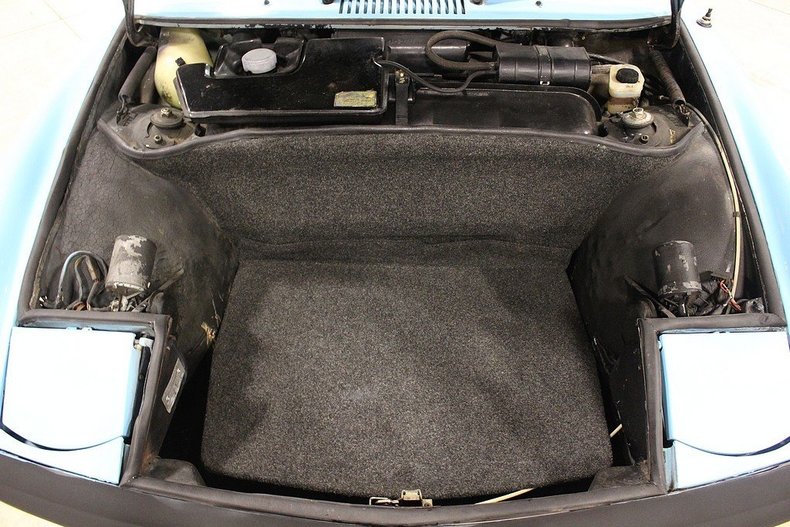

rhodyguy   Much strangeness in the front trunk. I see some re...   Jun 8 2016, 11:13 AM
SirAndy   Why was it painted black and then shot with some c...   Jun 8 2016, 11:27 AM

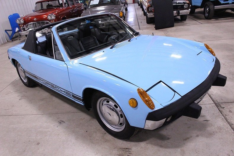

rgalla9146   That car was once a couple feet shorter . Check...   Jun 8 2016, 11:21 AM
Jonathan Livesay   The right headlight bucket looks a bit off too.   Jun 8 2016, 11:30 AM

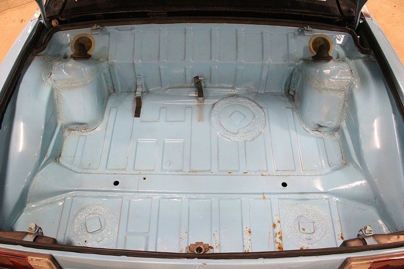

walterolin   Dents at the base of both rear shock towers. And...   Jun 8 2016, 11:46 AM

r_towle   That is ALOT of undercoating on that inner fender....   Jun 8 2016, 12:13 PM

Perry Kiehl Clone   Definitely been hit on the right front, who knows ...   Jun 8 2016, 01:34 PM
SirAndy   Definitely been hit on the right front, who knows ...   Jun 8 2016, 02:08 PM

Jonathan Livesay   I am intrigued by the windshield vin it sure looks...   Jun 8 2016, 03:32 PM

era vulgaris   You guys missed that there's no VIN sticker in...   Jun 8 2016, 06:24 PM
Jon H.   It looks like they painted over the one of the jac...   Jun 8 2016, 07:29 PM
turk22   looks like the VIN was also blacked out on the Mai...   Jun 8 2016, 08:15 PM

stugray   It appears that my pointing out that the windshiel...   Jun 9 2016, 05:33 PM
SirAndy   took down the windshield VIN picture Nope, still t...   Jun 9 2016, 05:48 PM

Garland   Check this out! More on the same blue peices o...   Jun 9 2016, 06:52 PM
r_towle   Somebody gonna get fired for the misprinted VIN ta...   Jun 9 2016, 10:55 PM
