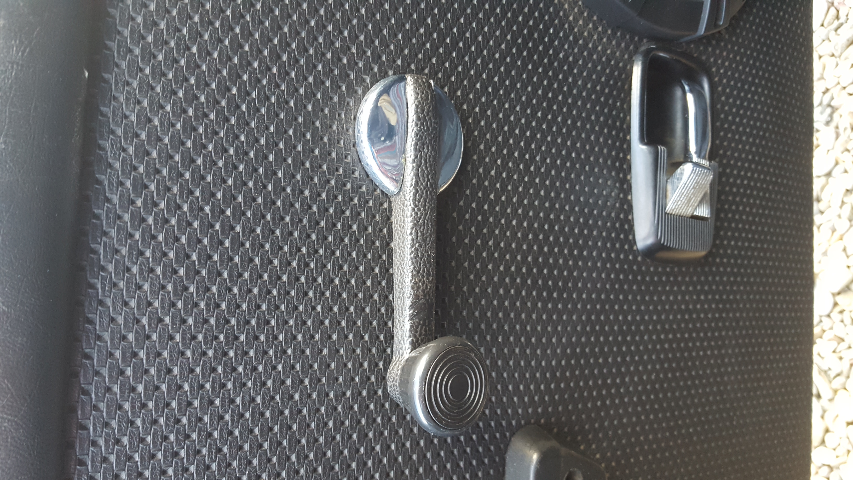

Also, unless I remember wrong, in '73 the door hardware such as the window winder
and the door pull surround piece were still metal, not black plastic. There should not
be things like this on a '35K mile' car. It doesn't make sense.

QUOTE(mskala @ Jun 8 2016, 12:08 PM) *
Plastic on my '73, but a metal surround on the crank. The one in the picture for the listed car is all black plastic. Any chance that more than one type of crank was used? Here's my car:
