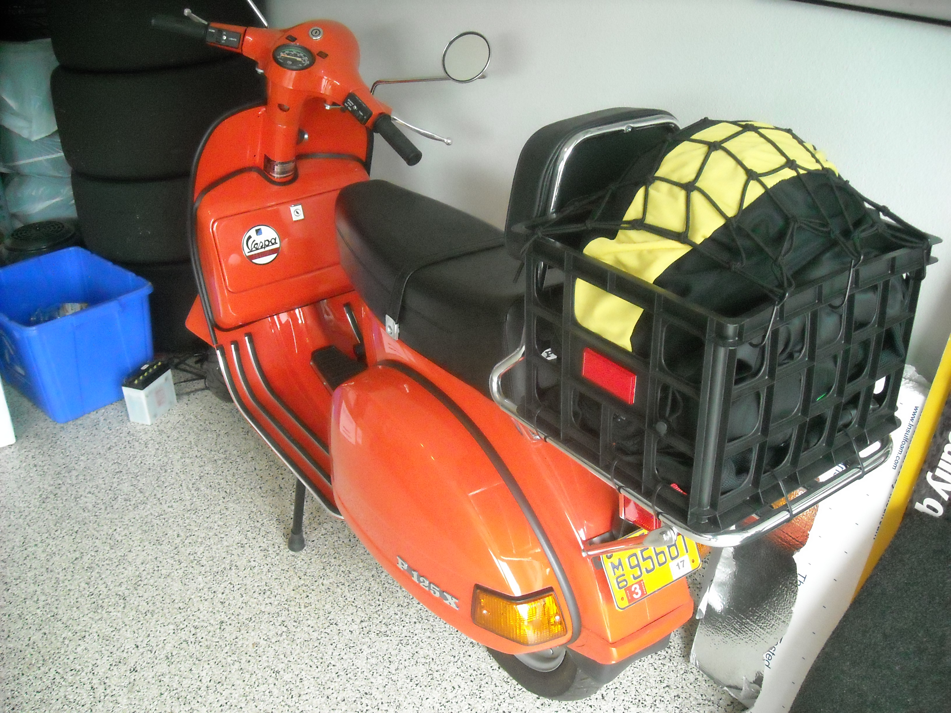

I guess I'm the only reader who noticed the Vespa against the wall in picture #1. 150, GS...?
I like the 356 instrument idea. Aren't they a bit smaller than the OEM for the 914?
It's actually a P125X (1982) that I restored a couple of years ago. Upgraded the engine to a 165cc with a 1969 Camaro color (Hugger Orange) and everything works. Yeah it needs some air in the back tire.
Fun ride but scary above 45mph with those really small wheels (10"). I've actually got a 1962 VNB to restore as well with 8" wheels....wow.
