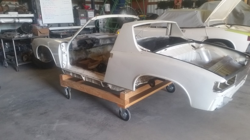

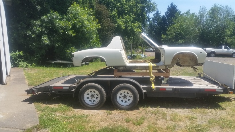

raynekat   So Cary picked up my chassis this past week, and h...   Jun 10 2016, 11:04 PM
raynekat   RE: Just arrived in the garage: 1971 914-4 1.7   Jun 10 2016, 11:05 PM

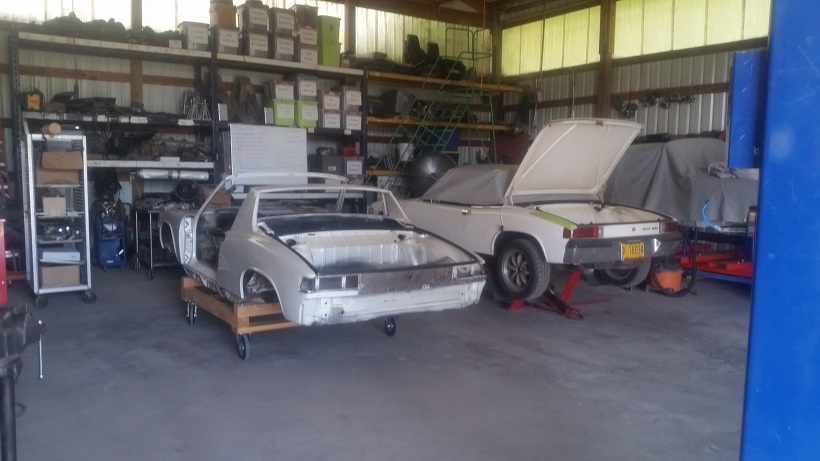

cary   The day has finally come to start on Doug's ca...   Jul 6 2016, 11:26 PM
cary   Plan is to work on Doug's car thru the end of ...   Jul 6 2016, 11:33 PM
