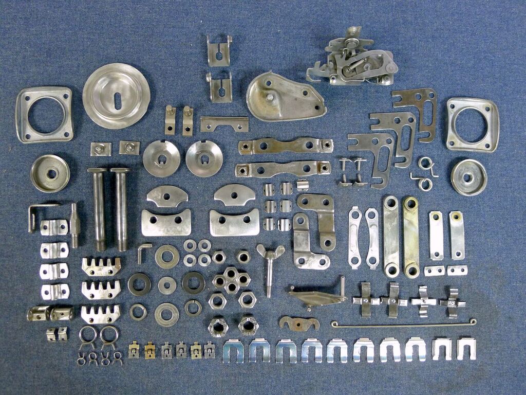

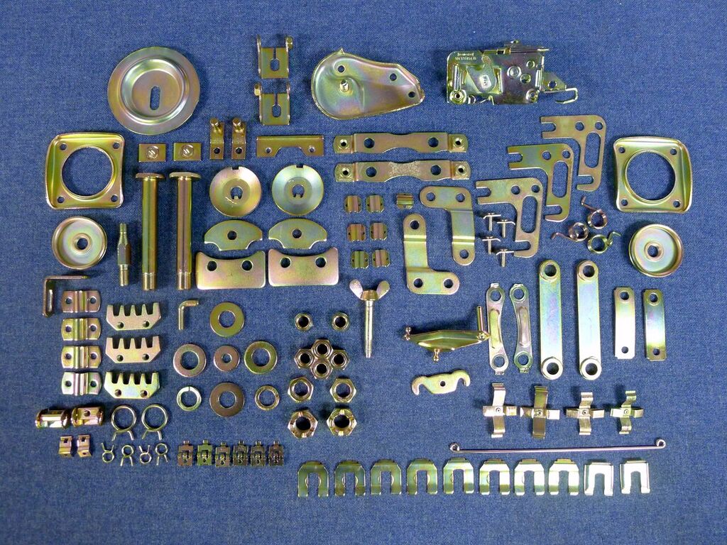

Had some of the hardware replated by Shaun of Tru6 from the Early 911 S Registry.
Artful work he does if that's what you want....and I did.
Before:
After:
I've got another big batch going to his soon.
He does both the yellow and clear zinc coating.
Perfection for sure...
