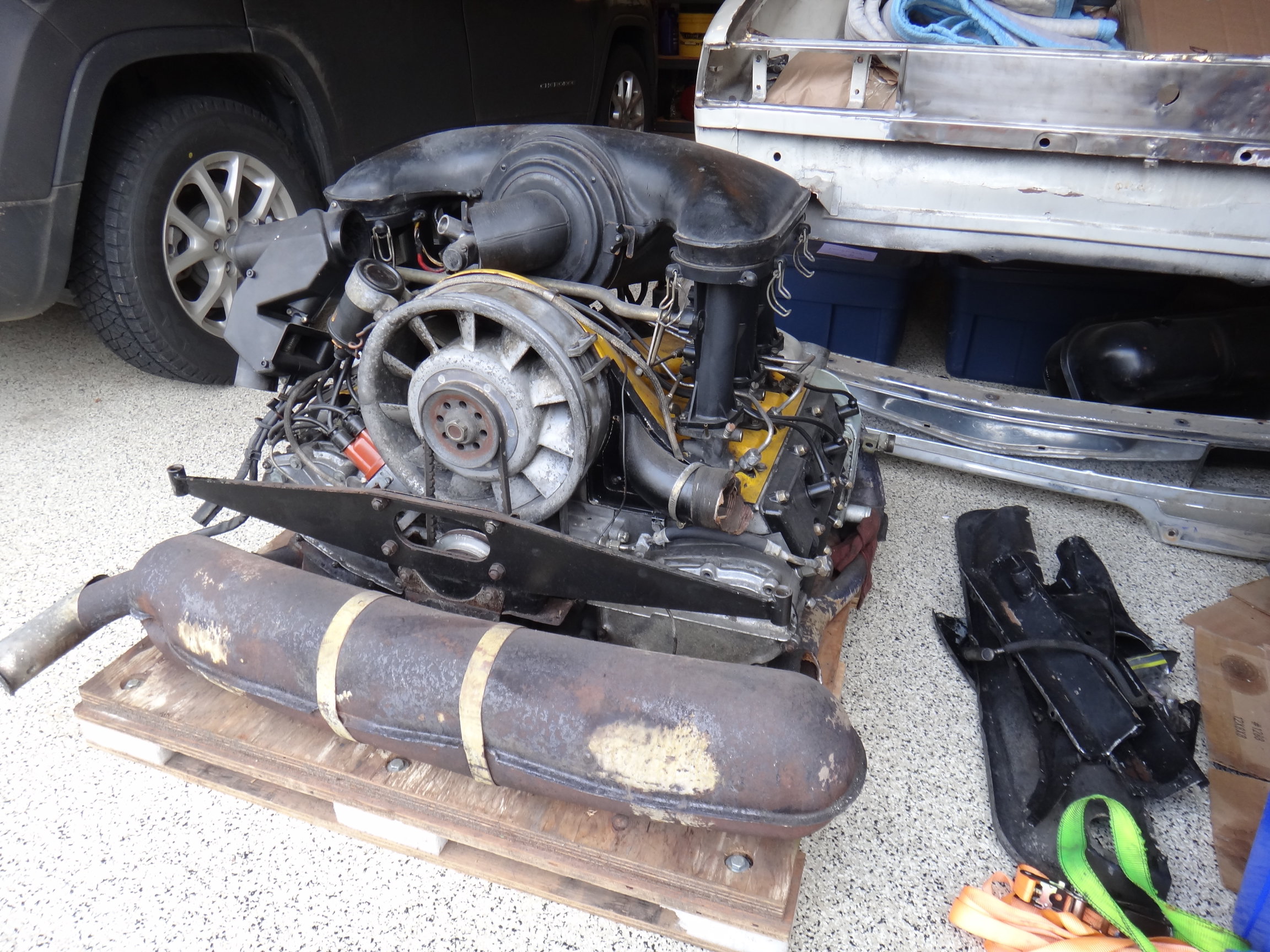

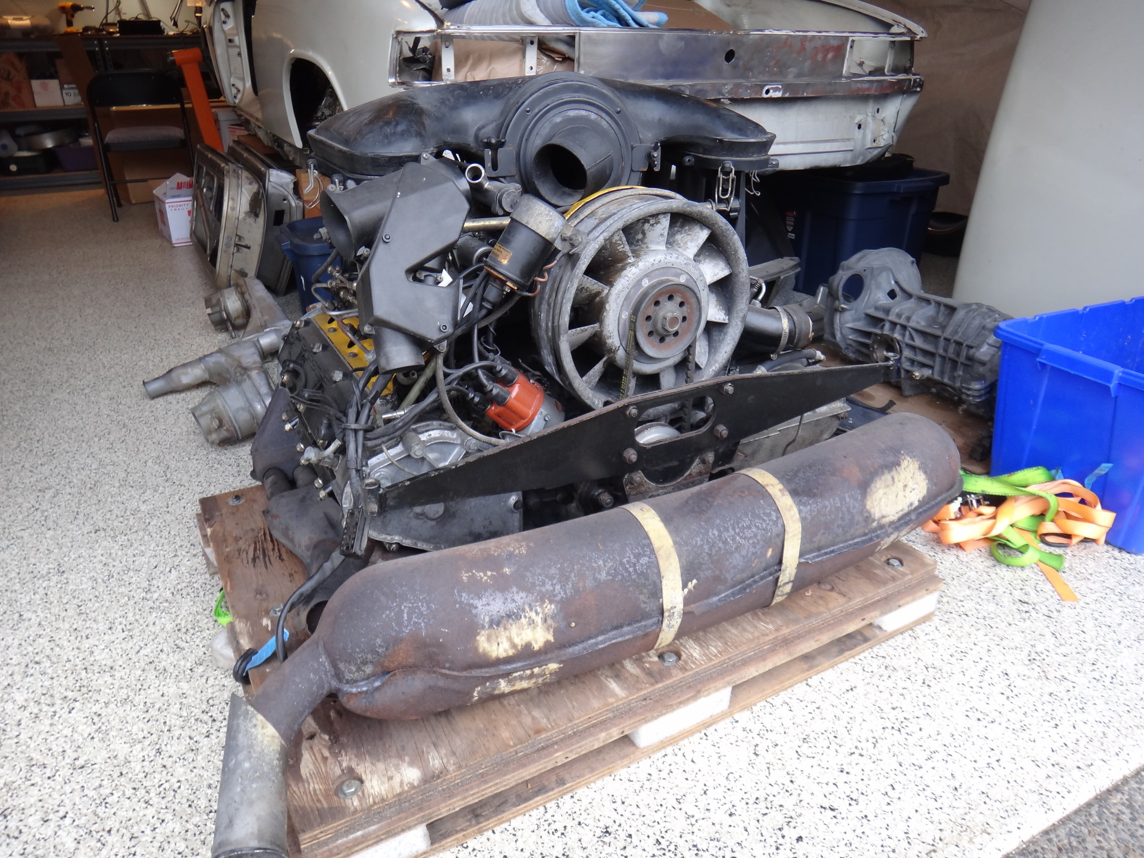

I sourced a 2.4 T MFI motor from Australia of all places.
The engine originally came from the US.
Supposedly low miles....yada yada.
Not so sure about that, but it had the 7R case and all the MFI components.
So I was in.
Real adventure shipping it from Australia to the US.
Took about 6 months by boat, tough to get all the paperwork done, customs, EPA, you name it.
A royal PITA...but it finally arrived by plane from LA into Portland.
