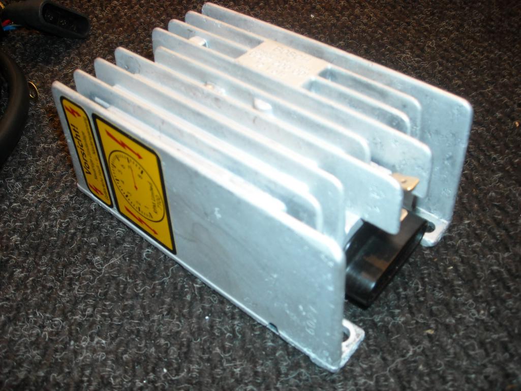

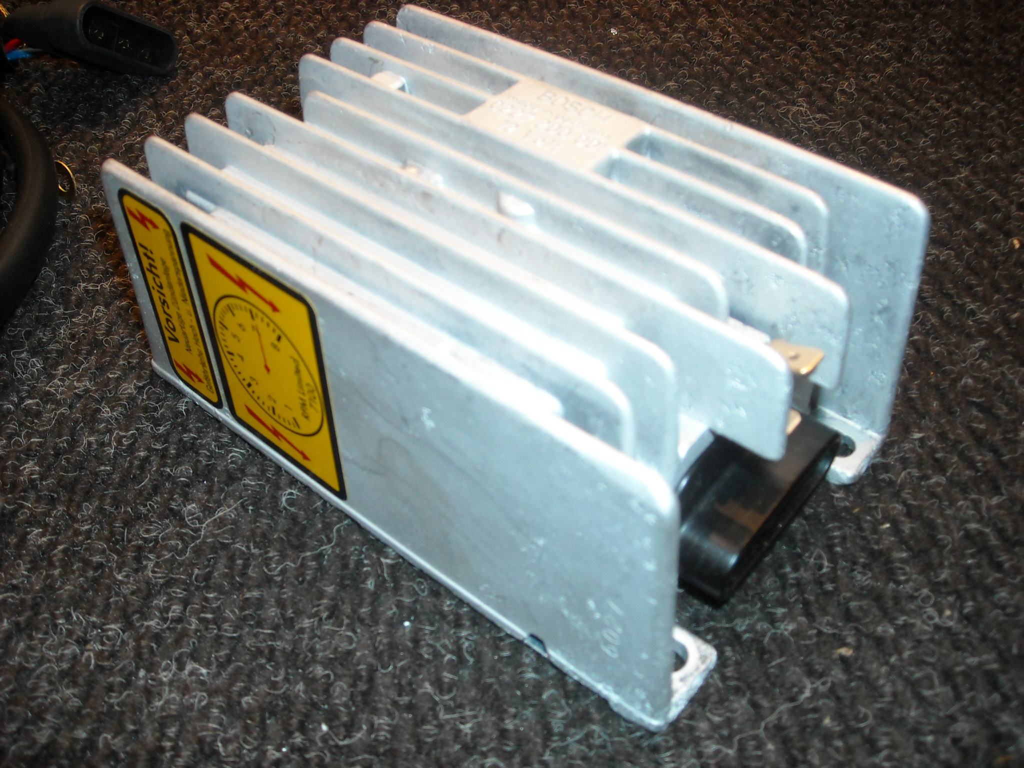

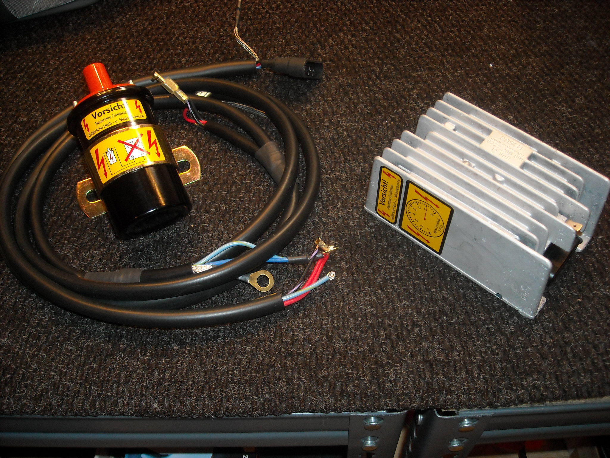

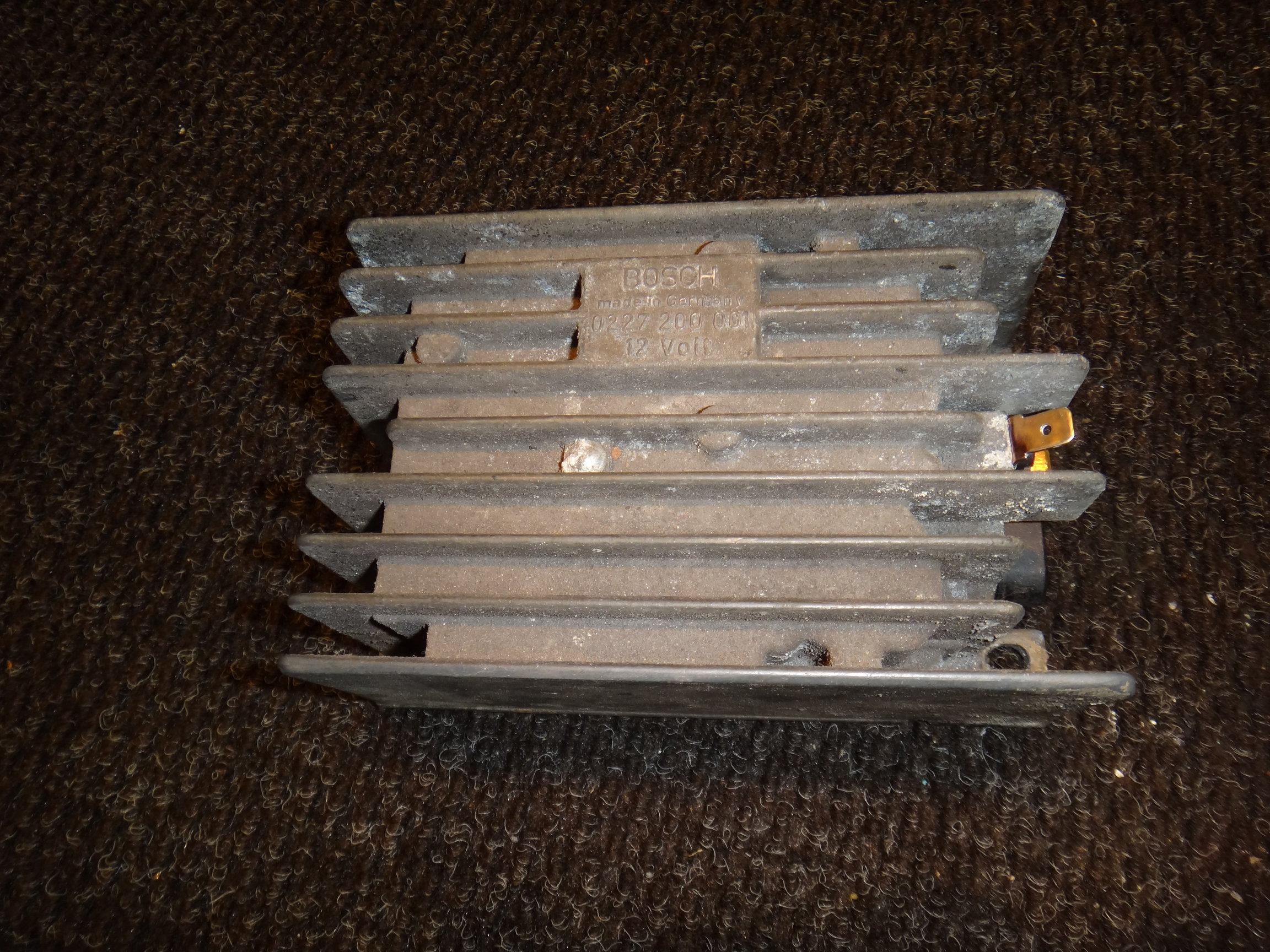

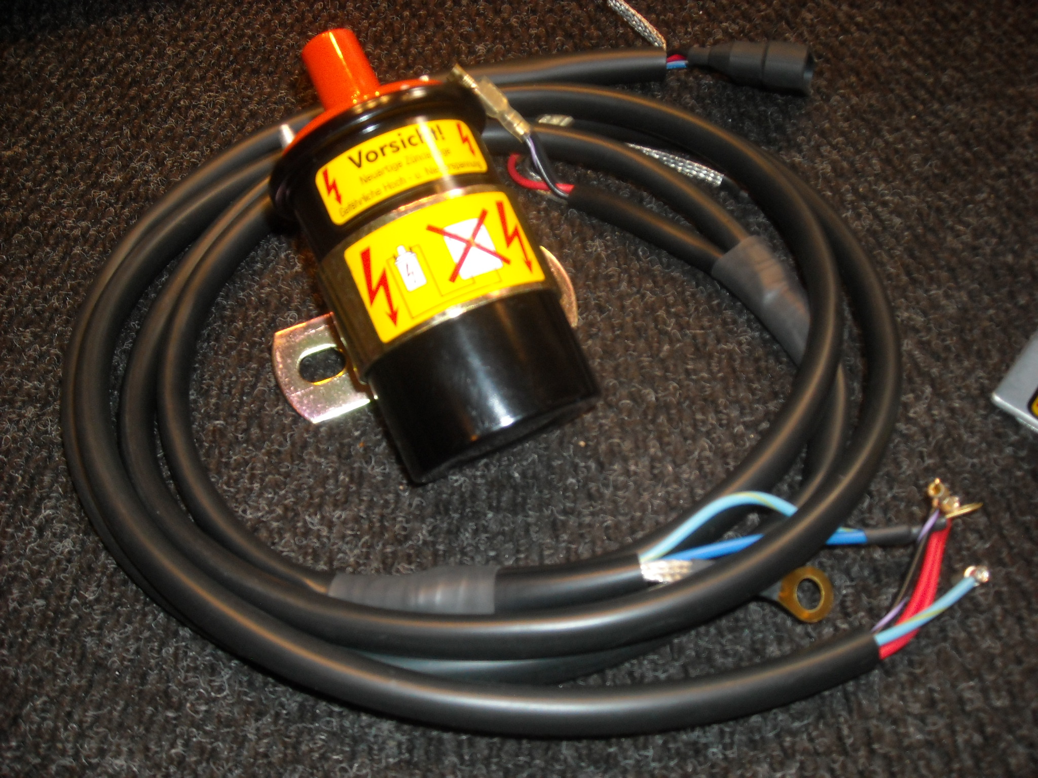

MFI requires a CDI unit, so I sourced a used one that was unknown condition.
Out to Parts Klassic it went.
All the ancient electronics were removed and replaced by modern solid state electronics.
Bought their matching coil and wiring harness made for Pertronix ignition.
The hope is for better reliability and performance/starting manners.
Before:
After:
