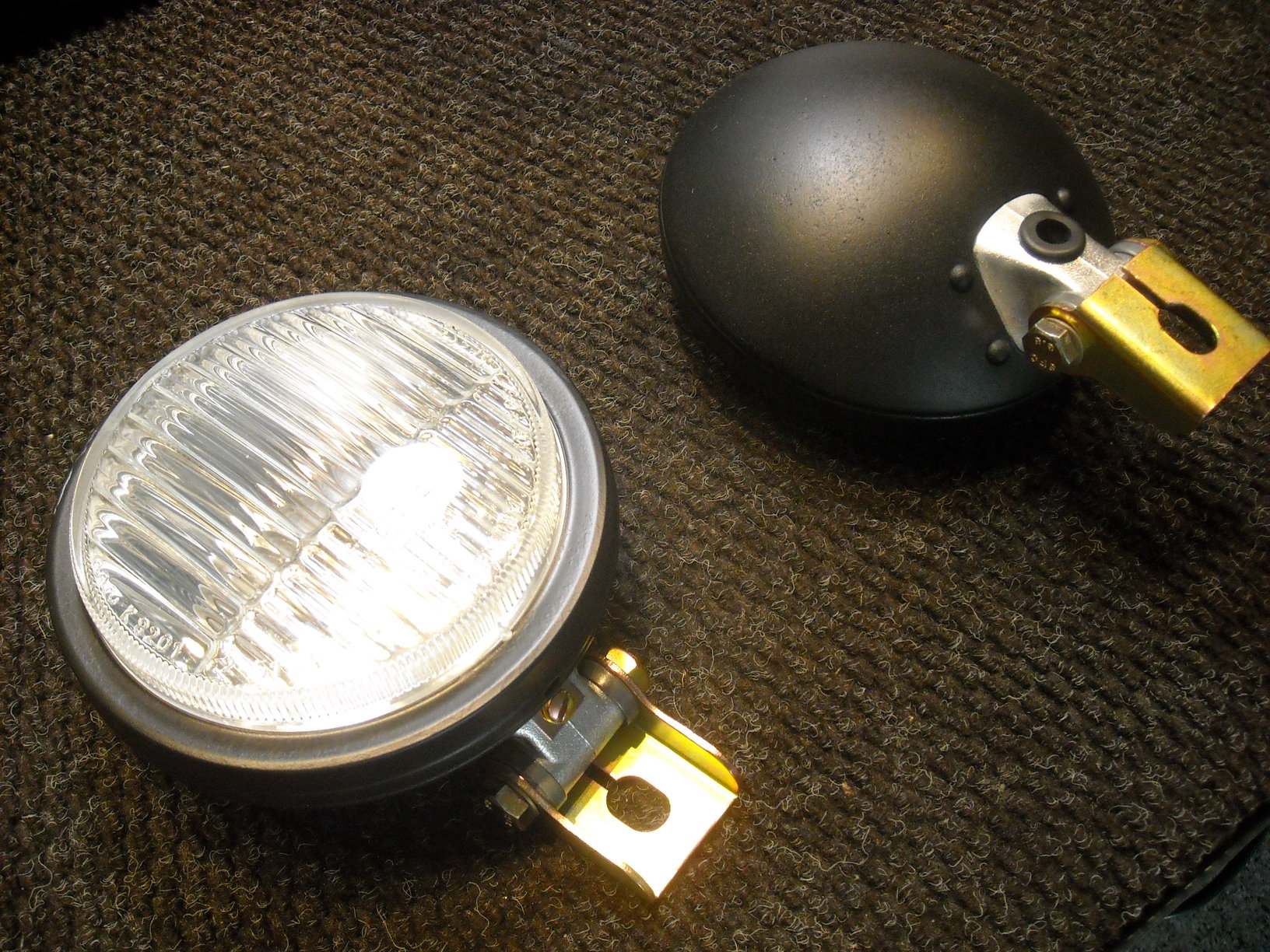

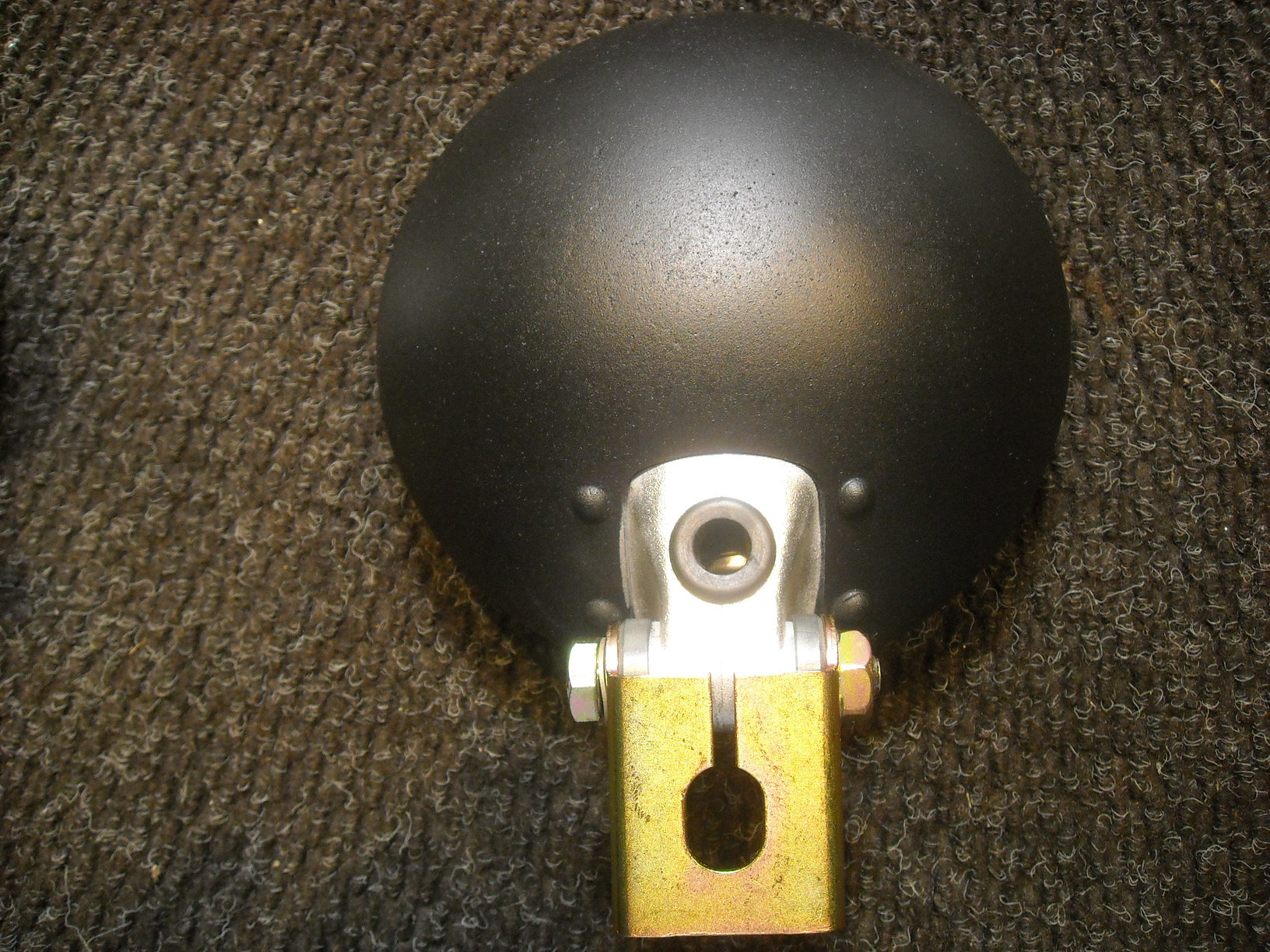

NOS lens and reflectors off of Ebay Germany with some fresh paint and replating of hardware made the driving lights looks much better.

raynekat   NOS lens and reflectors off of Ebay Germany with s...   Jun 10 2016, 11:49 PM
