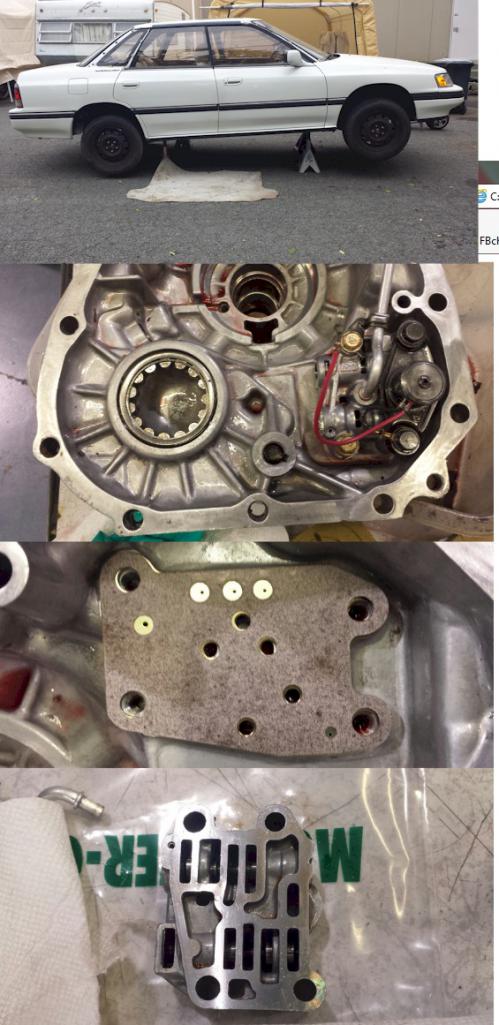

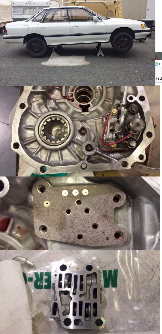

jimkelly   think i found my parts car, a lowly ej22 in need o...   Mar 31 2016, 02:18 PM
matthepcat   ^^That motor has a factory forged crank ^^ You ca...   Mar 31 2016, 02:47 PM
jimkelly   one step closer... with a 1990 subaru legacy awd.....   Mar 31 2016, 08:26 PM
76-914   one step closer... BUT NOT TO TURBO :D time to...   Apr 1 2016, 08:41 AM
jimkelly   i'm concerned. i knew the engine has some iss...   Apr 1 2016, 01:10 PM
zipedadoo   What year is the subaru? I used a 1996 ej22. I fou...   Apr 1 2016, 01:54 PM
jimkelly   1990 subaru legacy awd.. must have been sitting fo...   Apr 1 2016, 02:29 PM
Chris H.   No the car in that clip is a 4 cylinder turbo car....   Apr 1 2016, 10:21 PM
