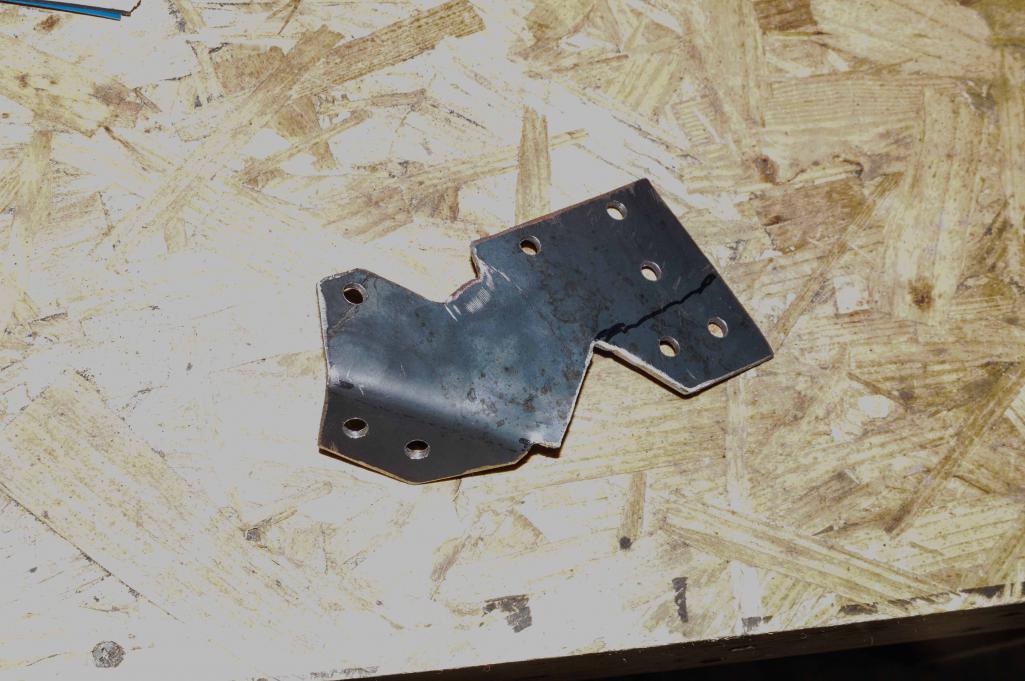

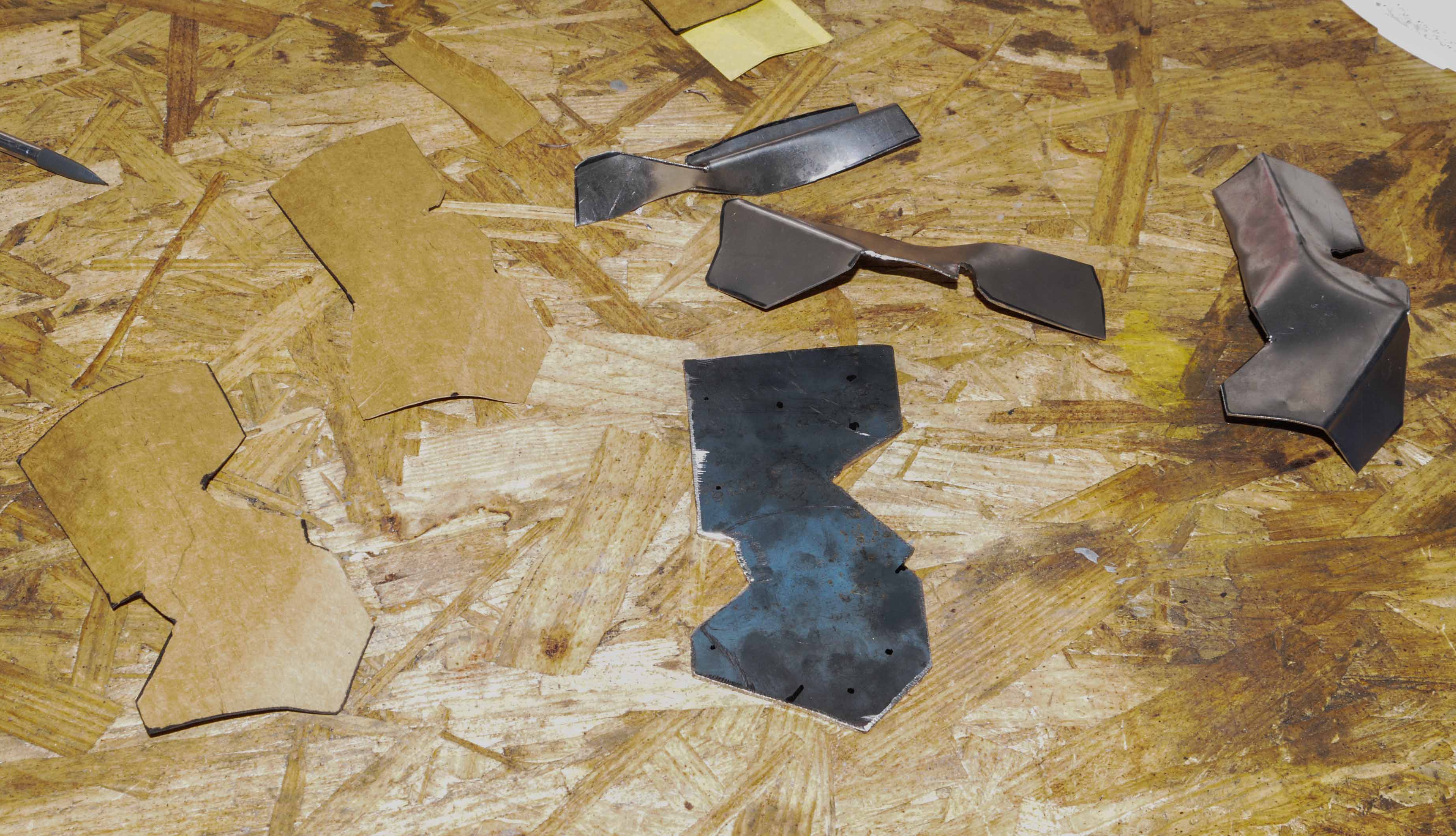

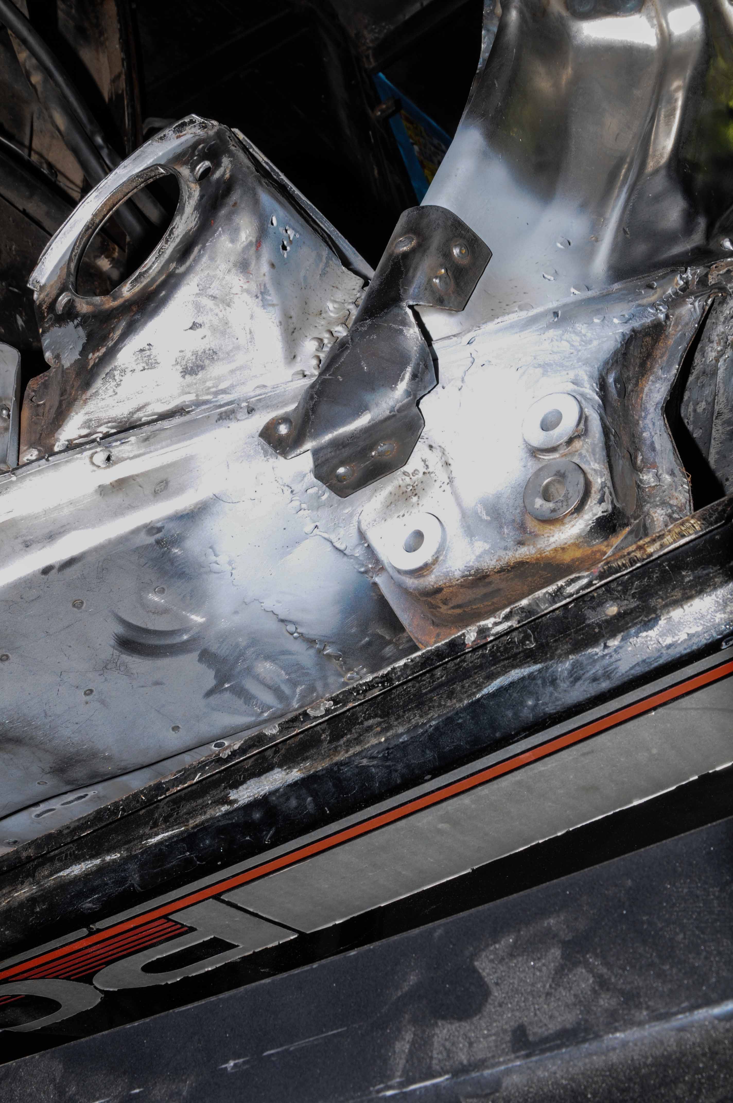

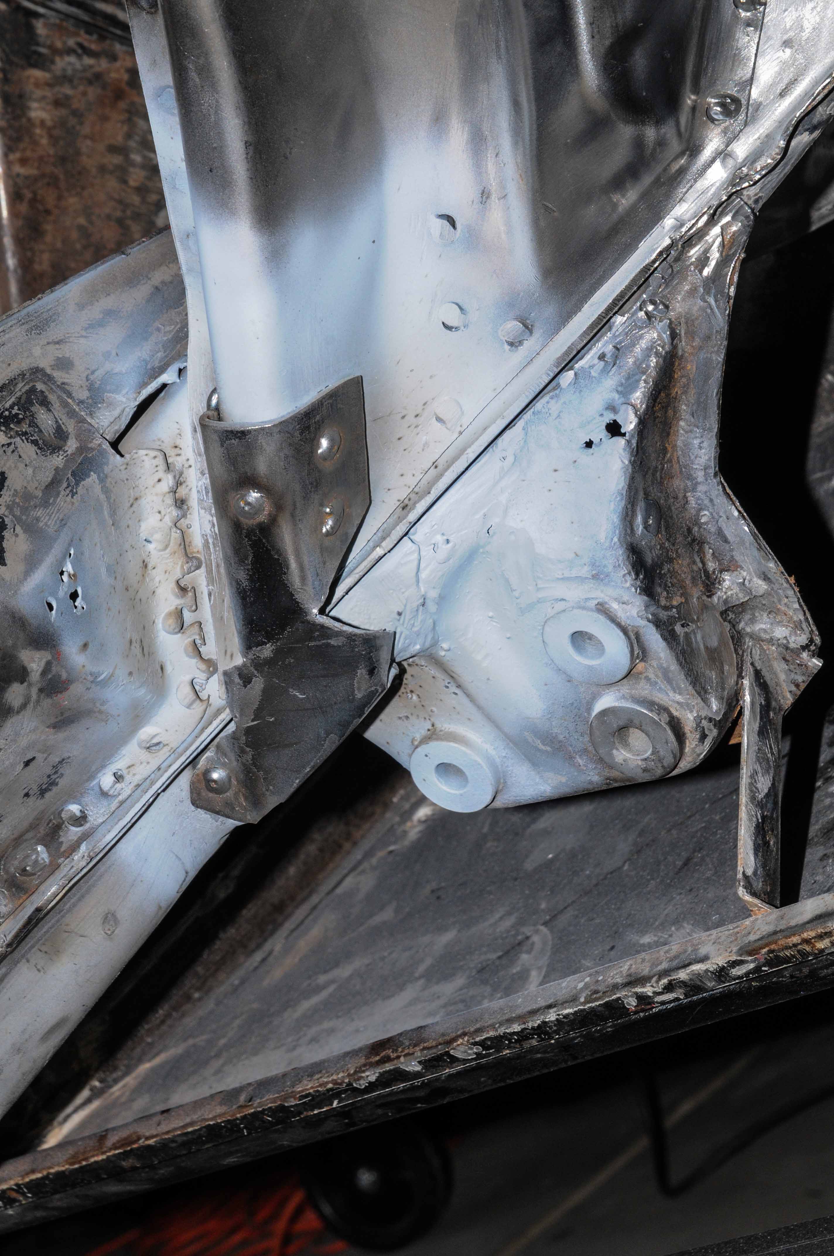

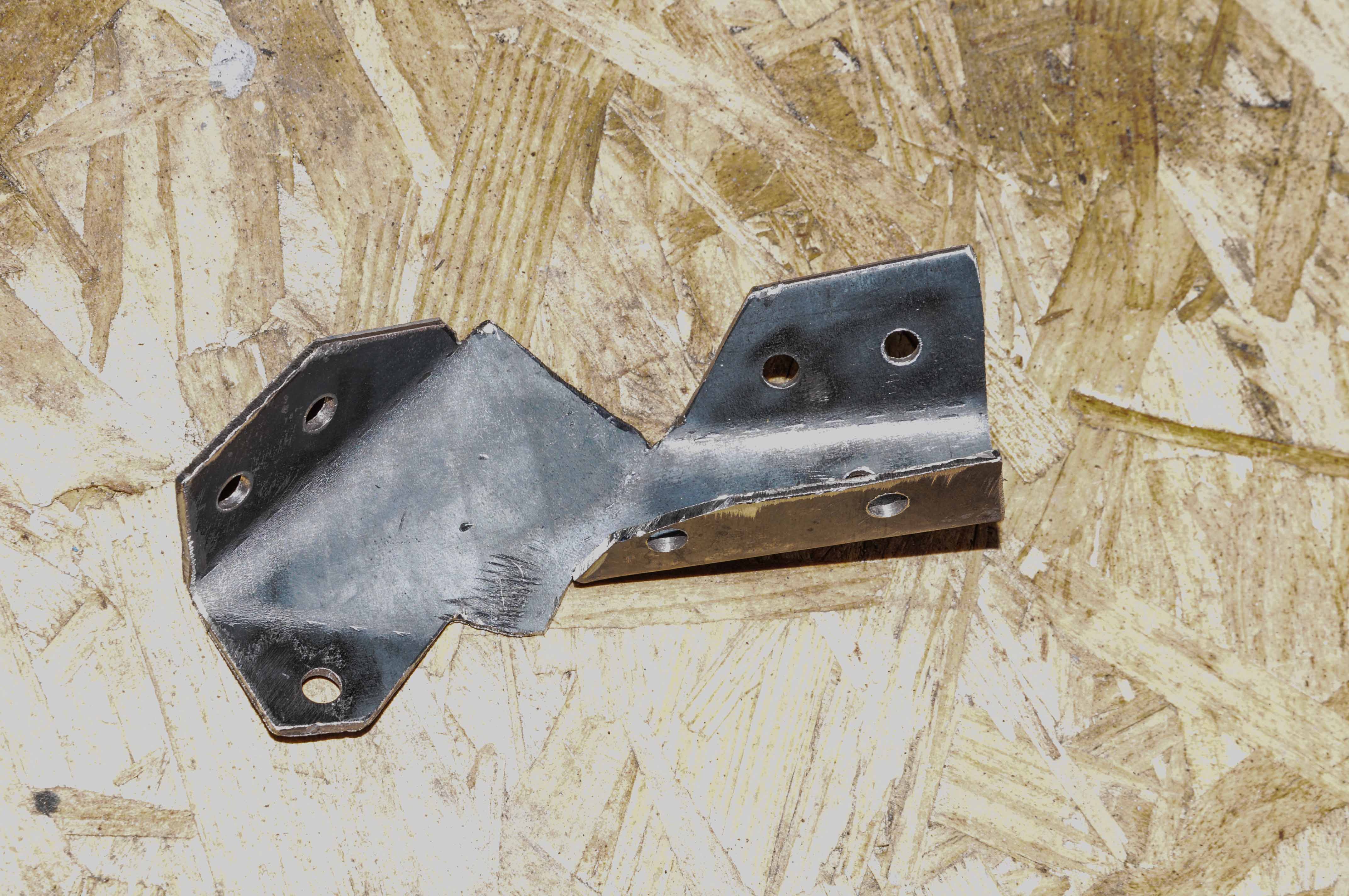

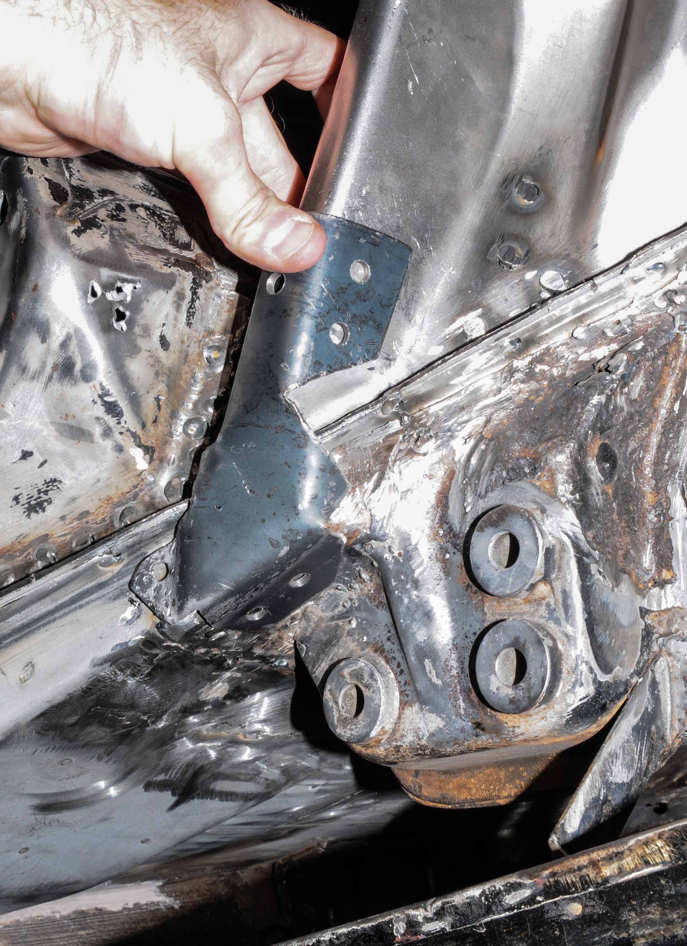

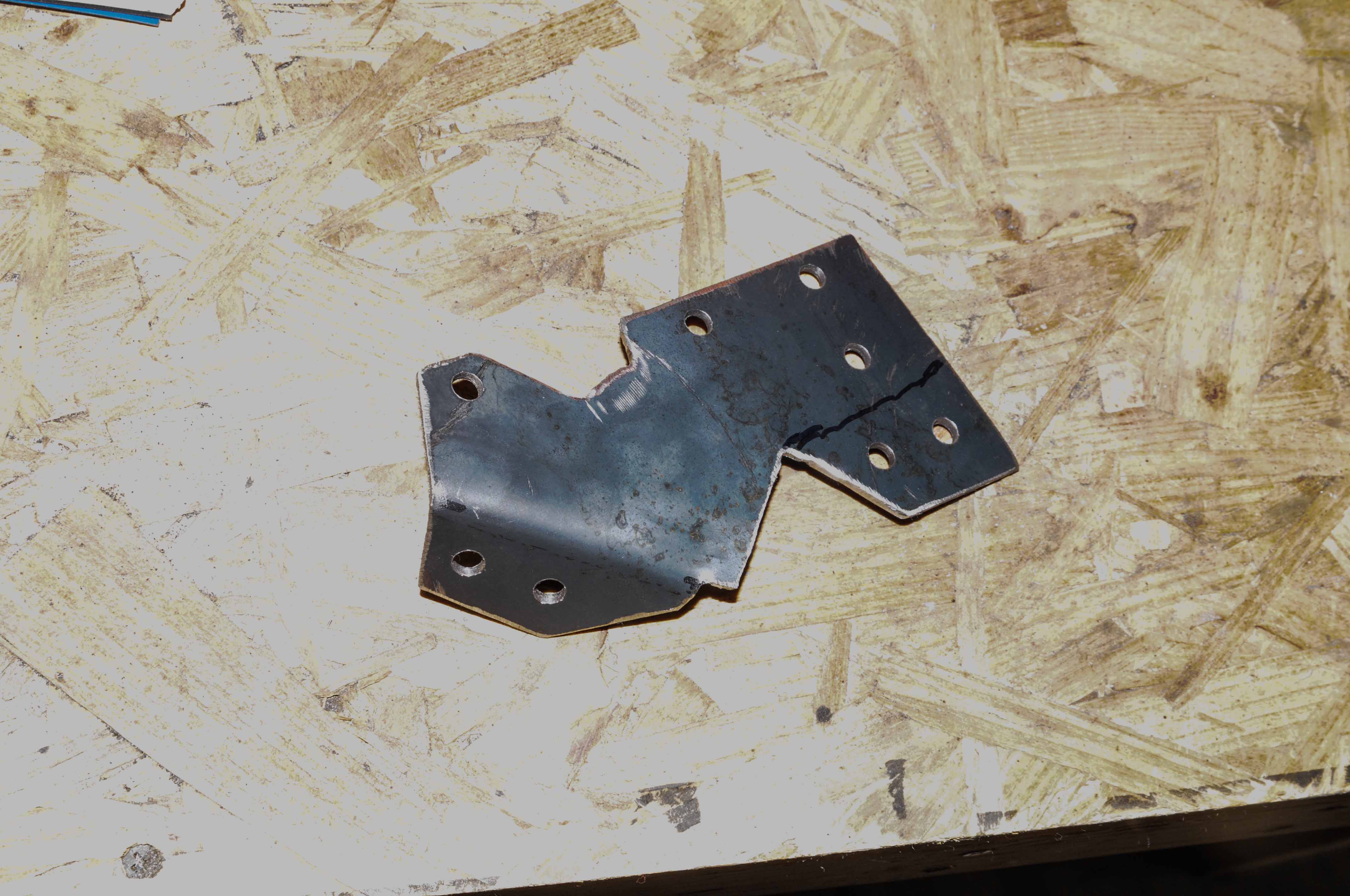

Took last weekend off because it was over 100 degrees in my garage and I was avoiding the task of making the suspension ties. But this weekend I got right down to it. I was really dreading this and was super worried about trying to get the little one done in one piece with 12 gauge steel. I bought a scrap sheet from a local fabrication place for $5 and had about 5x what I needed. My method was to make cardboard models and then cut the metal from it. I also made some test and experimental pieces from 20 gauge to test the feasibility of the project. I elected to drill the holes while the piece was flat because it made it easier in the drill press. A bigass hammer and a vice were the primary tools, and I used a blowtorch to heat up areas that were tougher to bend. On bend at a time, and a lot of test fits and I got it. All of the minor bends, twists and whatnot made the process crazy, but it really wasn't as bad as I thought it would be. My one regret is that I should have made it a little bit longer towards the inside, but that may have just made it impossible...who knows.
Attached Image Attached Image Attached Image Attached Image Attached Image Attached Image
