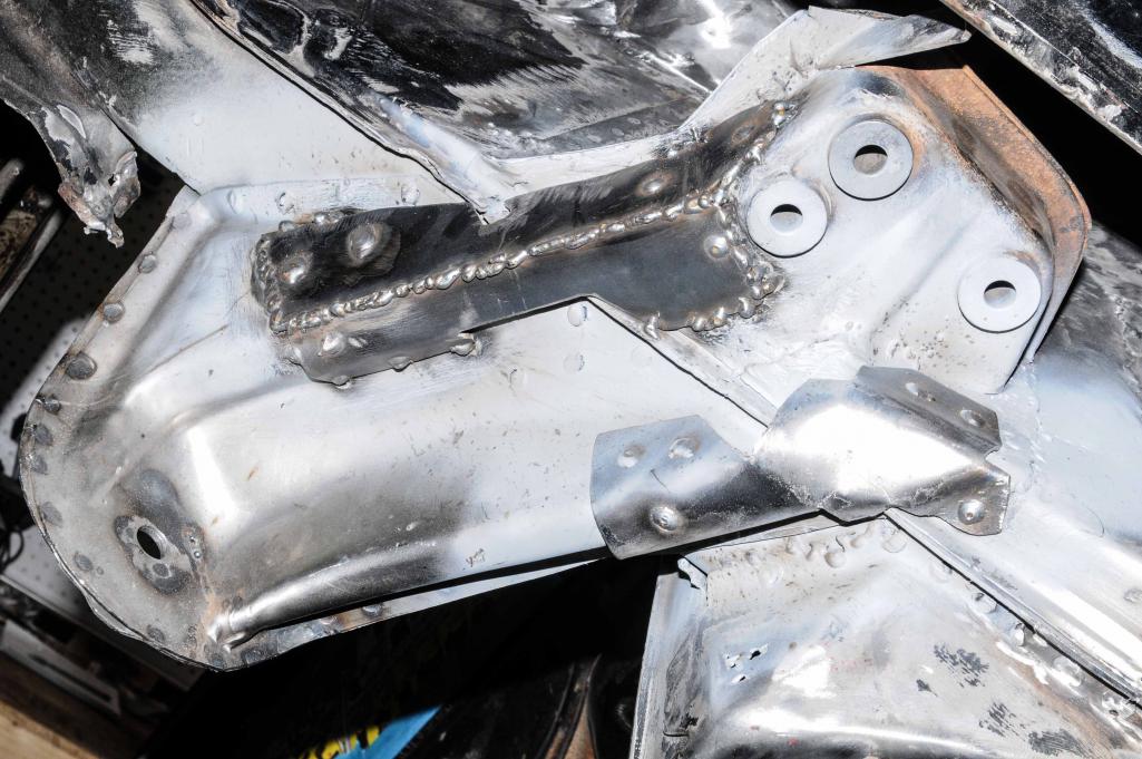

JoeDees
post Jun 12 2016, 09:27 PM
Posts: 515
Joined: 10-November 14
From: Northern Kentucky
Member No.: 18,106
For the second tie, I used the method from the above link. It was far easier to make, but somehow harder to weld. I guess because I designed the little one to be primarily plug welded. I still need to grind them all pretty like.

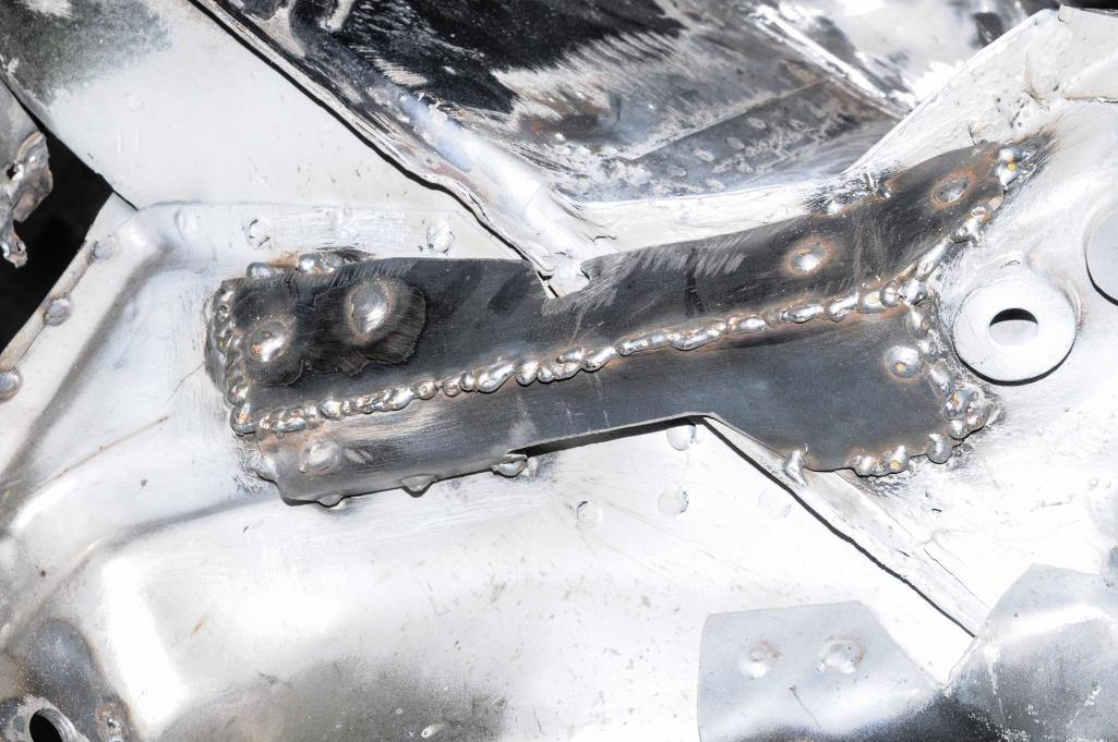

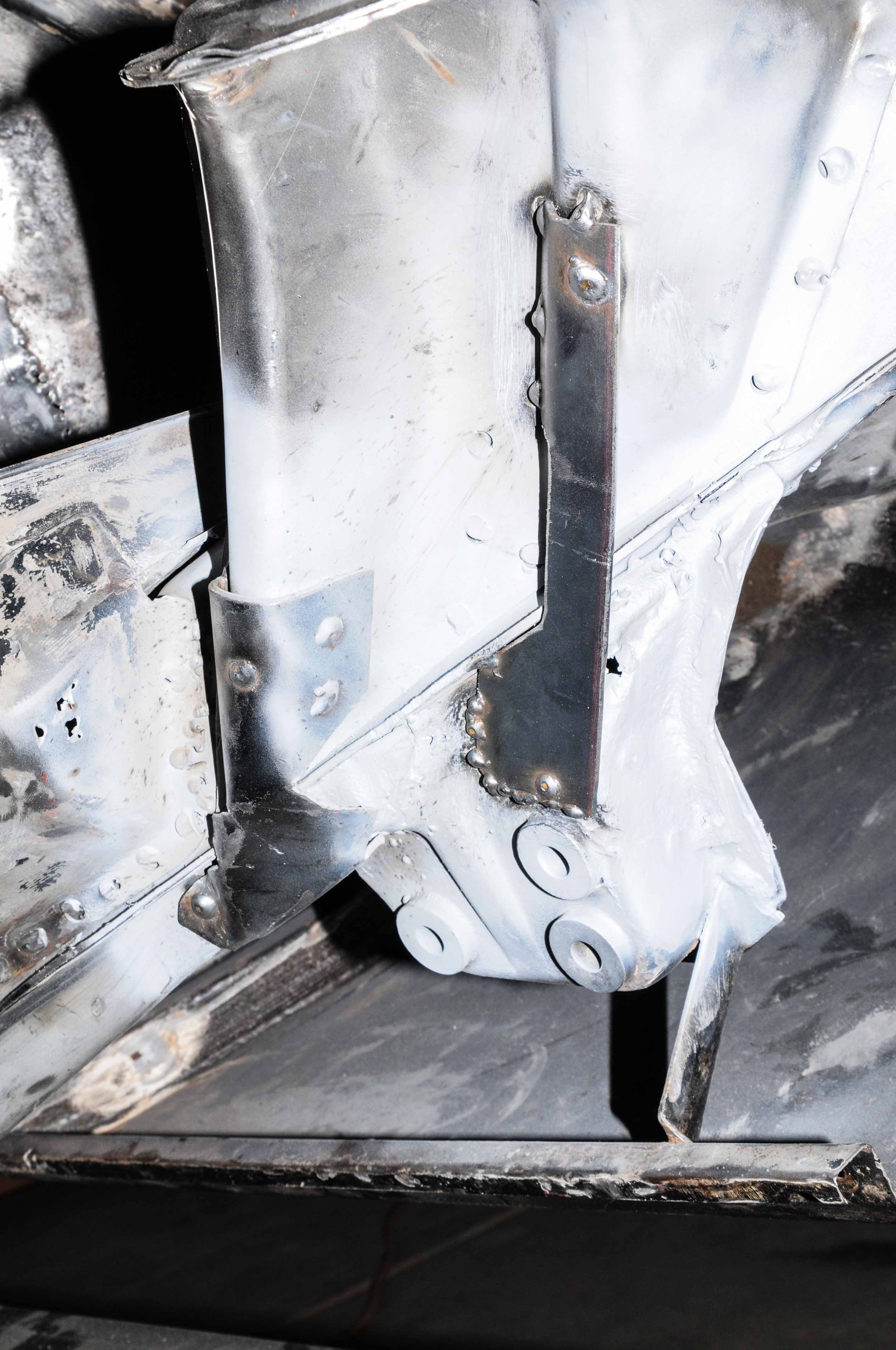

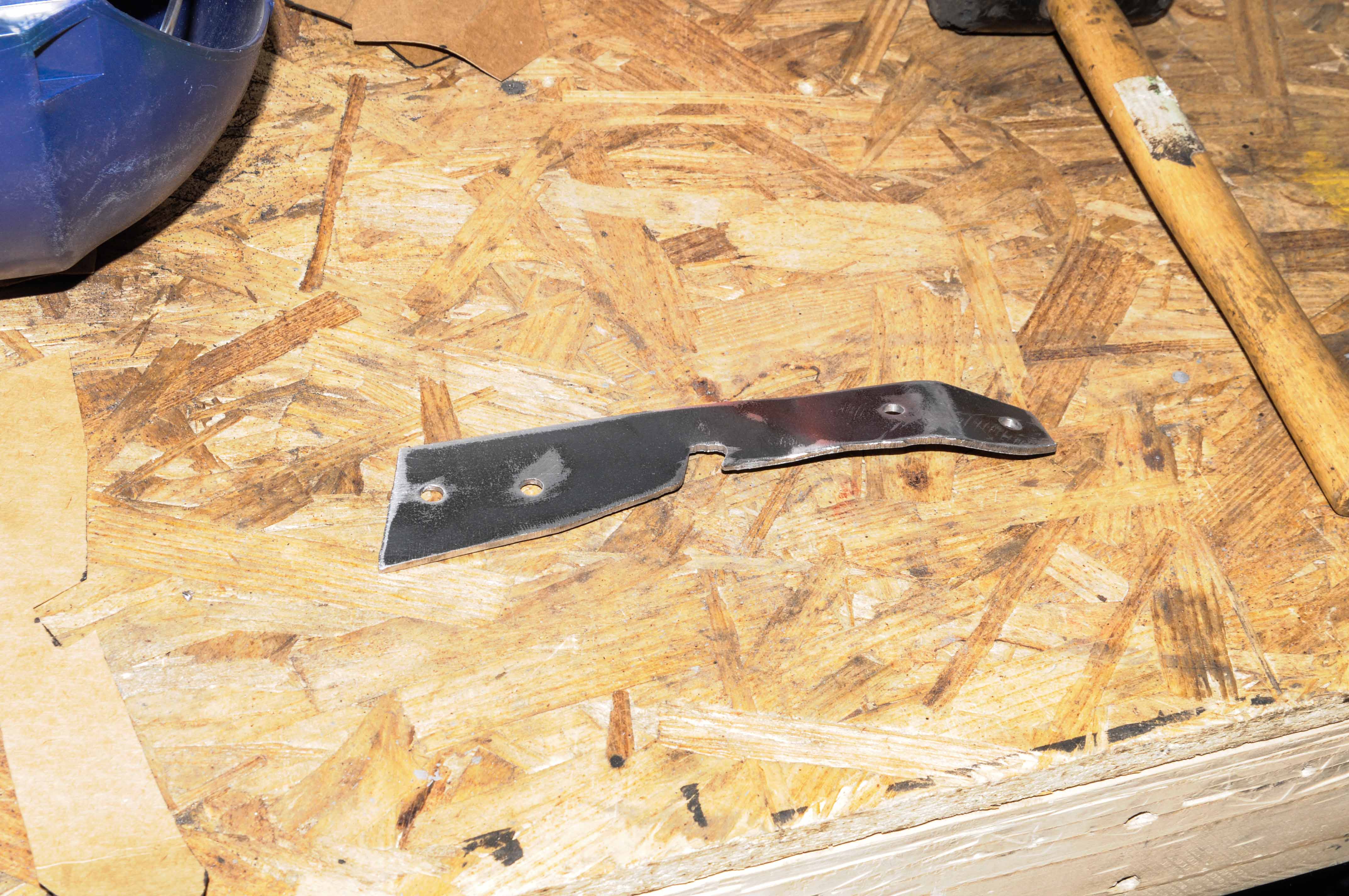

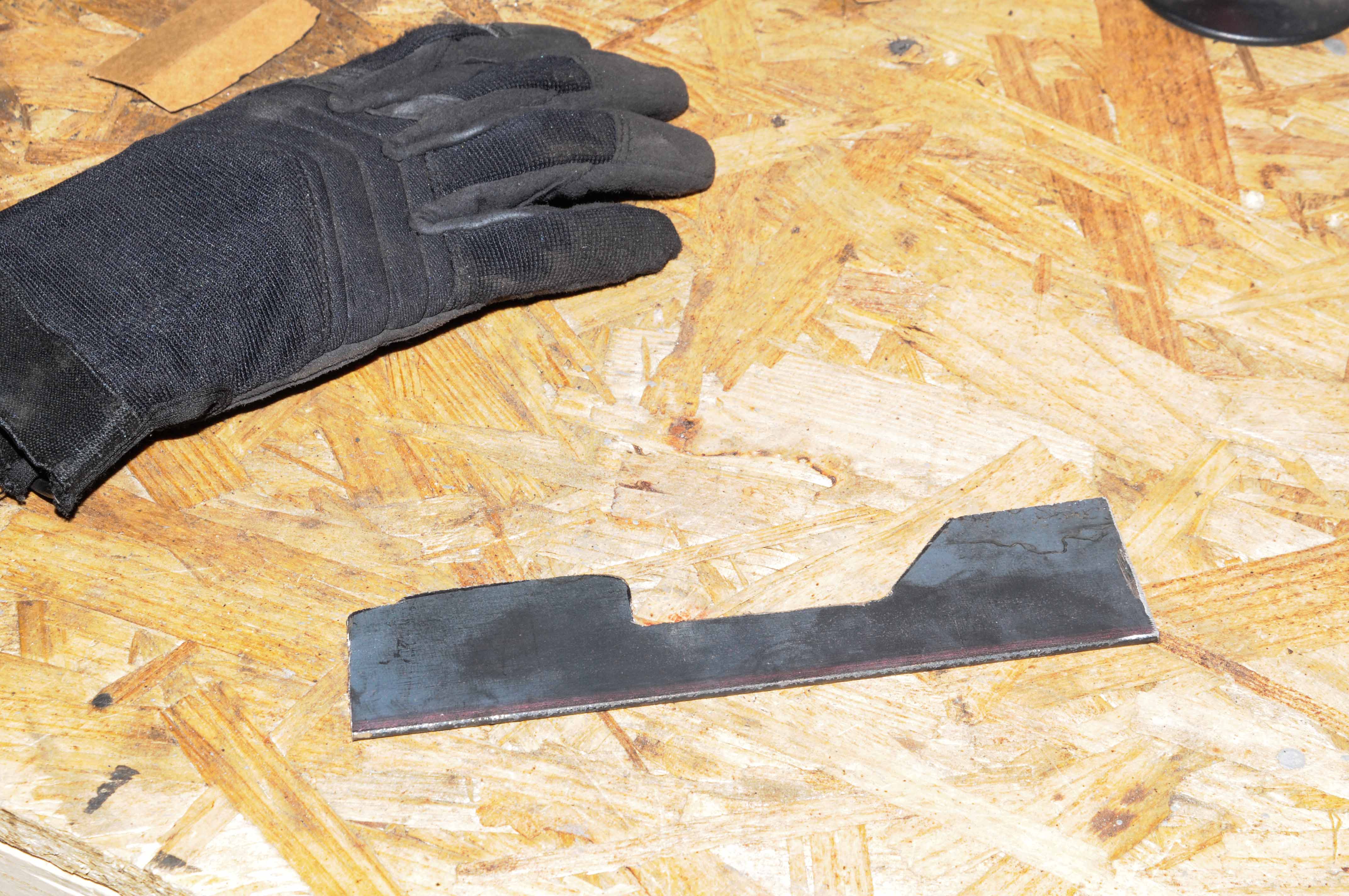

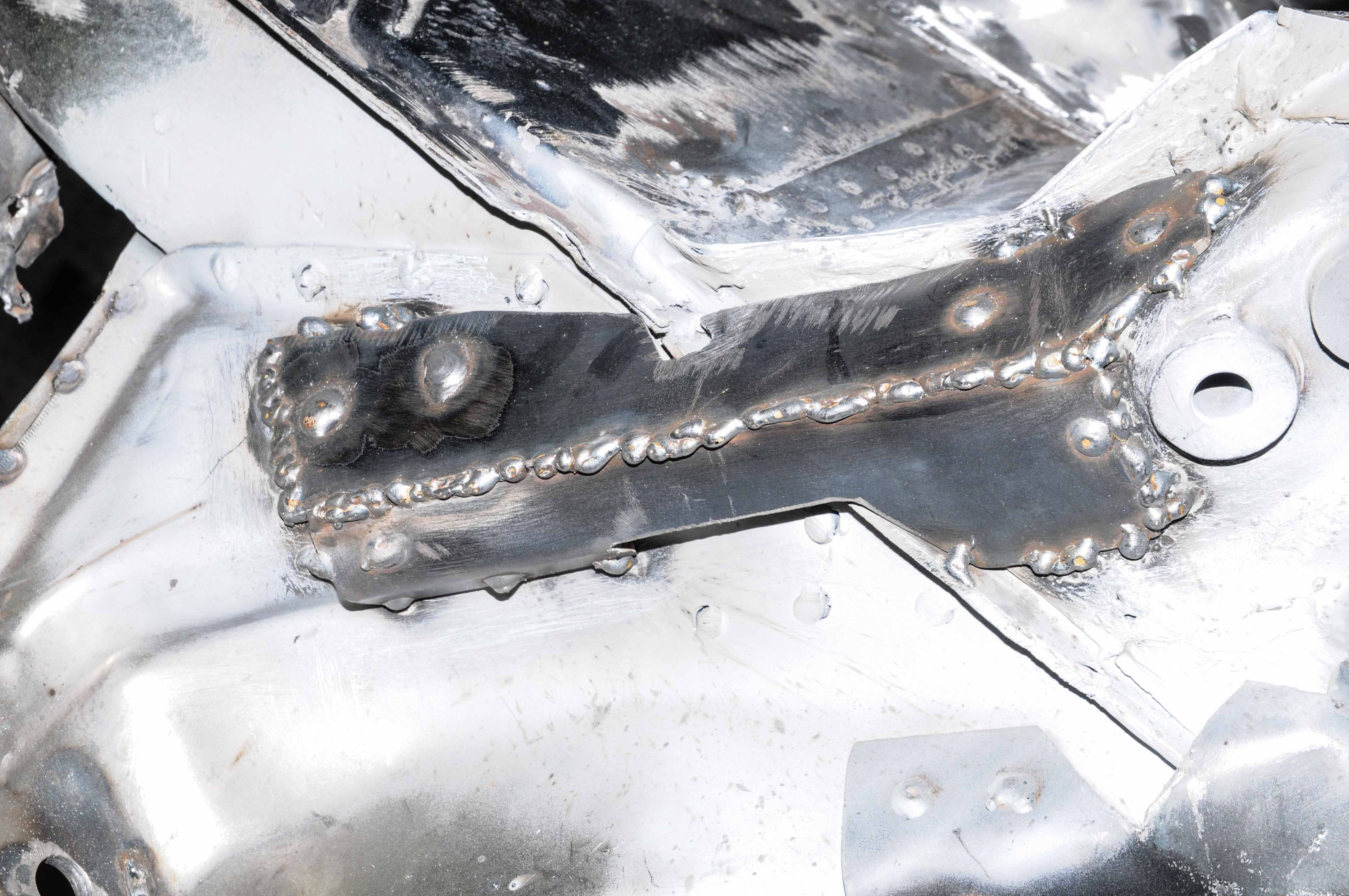

DirtyCossack   Shop soundtrack: Euro 2016 matches and then Harry ...   Jun 12 2016, 09:19 PM

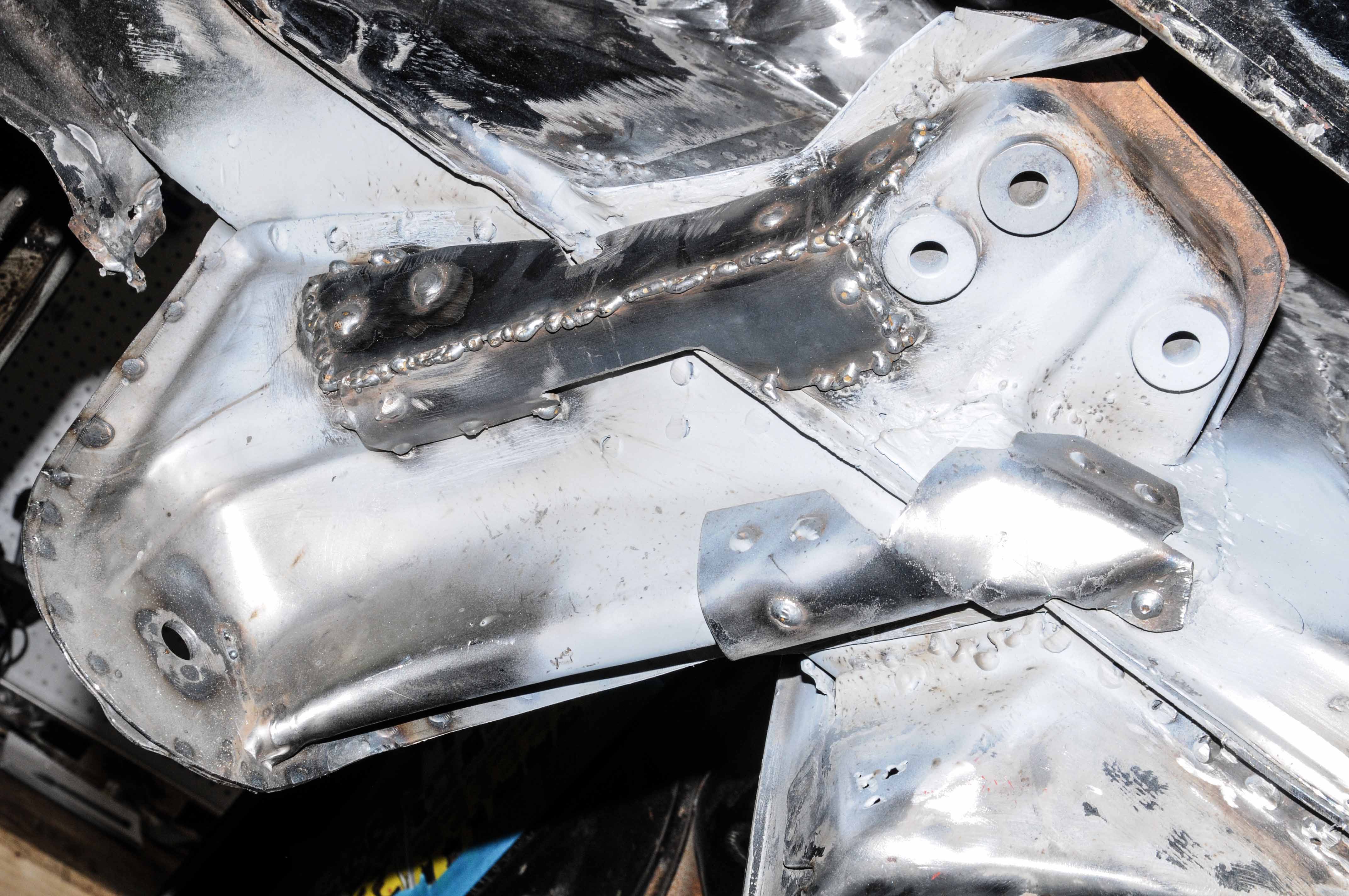

DirtyCossack   For the second tie, I used the method from the abo...   Jun 12 2016, 09:27 PM
DirtyCossack   On 2 other notes: Those are some ugly ass welds.....   Jun 12 2016, 09:29 PM
