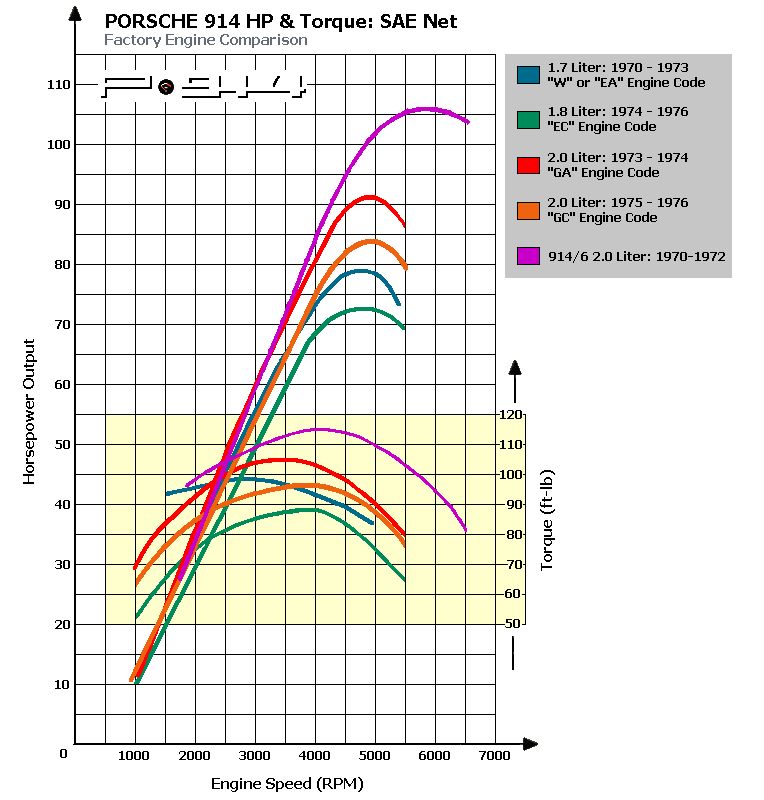

Here is a summary of the factory specs:

Jeff Bowlsby   This information is worth far more than the 4 pa...   Jun 13 2016, 09:07 AM
DBCooper   Interpret this data as you will, it shows the pro...   Jun 13 2016, 10:58 AM
stugray   This information is worth far more than the 4 pa...   Jun 13 2016, 11:12 AM
SirAndy   My latest task was to see what happens when you fi...   Jun 13 2016, 11:57 AM

Jeff Bowlsby   Here is a summary of the factory specs:   Jun 13 2016, 09:27 AM
Darren C   Very Nice info Jeff, but it doesn't show AFR w...   Jun 13 2016, 09:31 AM

jd74914   FWIW: Using the factory measurements from 30 years...   Jun 13 2016, 05:11 PM
Darren C   To me it's quite impressive that Darren...   Jun 13 2016, 05:21 PM
