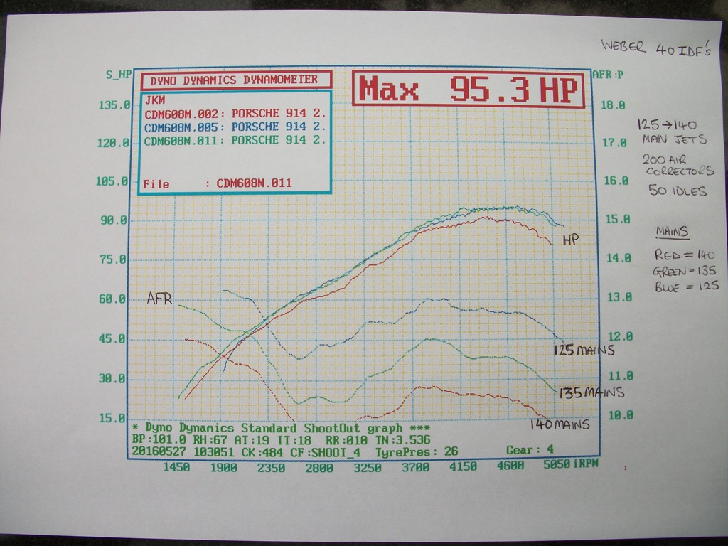

Sitting on the fence watching this thread unfold, it just seems to be another differing opinion of ego’s with little or no hard facts displayed in this thread (albeit the facts are numerous and available elsewhere on 914 world).
It’s unfortunately this type of thread that clogs up the ease at which I’ve been able to seek out useful and meaning information on this site. The net result is that I simply go and find out for myself rather than trying to wade through all the opinionated drivel.
My latest task was to see what happens when you fit carbs to a 2.0L FI stock engine. The only way I know how to get hard facts (rather than opinion) was to go do it, and get the car on a Dyno. I spent a whole day on the dyno, did 12 runs with various jet settings (increasing in steps of 5) and graphed Air Fuel ratio, torque and Horsepower through the rev ranges.
For clarity the 12 graph overlays have been thinned out to 3 runs showing a fuel band where best driveability v jet range was found.
Interpret this data as you will, it shows the pros and cons of fitting carbs over the whole rev ranges.
It’s not heated opinion its hard fact.
(IMG:http://www.914world.com/bbs2/uploads_offsite/i265.photobucket.com-18255-1465825340.1.jpg)
This information is worth far more than the 4 pages that proceed my post.

Darren C   Sitting on the fence watching this thread unfold, ...   Jun 13 2016, 07:42 AM
OU812   Sitting on the fence watching this thread unfold,...   Jun 13 2016, 08:12 AM
Jeff Bowlsby   This information is worth far more than the 4 pa...   Jun 13 2016, 09:07 AM
DBCooper   Interpret this data as you will, it shows the pro...   Jun 13 2016, 10:58 AM
stugray   This information is worth far more than the 4 pa...   Jun 13 2016, 11:12 AM
SirAndy   My latest task was to see what happens when you fi...   Jun 13 2016, 11:57 AM

Darren C   Thanks Jeff. Now I throw out the challenge to som...   Jun 13 2016, 09:20 AM
John Jentz   Thanks Jeff. Now I throw out the challenge to so...   Jun 13 2016, 09:30 AM
ConeDodger   Thanks Jeff. Now I throw out the challenge to so...   Jun 13 2016, 10:29 AM
somd914   Thanks Jeff. Now I throw out the challenge to so...   Jun 13 2016, 04:37 PM
Jeff Bowlsby   Here is a summary of the factory specs:   Jun 13 2016, 09:27 AM
Darren C   Very Nice info Jeff, but it doesn't show AFR w...   Jun 13 2016, 09:31 AM
