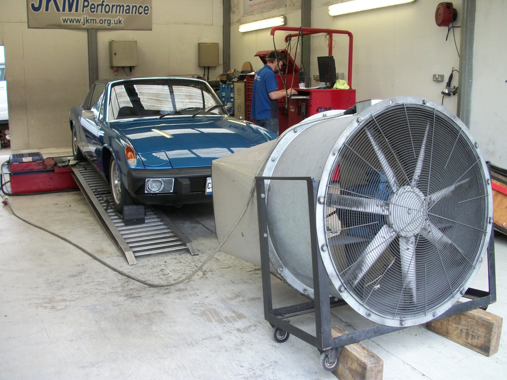

FWIW: Using the factory measurements from 30 years ago (taken on who knows what equipment and averaged over a number of engines) and comparing to new measurements is really irrelevant. Heck, dynoing your car on one dyno then driving down the street to use another isn't even a good comparison. The only relevant comparison is against a single dyno because no two share the same calibration, etc. The only thing you are really guaranteed is repeat-ability, assuming you are using a quality device. When dynoing a car you really should be looking at the shape of the curve and relative comparisons between changes, not the peak HP/torque number
To me it's quite impressive [and lucky] that Darren's plots are anywhere close in magnitude to the factory numbers. Note that the Dyno Dynamics one that Darren is showing plots from is an extremely well-regarded eddy current device which is very repeatable. It can also hold engine speeds/loads constant to produce really nice curves unlike inertial dynos which are much more common (at least in the USA).
It shouldn't be surprising that you can get better peak numbers on a carbed car than D- or L-jet car when just thinking about fuel mixing. Assuming both allow the exact same amount of fuel at a given time, fuel atomization from the carb will be much better. The Bosch fuel injector nozzle design is archaic compared to modern injectors.

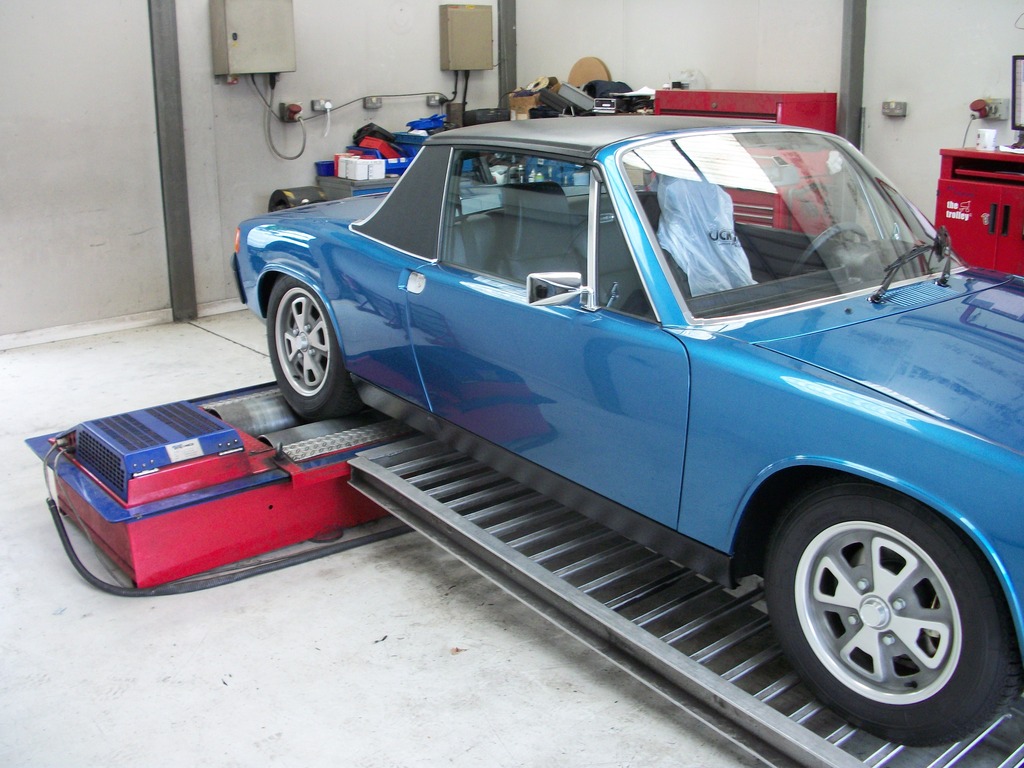

QUOTE(jd74914 @ Jun 14 2016, 12:11 AM) *
Thanks Jim,
That's probably why it's $150 an hour for roller time!
I agree it was extremely lucky considering my car has 119,000 miles (1 owner with full history which shows no engine rebuild in it's life) Also it hadn't run for about 6-7 years before I bought it. All I did was pull the engine to change a couple of leaking oil seals and fit the carbs. All in all I am extremely pleased with this result. I bought it blind late one night off ebay, for a low price based on 6 thumbnail pictures and two bottles of wine.
(IMG:http://www.914world.com/bbs2/uploads_offsite/i265.photobucket.com-18255-1465860566.1.jpg)
(IMG:http://www.914world.com/bbs2/uploads_offsite/i265.photobucket.com-18255-1465860566.2.jpg)
