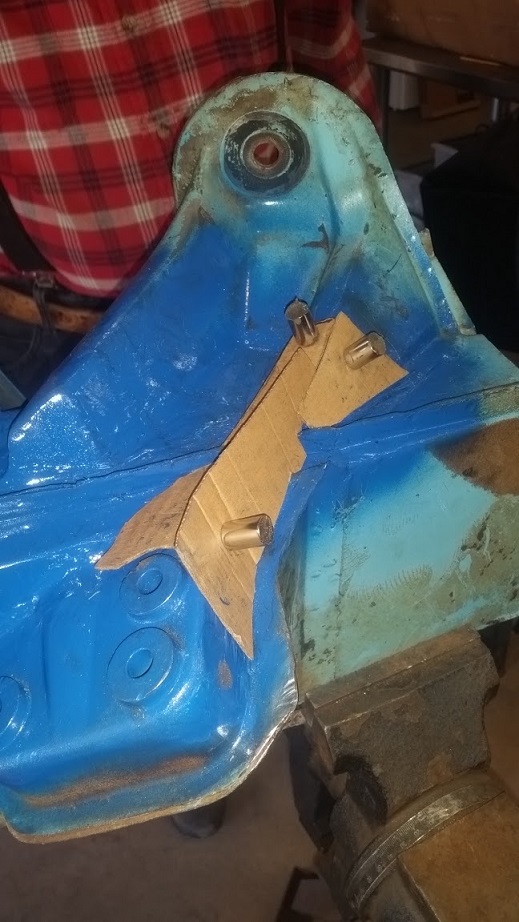

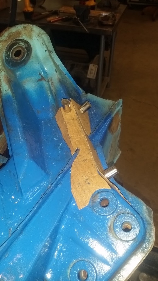

There's been a lot of talk about these lately. They're 12 gauge steel making them difficult to fabricate, unfortunately they're no longer available from Porsche, and tragically, nobody makes a replacement for them. So let's figure out what can be done.

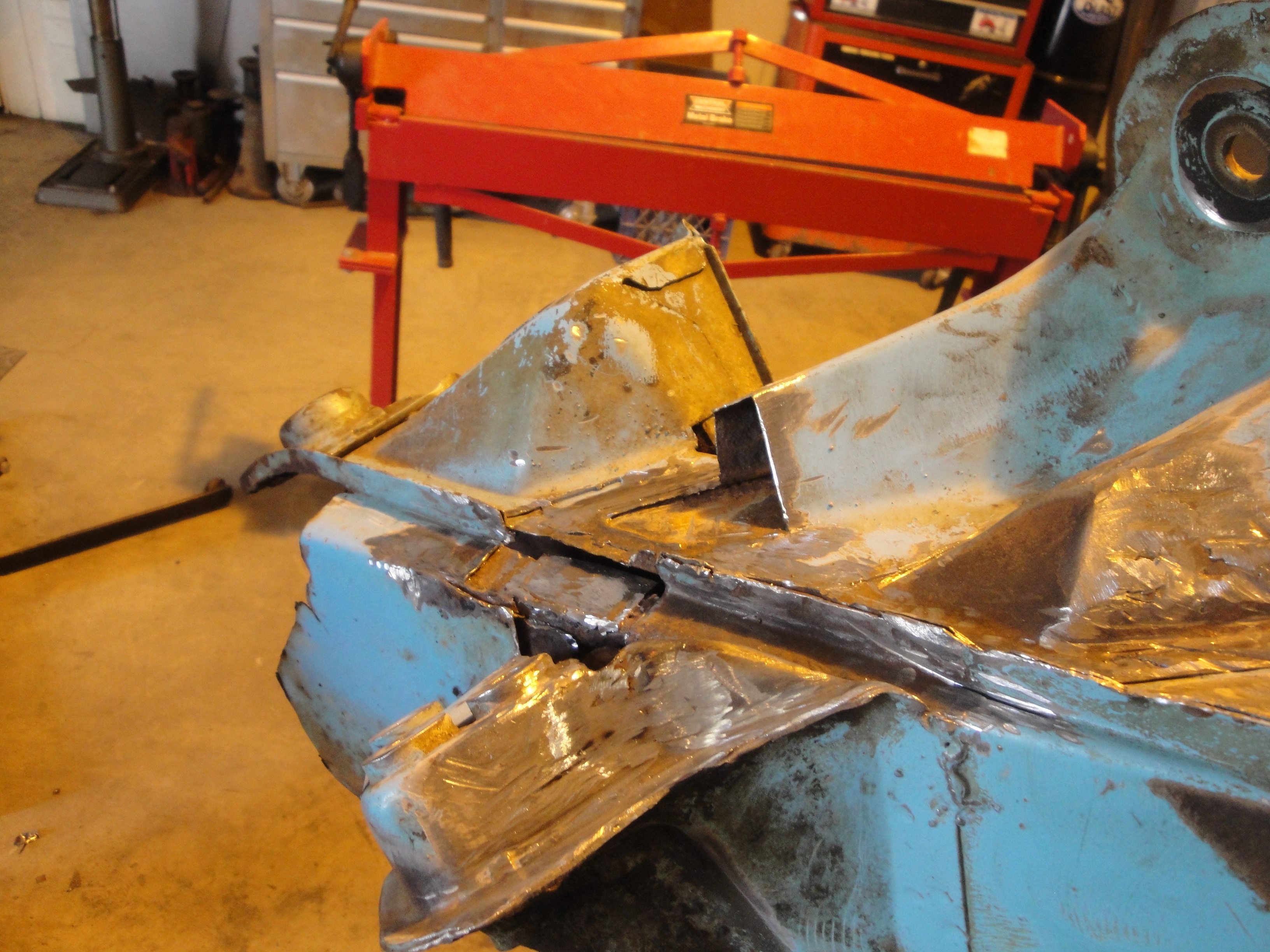

We're finally working back at my place. Super In Law finished repairing the suspension section itself. So on to creating the patterns.
Still plan on making 4-5 sets when we get there. One for Mark. Send one to Pete at RD to set on his desk as a reminder. LOL.
Doing it by hand we will have a seam weld down the backbone.
