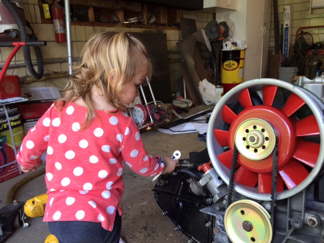

Even my granddaughter is helping me finish this project! We have to get them interested at a very young age.
