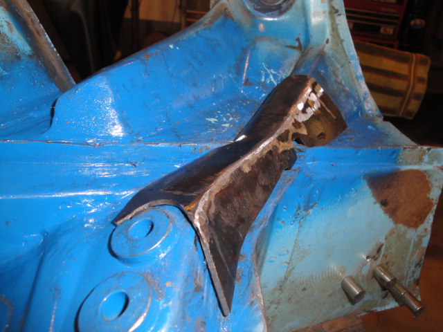

There's been a lot of talk about these lately. They're 12 gauge steel making them difficult to fabricate, unfortunately they're no longer available from Porsche, and tragically, nobody makes a replacement for them. So let's figure out what can be done.

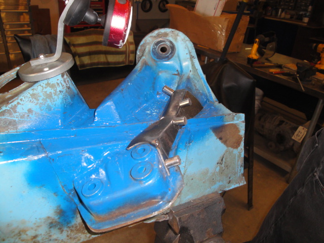

Getting back to work. Super In Law is back to work on the ties. He just finished up the longer piece.

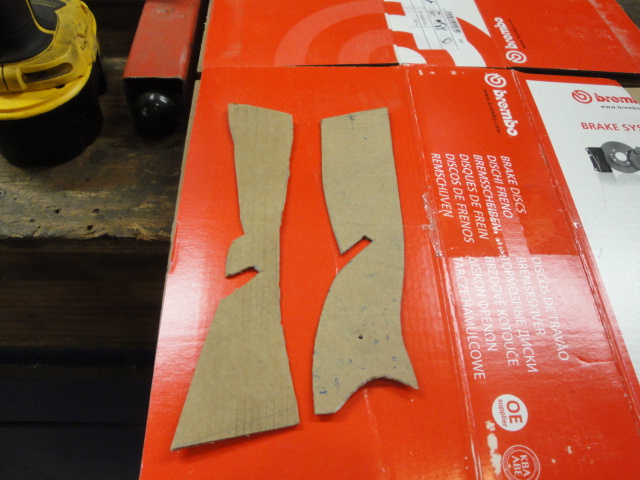

Patterns become 12 gauge steel pieces.
Fitted and seam welded.
Best we can tell we'll be able flip the patterns over and use them on the other side.
We'll probably have to create these in two steps. Have the steel cut out on a CNC. Then have Super In Law fit, shape and weld them. Until RD makes them for use.
