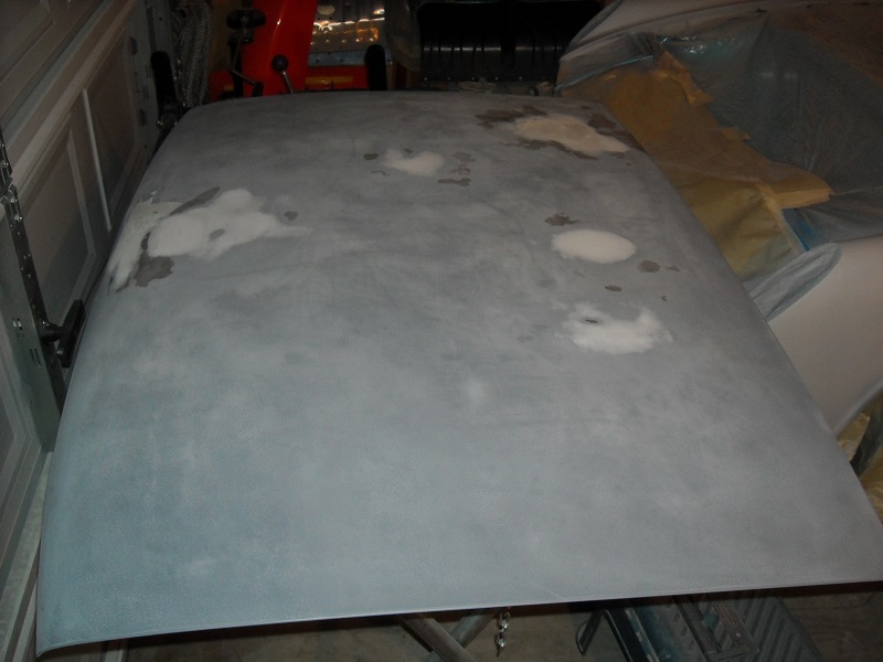

More work required on the trunk lid than I thought there would be.
it turned out pretty good.

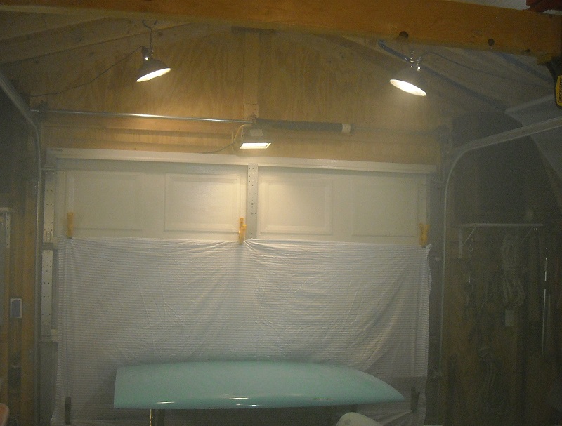

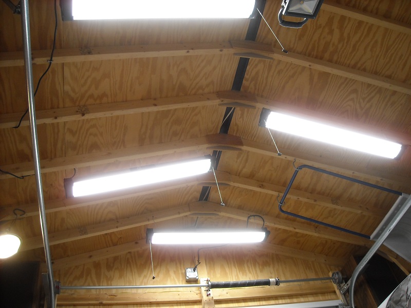

But I found that even with a bunch of clamp-on lights I still couldn’t see well enough. (the haze in the air is paint , need better ventilation, more on that later. )
So I wired a few switched quad receptacles and put up a bunch of 4000 lumen LED shop lights, seven so far. And I can click them all on or off easily. Now with these and a couple more strategically placed clamp on lights I can see to paint without shadows

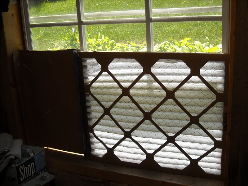

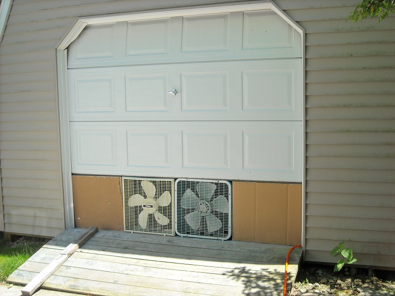

Next up was ventilation. Using a couple box fans in the doorway I put wooden/cardboard fillers on each side and attached a piece of heavy construction plastic sheeting across the top of the doorway, to keep dust from being sucked back in.
And put furnace filters into the windows, taped around the edges to give me some filtered fresh air.
Now I am ready to do some painting in my Shed/Custom Paint Booth.

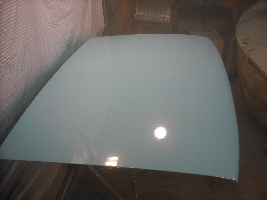

Olympic 914   After blocking the hood, painted it along with the...   Jun 16 2017, 10:42 AM
