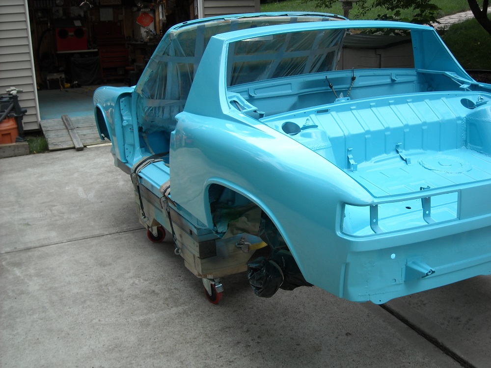

June 2016 update

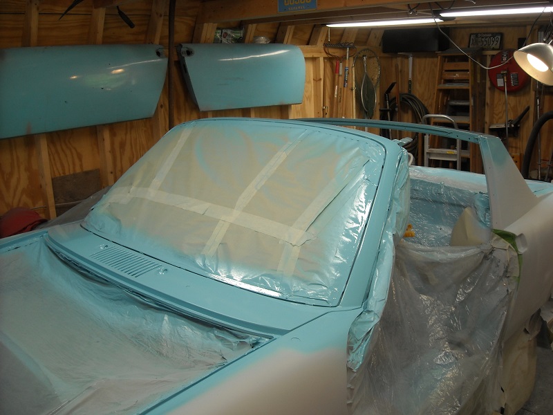

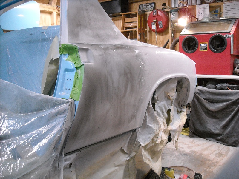

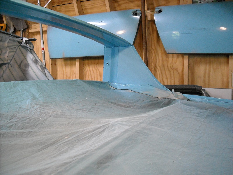

Back to the drivers side to finalize the work on the fenders and lips. One last wet sanding with 600.
And I shot the cowl, windshield frame and top and inside of the Targa bar. The inside of the Targa bar sail panels were a real PITA to get with a HVLP spray gun, I had some bad runs here and painted one side twice and the other side three times. I finally got a good job after digging out an old siphon feed touch-up gun I hadn’t used for about ten years. I was able to get in there with it and lay down some nice paint.

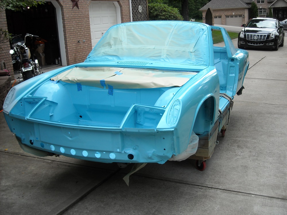

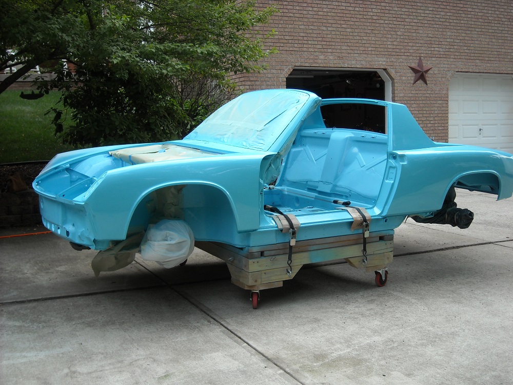

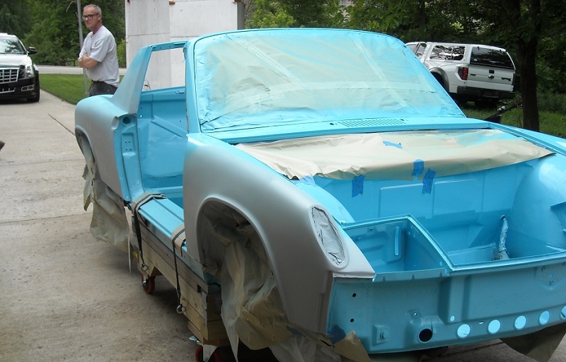

And FINALLY I get to put some color on the fenders. I have been working to this end for what seems like forever.
Still not done yet though. Since my shed workspace is kind of limited I can only work on or paint one side at a time. So now I have to finish the passenger side. Another round of wet sanding and fixing anything that pops up during that. With my new lights installed I have already found a couple, three spots that need some more attention.
If you have a favorite bodyman that does good work for you, you should take time to go buy him a bottle of Crown. Cause this shit is hard, I would hate to have to do it for a living. Especially as picky a bunch as we are…
