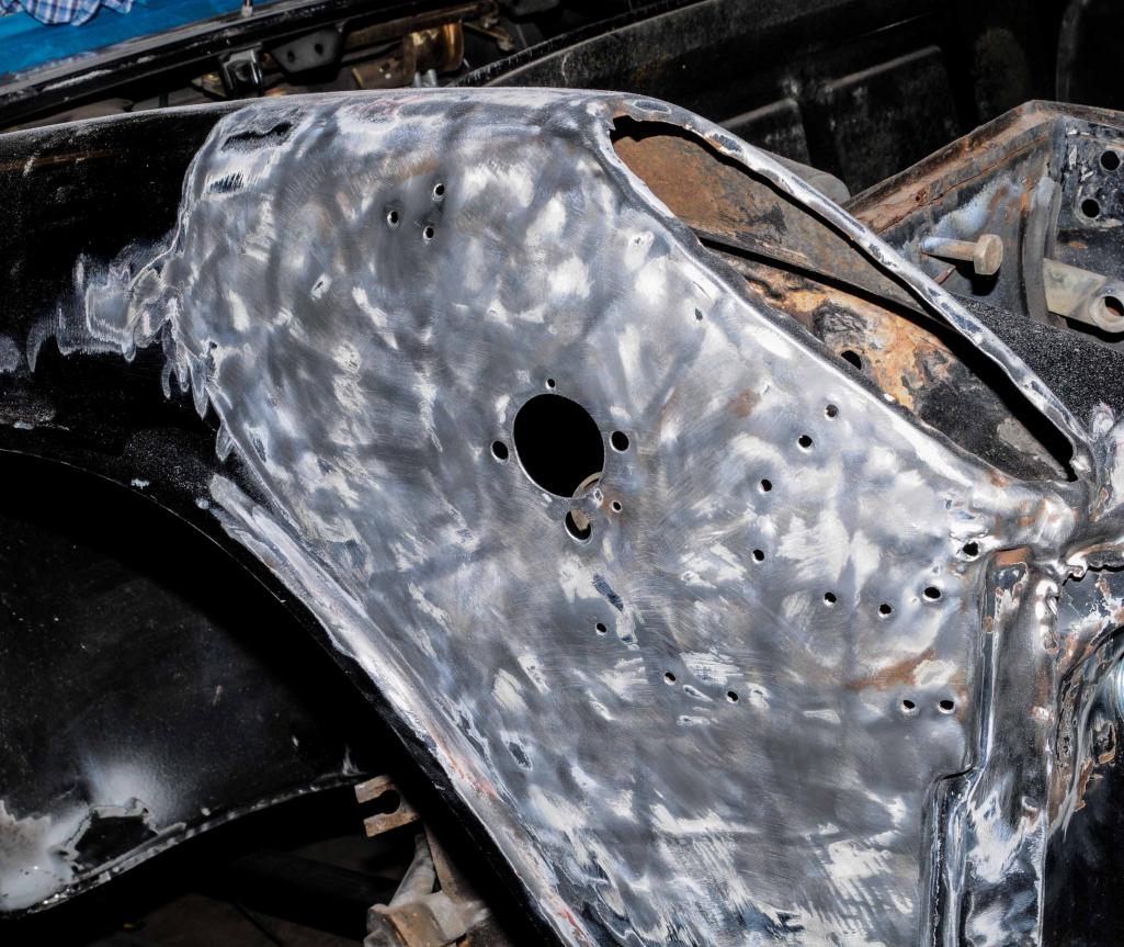

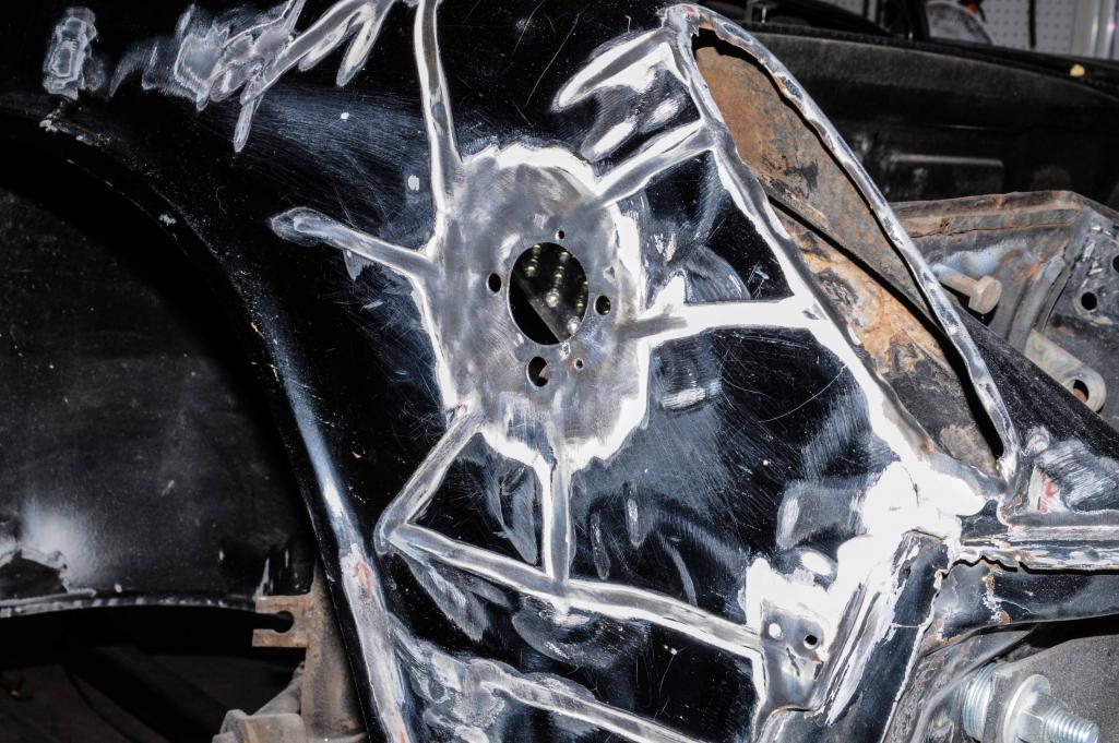

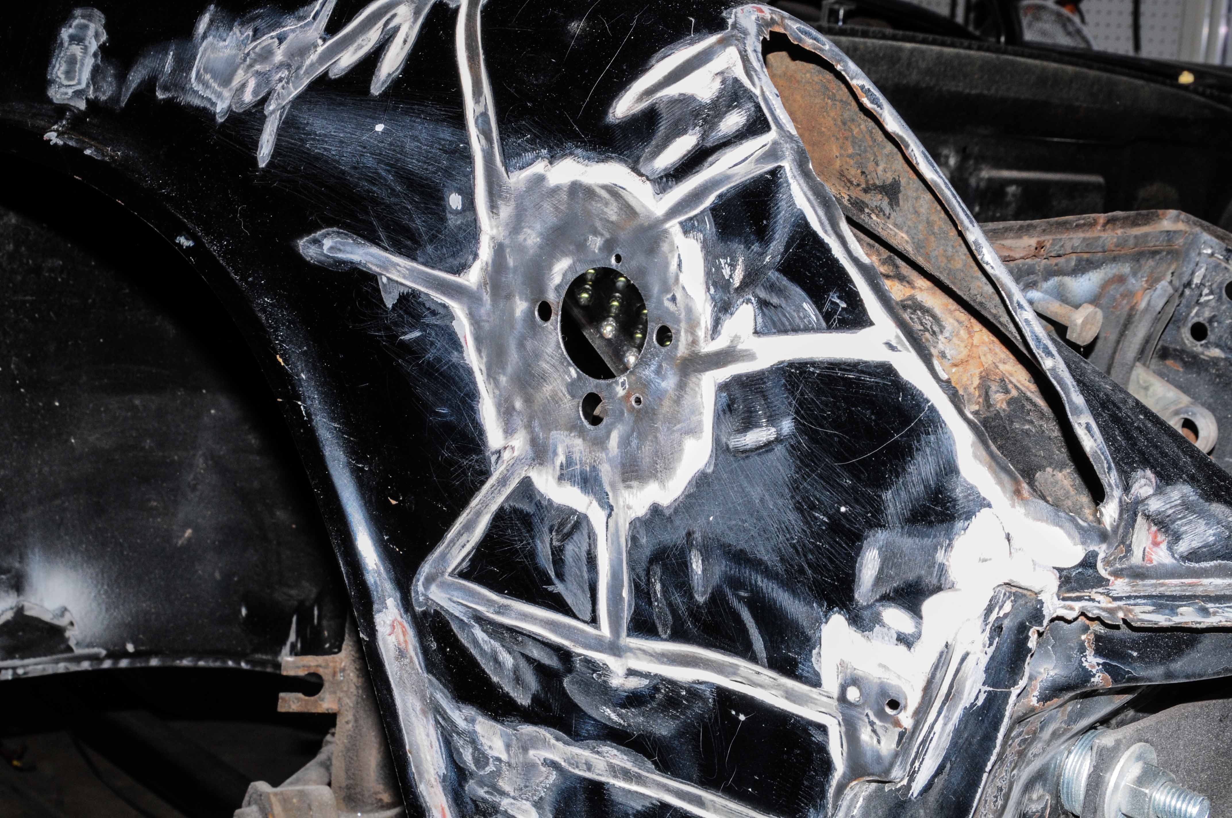

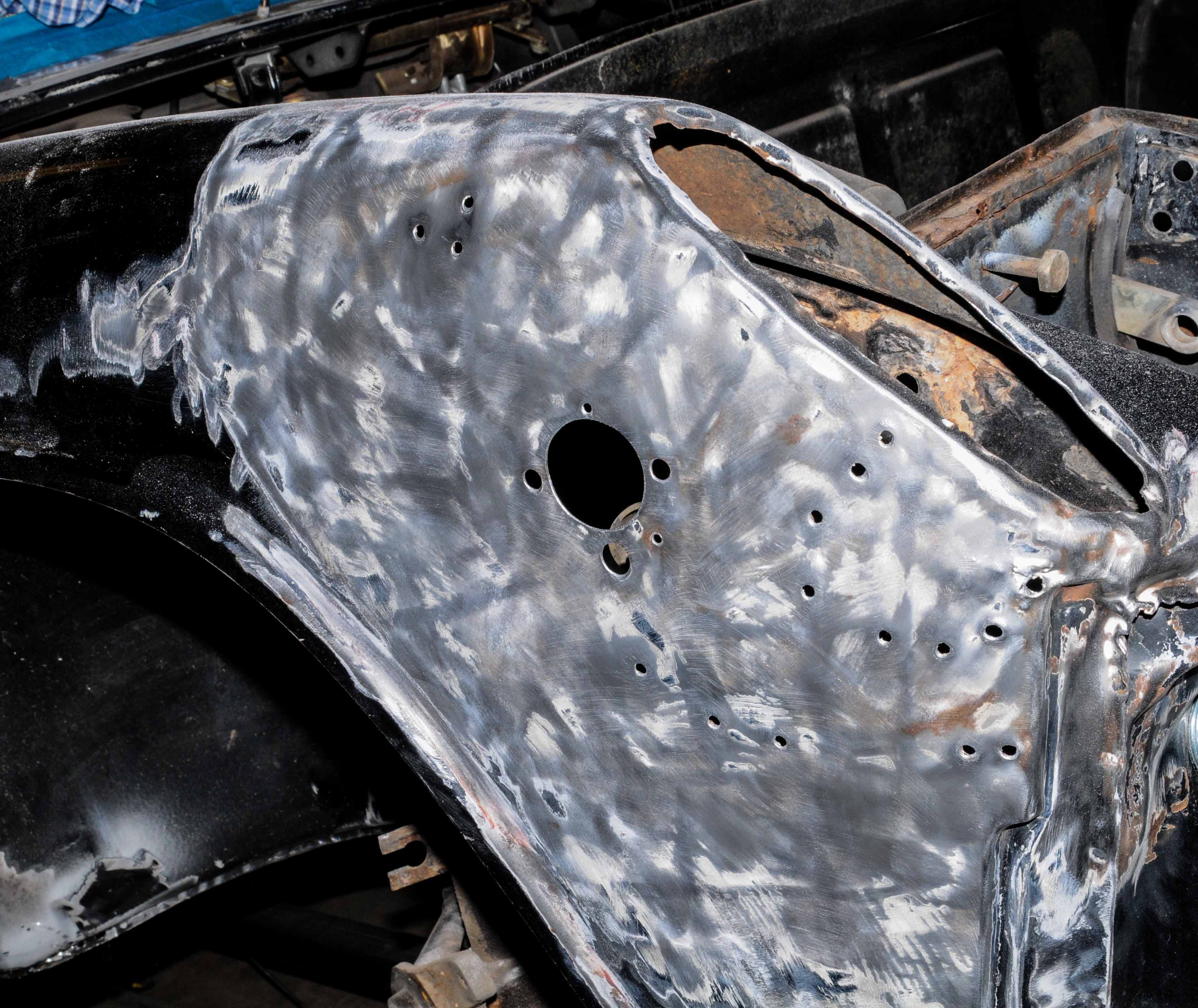

I am currently under investigation by UNESCO and pending trial at The Hague for destroying a previously unknown Michelangelo. But seriously, somebody was a very talented sculptor to do what they did. Now I've got to figure out what to do. I have several options: 1. Play Rodin myself with the filler. 2. Cut and patch the really lumpy areas. 3. Shop for a new fender. 4. Chalon (j/k. No way). I'm totally leaning towards 3.

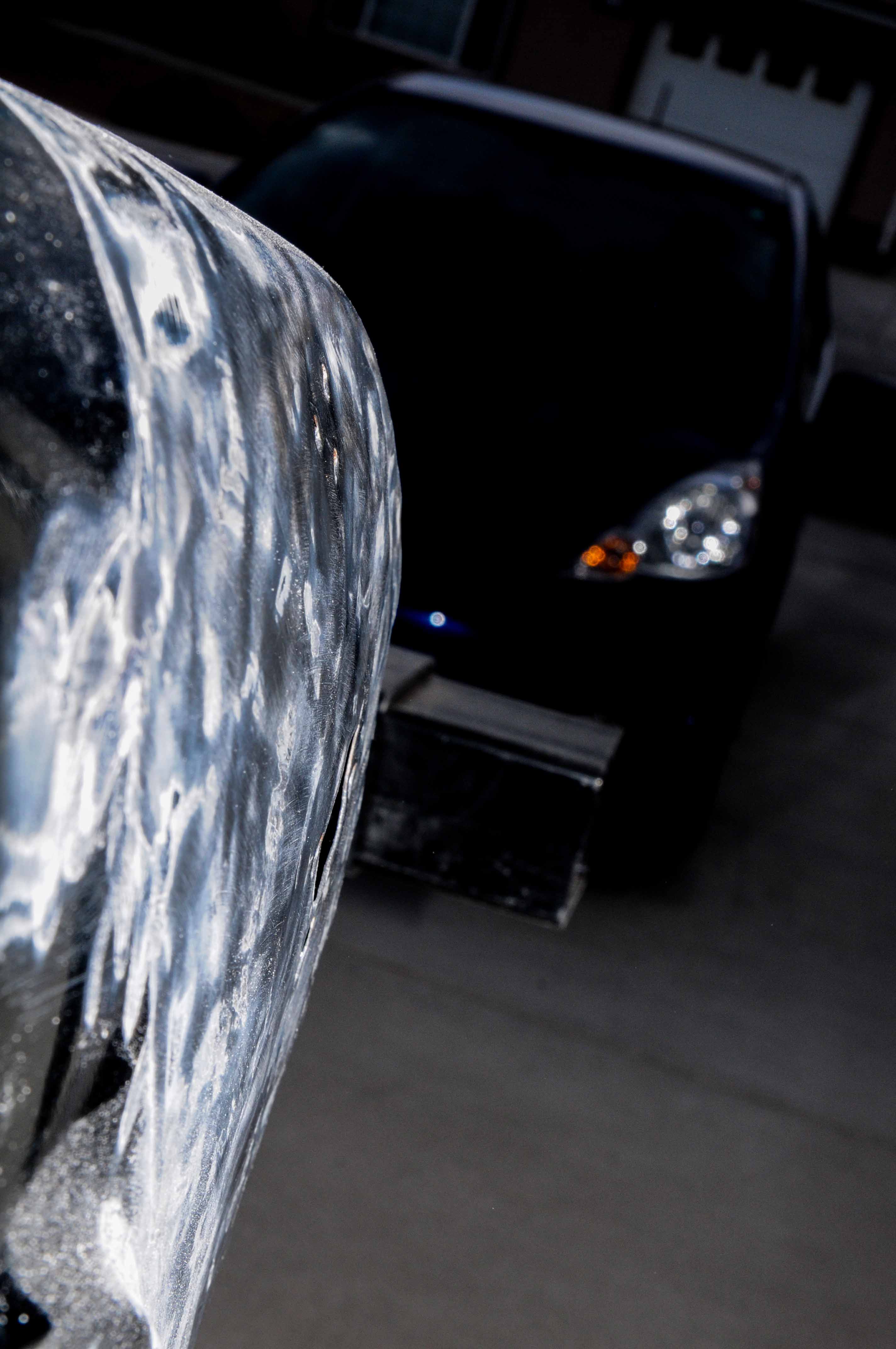

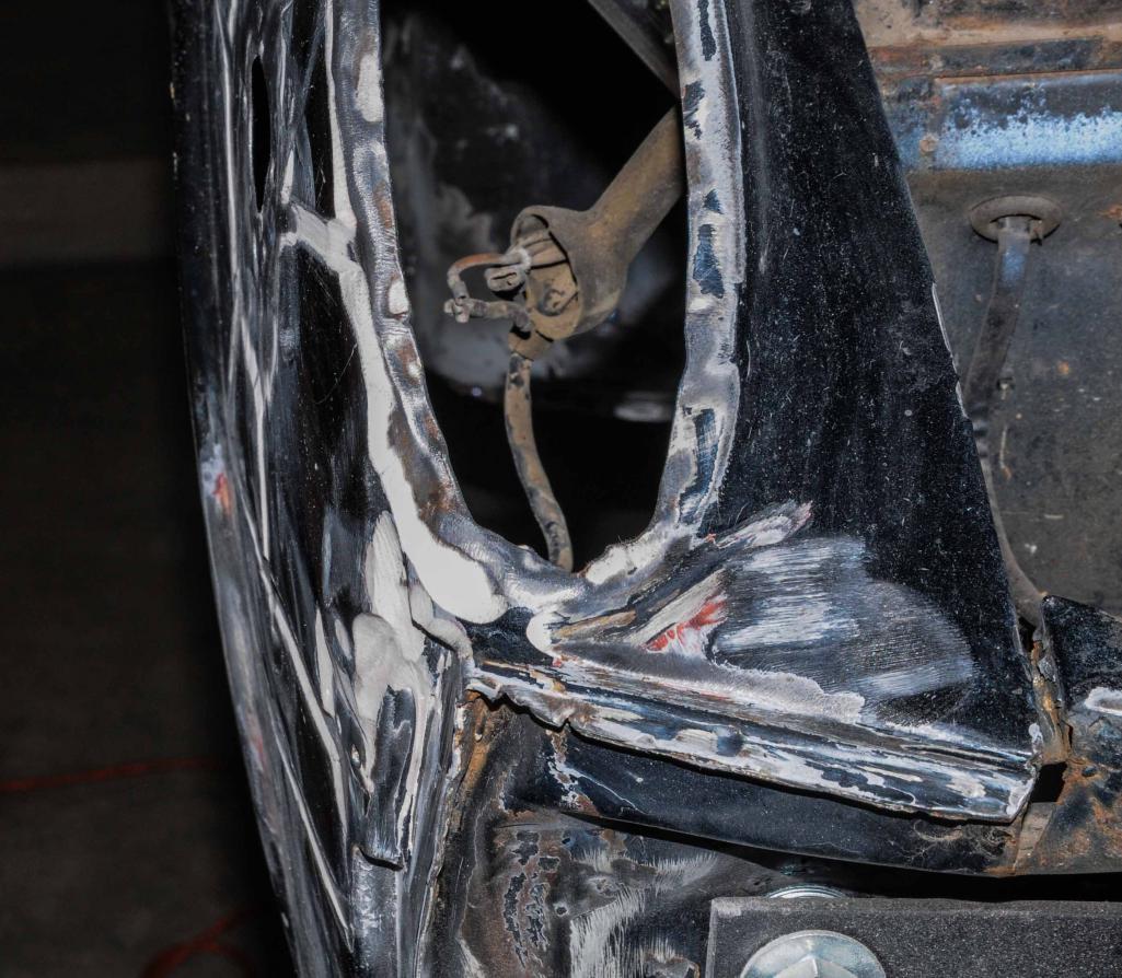

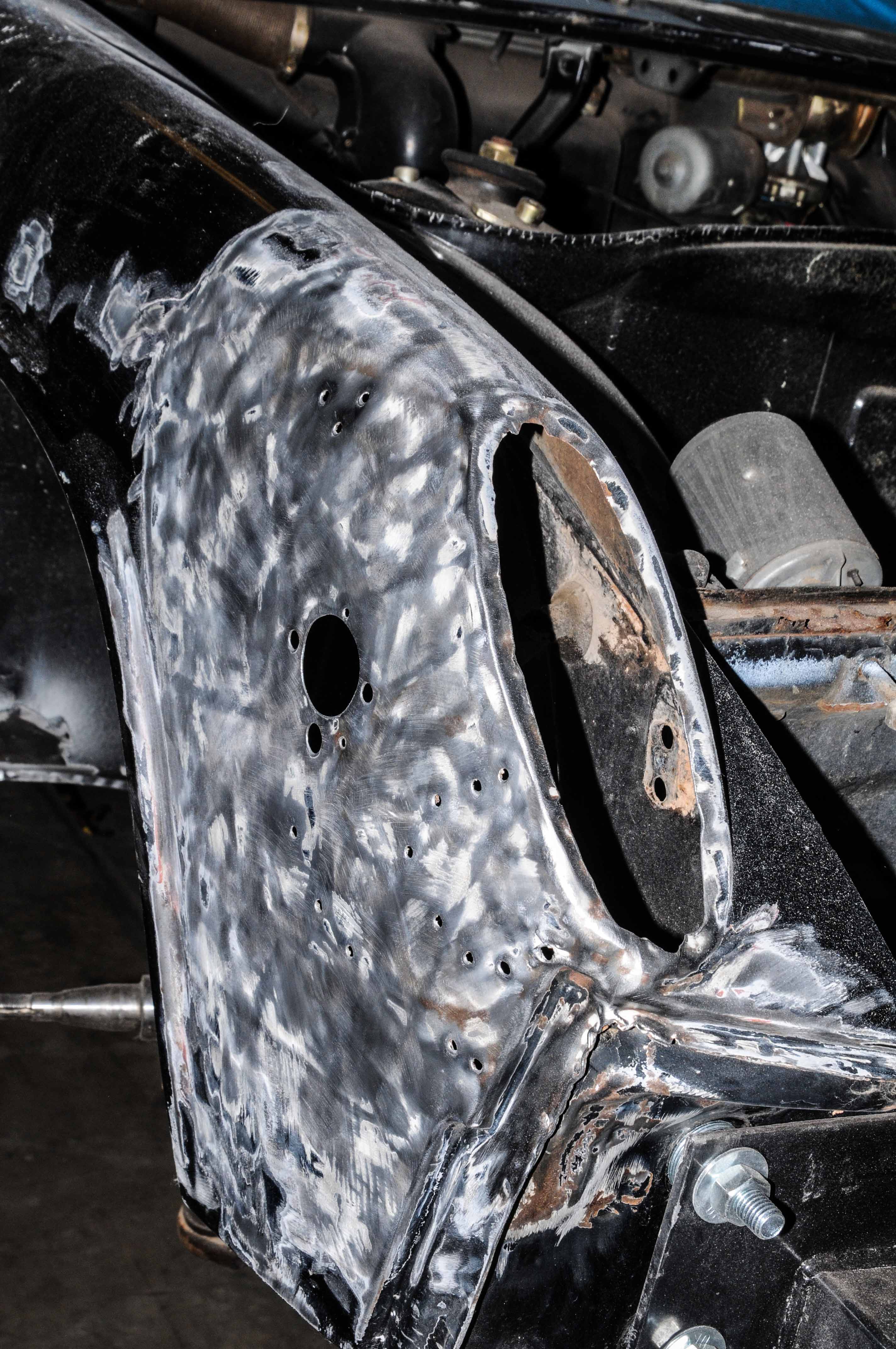

Here are my concerns/questions: If I go with a new fender, how much do I use? The whole thing or just partial? If I'm going through this trouble, should I address that front clip too? Look at pics 1 and 8, see the crinkle and the improper lines below the light hole? Can I bang it right with the fender off for replacement, or does it need replaced too? This is a major issue--biggest since the long repair, if not bigger.
Let's hear some ideas on how to approach this. Meanwhile, I'm gonna be going back to that stupid engine shelf while I figure this out.
