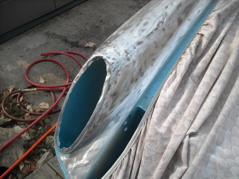

Great job on the fabrication.
I feel your pain, my front fender looked similar, without the holes. I straightened it a little with a hammer and dolly before putting on the bondo. Much less work than cutting off the fender.
