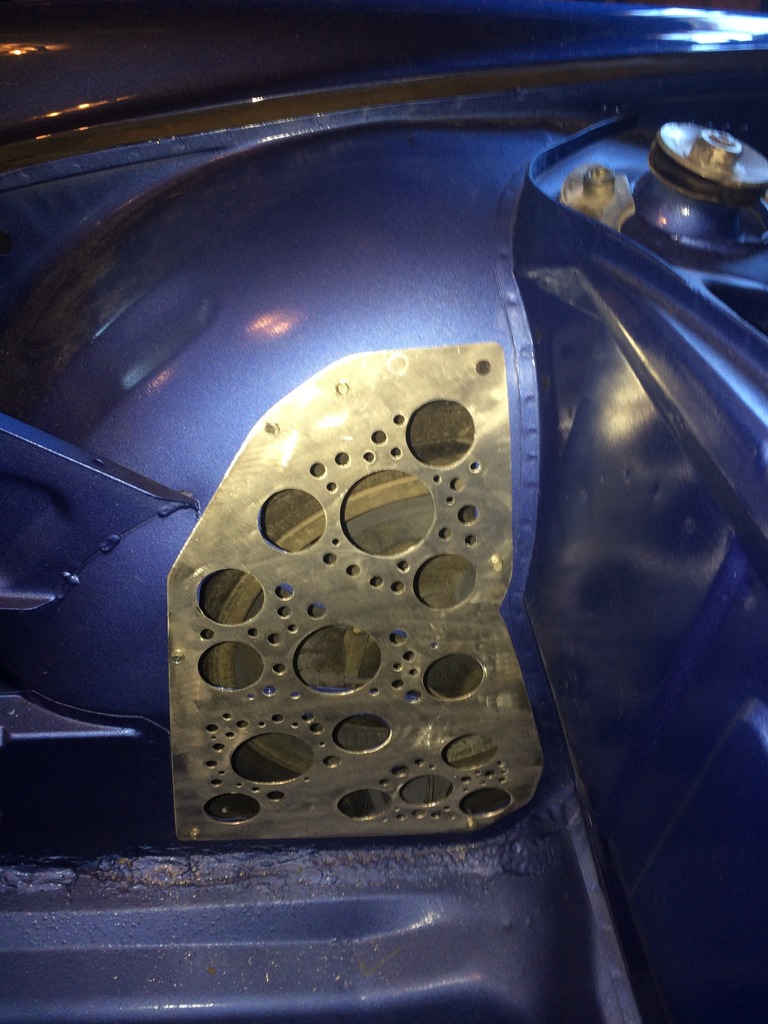

Progress on the Blue Porscheru over the last couple months:
Radiator Cutouts See bottom of Post #48
(IMG:http://www.914world.com/bbs2/uploads_offsite/i1301.photobucket.com-17072-1467096786.1.jpeg)

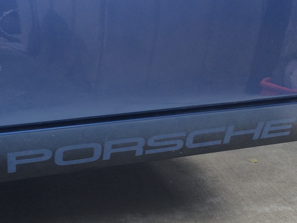

Another shot of the Rocker Panels:
(IMG:http://www.914world.com/bbs2/uploads_offsite/i1301.photobucket.com-17072-1467096786.2.jpeg)

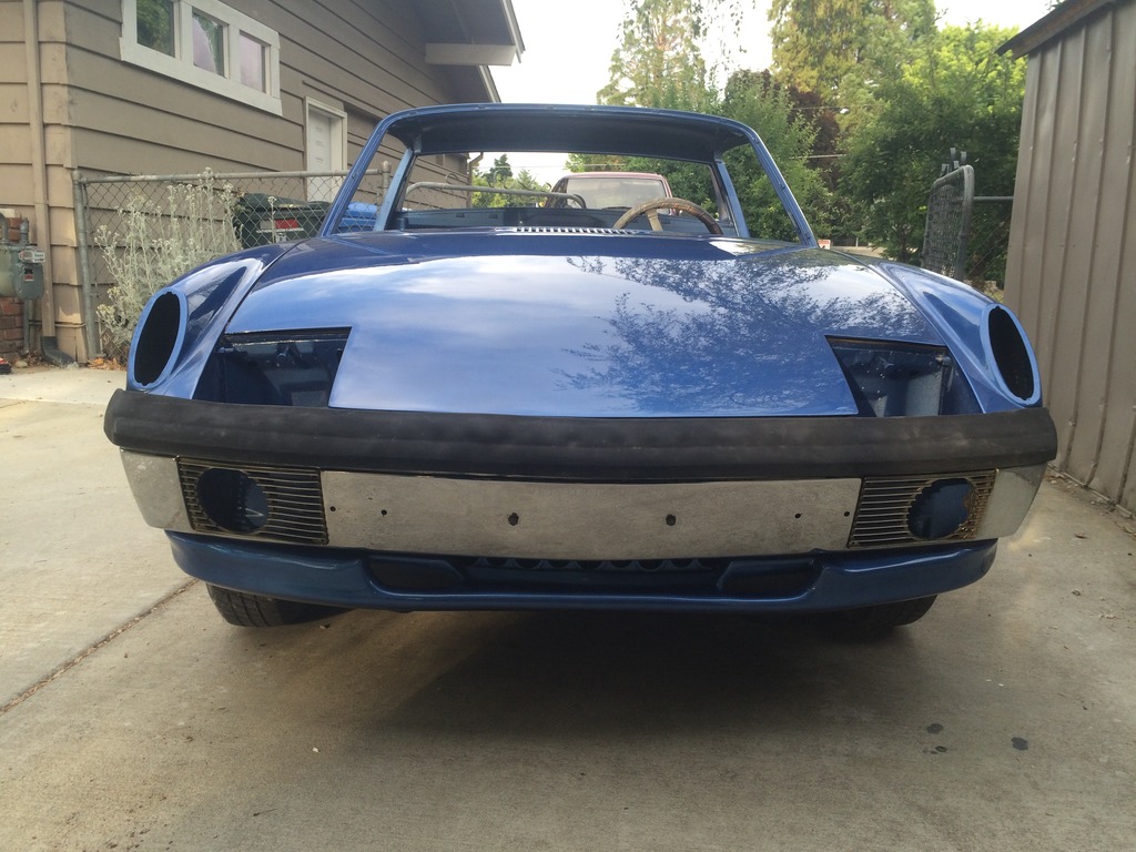

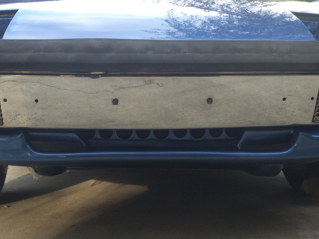

And finally the long awaited bumper reveal. Also see post #70:
(IMG:http://www.914world.com/bbs2/uploads_offsite/i1301.photobucket.com-17072-1467096786.3.jpeg)
(IMG:http://www.914world.com/bbs2/uploads_offsite/i1301.photobucket.com-17072-1467096787.4.jpeg)
