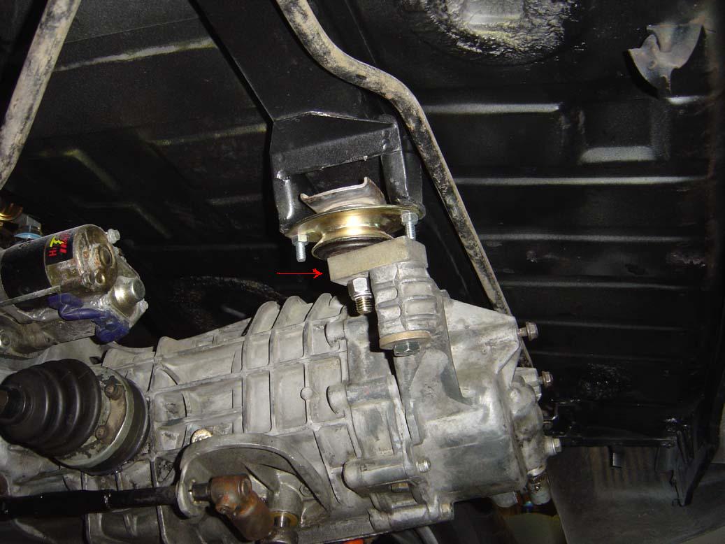

What about this? it is used to push back the tranny for a v-8 conversion.
you could flip it around and keep the stock position. it should drop the tranny down about what you want.
I'm not sure if that is exactly what you are looking for.

sgomes   One step forward and about 10 steps back.... :ang...   Oct 10 2004, 01:08 PM
sgomes   'nother view. That electric motor sticking ou...   Oct 10 2004, 01:10 PM
sgomes   ... and 10 steps back... The only thing differe...   Oct 10 2004, 01:13 PM
sgomes   Hmmm that's about 24 bolts (2 boxes), a bunch ...   Oct 10 2004, 01:17 PM
neo914-6   Can't you just space the tranny mount lower to...   Oct 10 2004, 02:02 PM
sgomes   That's a great idea for the long term. Thanks...   Oct 10 2004, 02:26 PM

sgomes   Ok, so I've been laying under the car staring ...   Oct 10 2004, 04:05 PM

Mueller   why cannot you lower the front of the motor/transm...   Oct 10 2004, 06:12 PM
JB 914   couldn't you use the same thing they use for a...   Oct 10 2004, 06:25 PM
sgomes   In reverse order: Joe: I might be able to use it ...   Oct 10 2004, 07:14 PM

McMark   Those tranny mounts are still rubber. Add a coupl...   Oct 10 2004, 08:56 PM
JB 914   What about this? it is used to push back the tran...   Oct 10 2004, 09:11 PM
Aaron Cox   ...   Oct 10 2004, 09:39 PM
sgomes   Well, thanks again for all the suggestions. I...   Oct 10 2004, 09:55 PM
