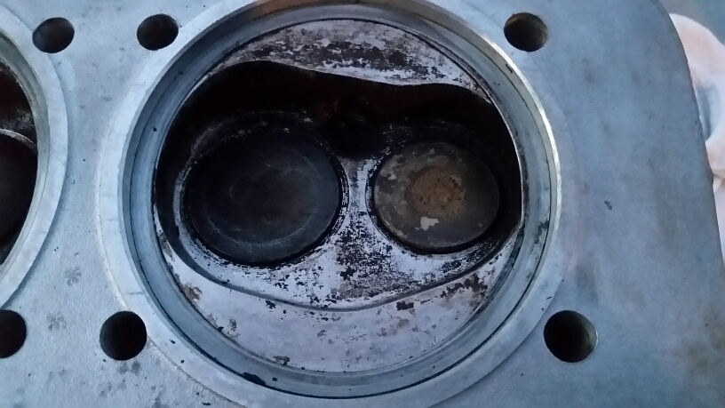

I ran the part numbers on the head and the cylinders, 1.8 parts.
Cylinders are in great shape, no pitting just some discoloration.
Stock camshaft looks odd, or at least to me.
The heads show no signs of cracks, I didn't have to do much to clean the springs and seat area, just wiped off the old oil and sprayed with hot water.
Pistons are in good shape, the one pictured has signs of something falling in there or is that detonation?
Combustion chamber has a few little divots just like the piston, very minor.
I think piston #4 had the most buildup on the top.
