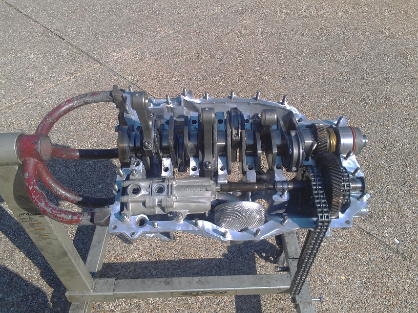

I got the engine cases back, and started assembling the engine this morning.
I was putting the case halves together, and I got bit hard by the engine case. (IMG:style_emoticons/default/hissyfit.gif) To the tune of 7 stitches to the end of the finger I drive with... (IMG:style_emoticons/default/finger.gif) Yes, that finger. I kept making jokes with the doctor and the nurse about " this is not an editorial comment, I am just getting the other fingers out of the way" (IMG:style_emoticons/default/biggrin.gif)
This sucks. I am finally able to make progress on my engine and now I have to stop. (IMG:style_emoticons/default/headbang.gif) My cams should be done on Tuesday, and I was hoping to have the engine assembled and ready for the cams when they arrive.
Maybe I will get out there tomorrow and keep going.
