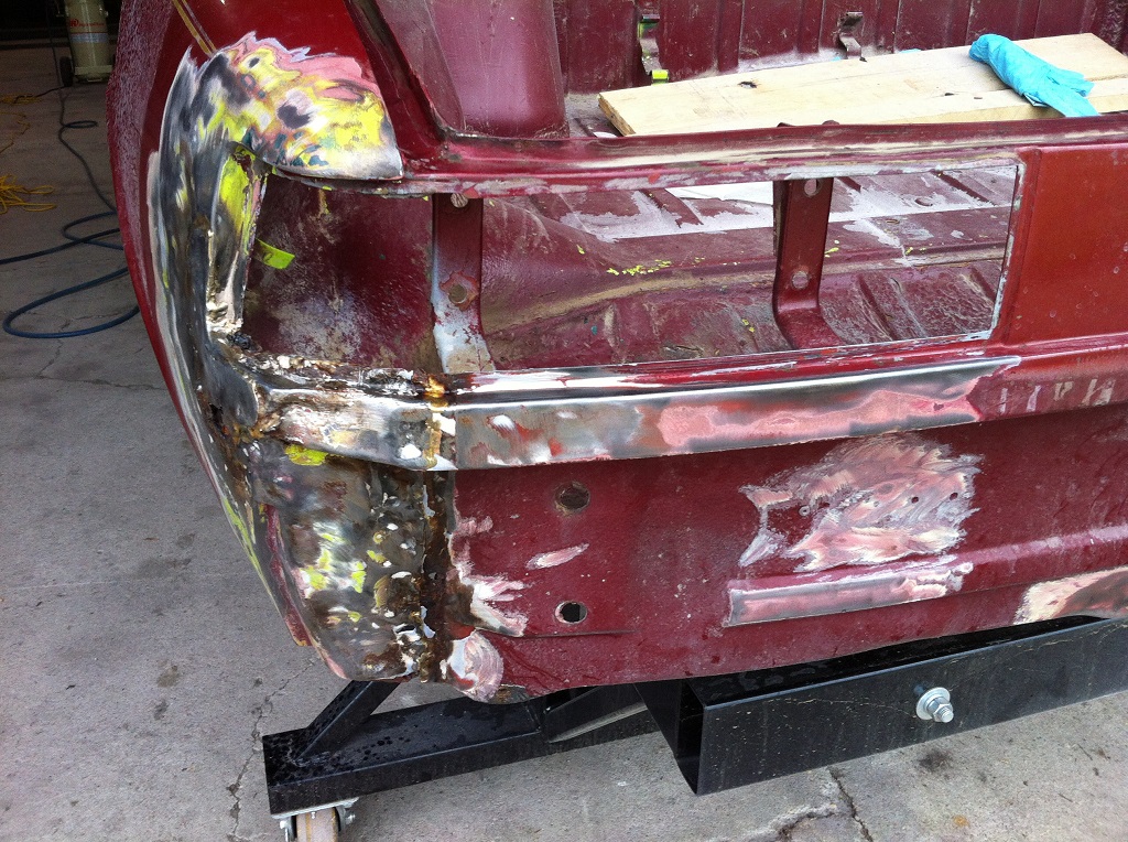

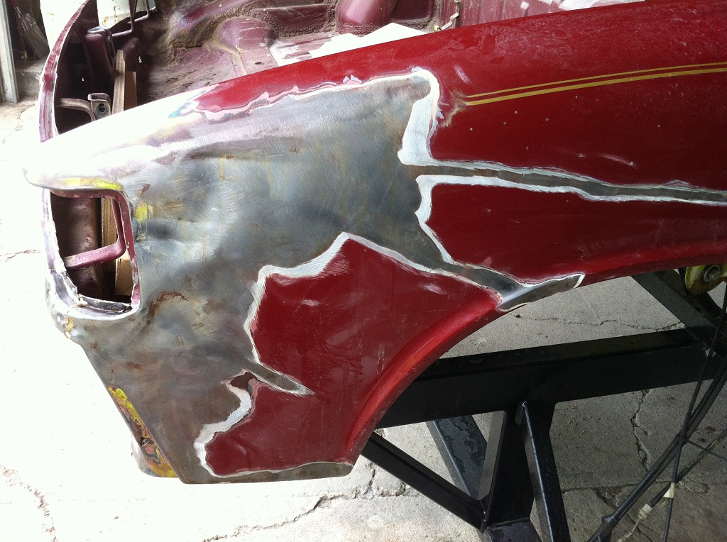

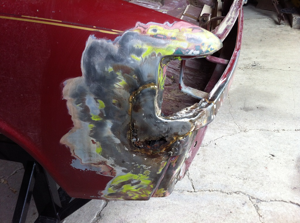

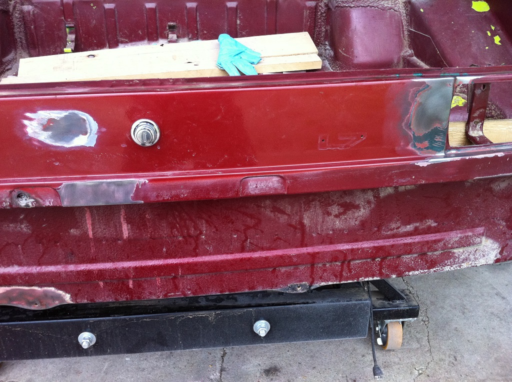

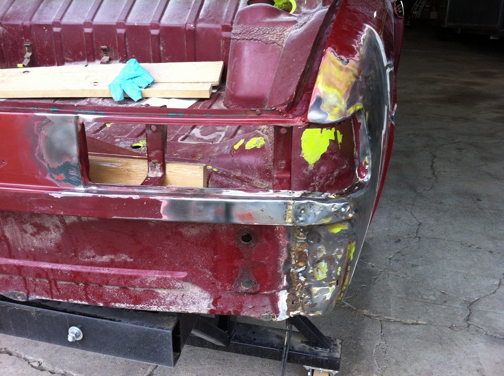

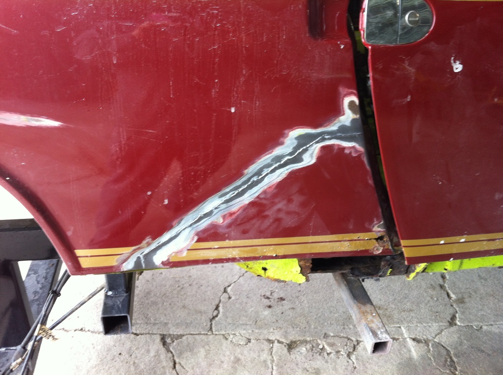

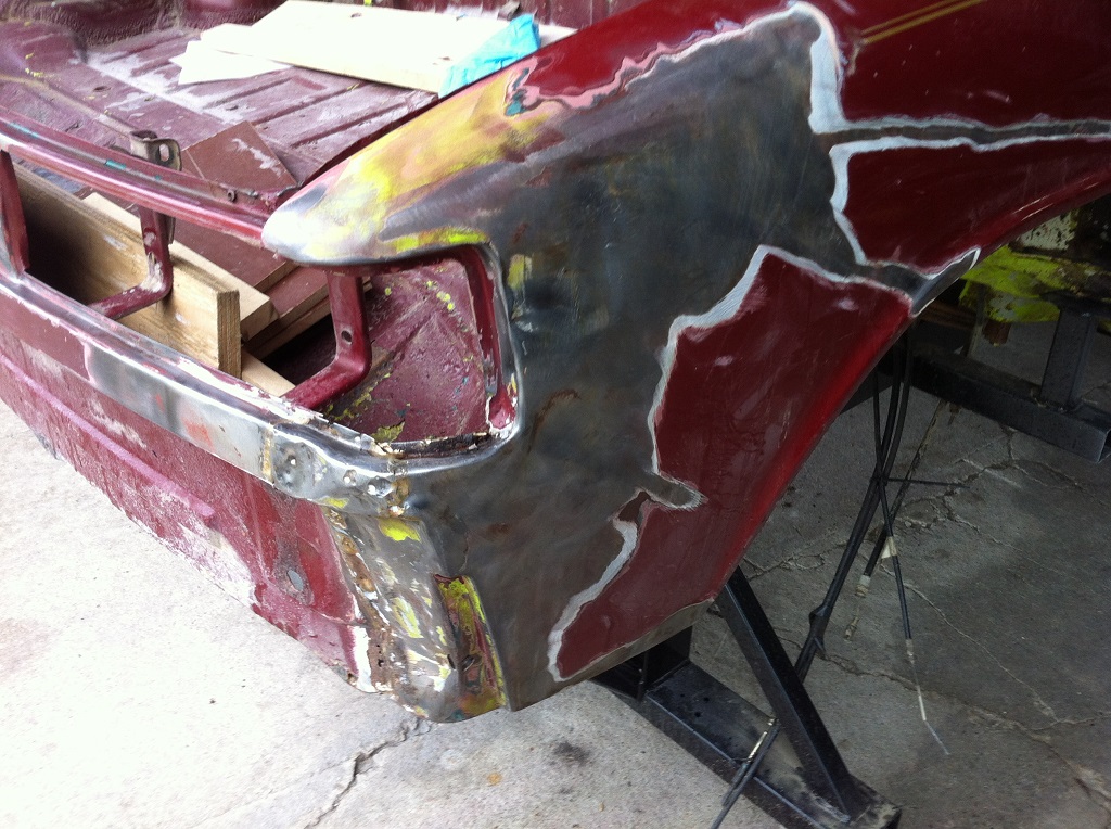

Took the 914 to the farm this weekend to do some of the messy investigational work. It was really interesting to see what was under the filler in the suspicious places.
Both quarters at the rear are mangled at the side and bottom of the taillights. But, when I removed some test patches of paint from the tail section it isn't mangled. So, it looks like the car was rear ended and they replaced the tail section but not the fenders.

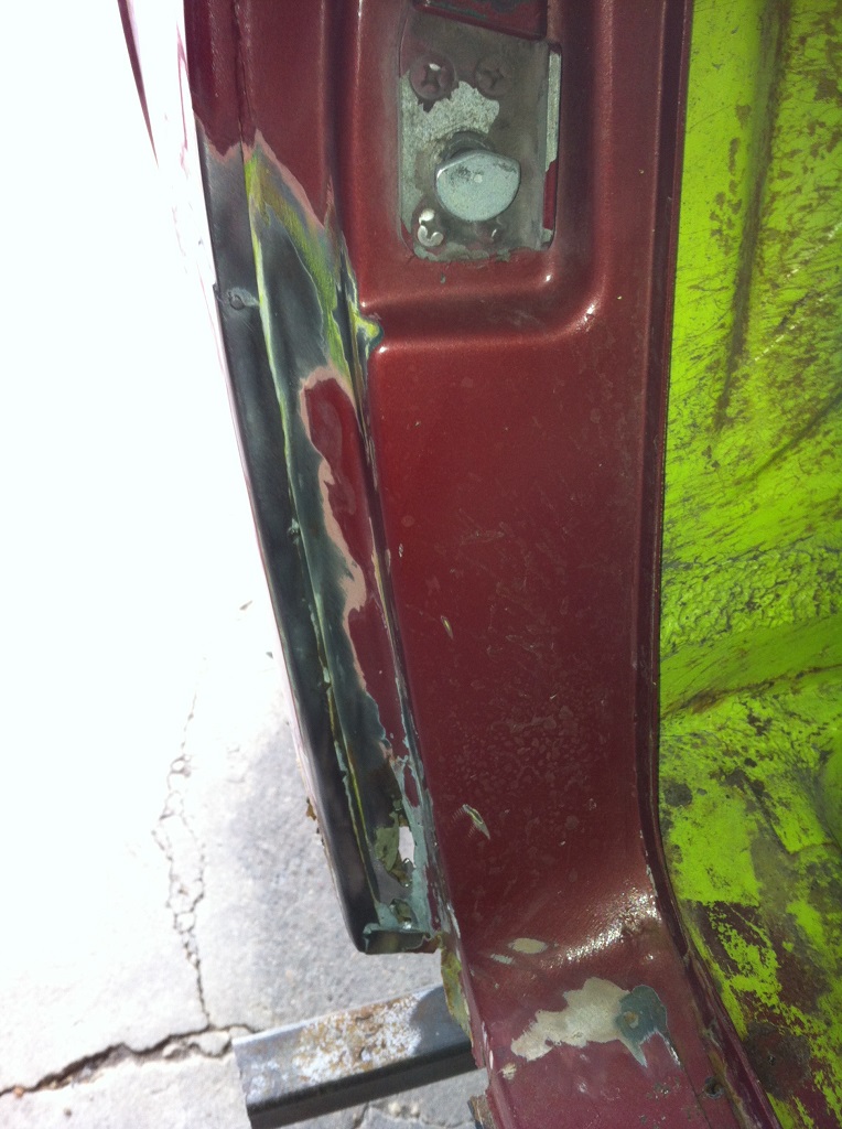

And a where the fenders stick out at doors is at least partly due to someone having scabbed on a rust repair panel rather than cutting out and replacing the metal.
Would the best/only way to address this be to completely remove the rear fenders and replace with good ones from a parts car? Recall that the right rear is 1.25" higher than the left rear. So, if the fenders were removed completely, and then the rear floor pan removed for replacement with a new RD piece, would that be a time to pull down the right rear side so that it's level with the left side, then install the new rear trunk floor pan and then put on the new fenders? If the fenders and rear trunk floor pan are off, is there anything left holding in the tail section?
