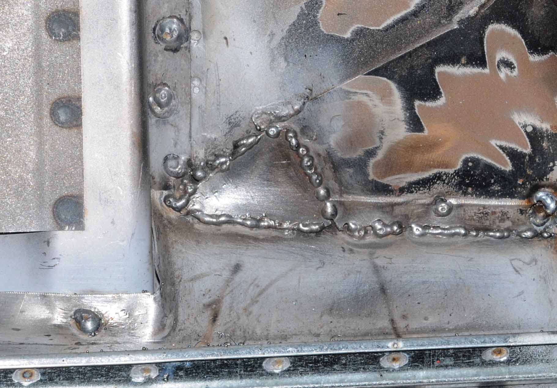

DirtyCossack   For the second tie, I used the method from the abo...   Jun 12 2016, 09:27 PM
DirtyCossack   On 2 other notes: Those are some ugly ass welds.....   Jun 12 2016, 09:29 PM

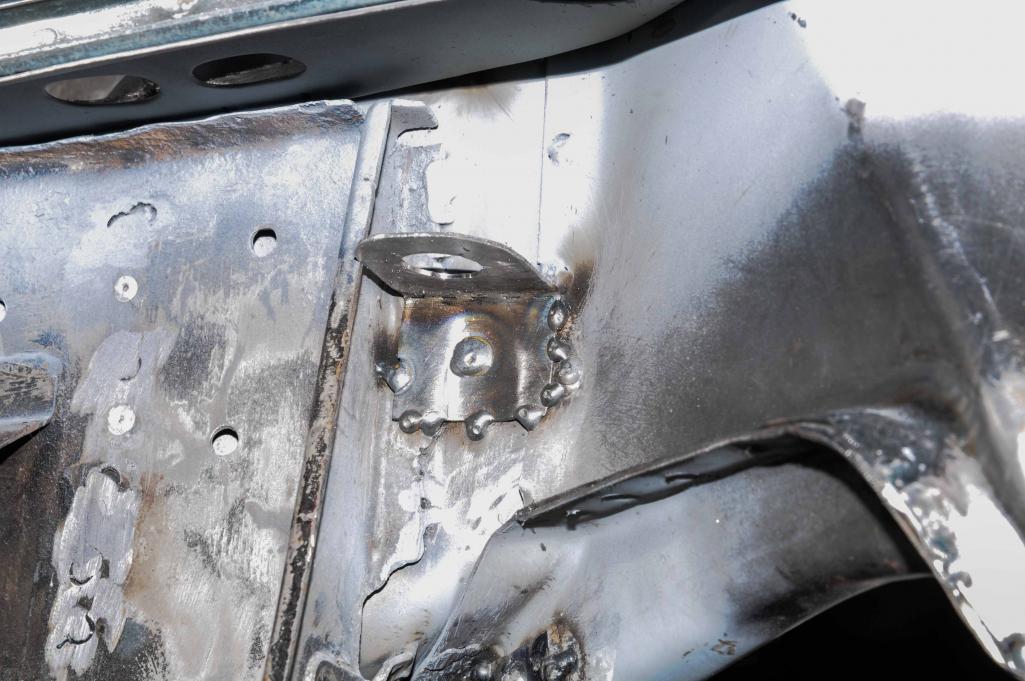

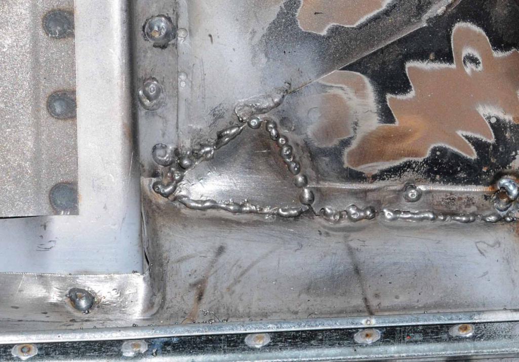

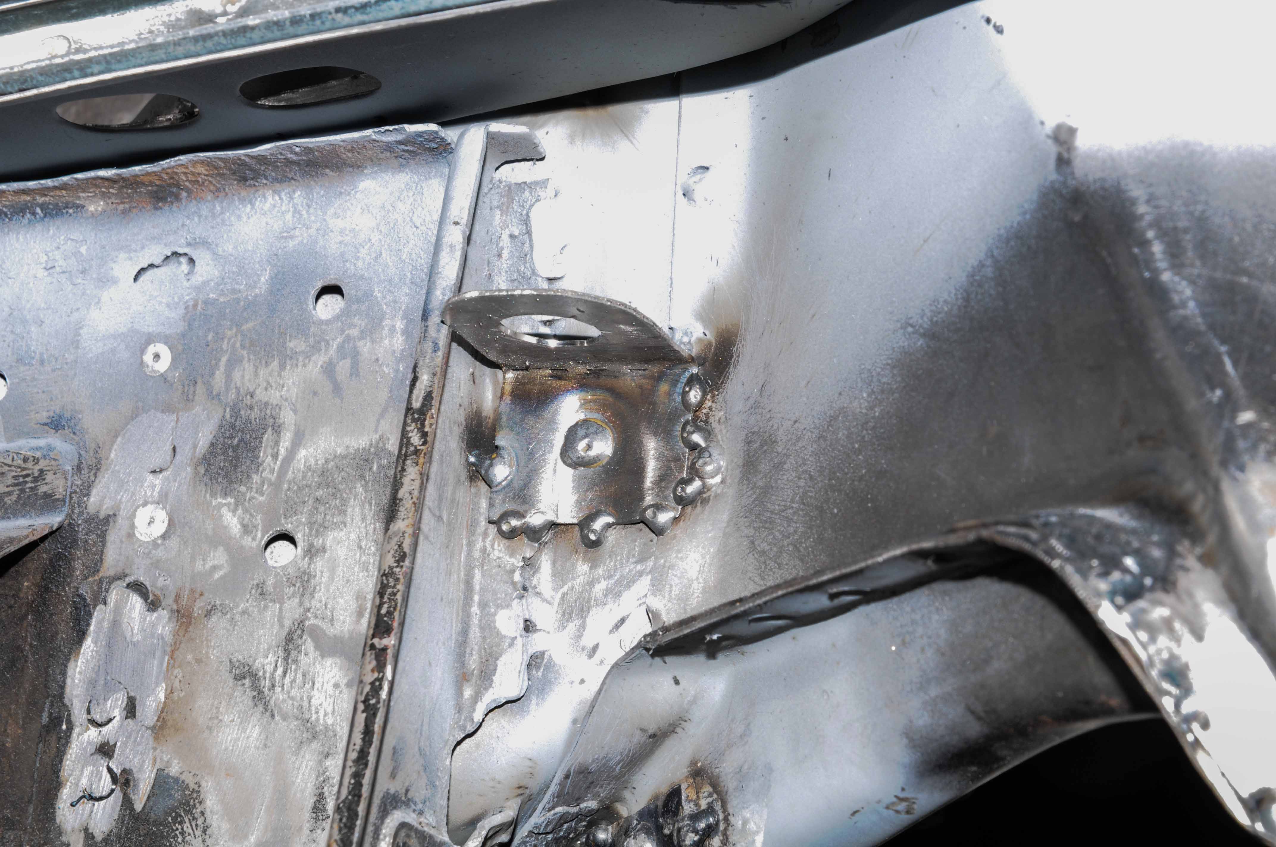

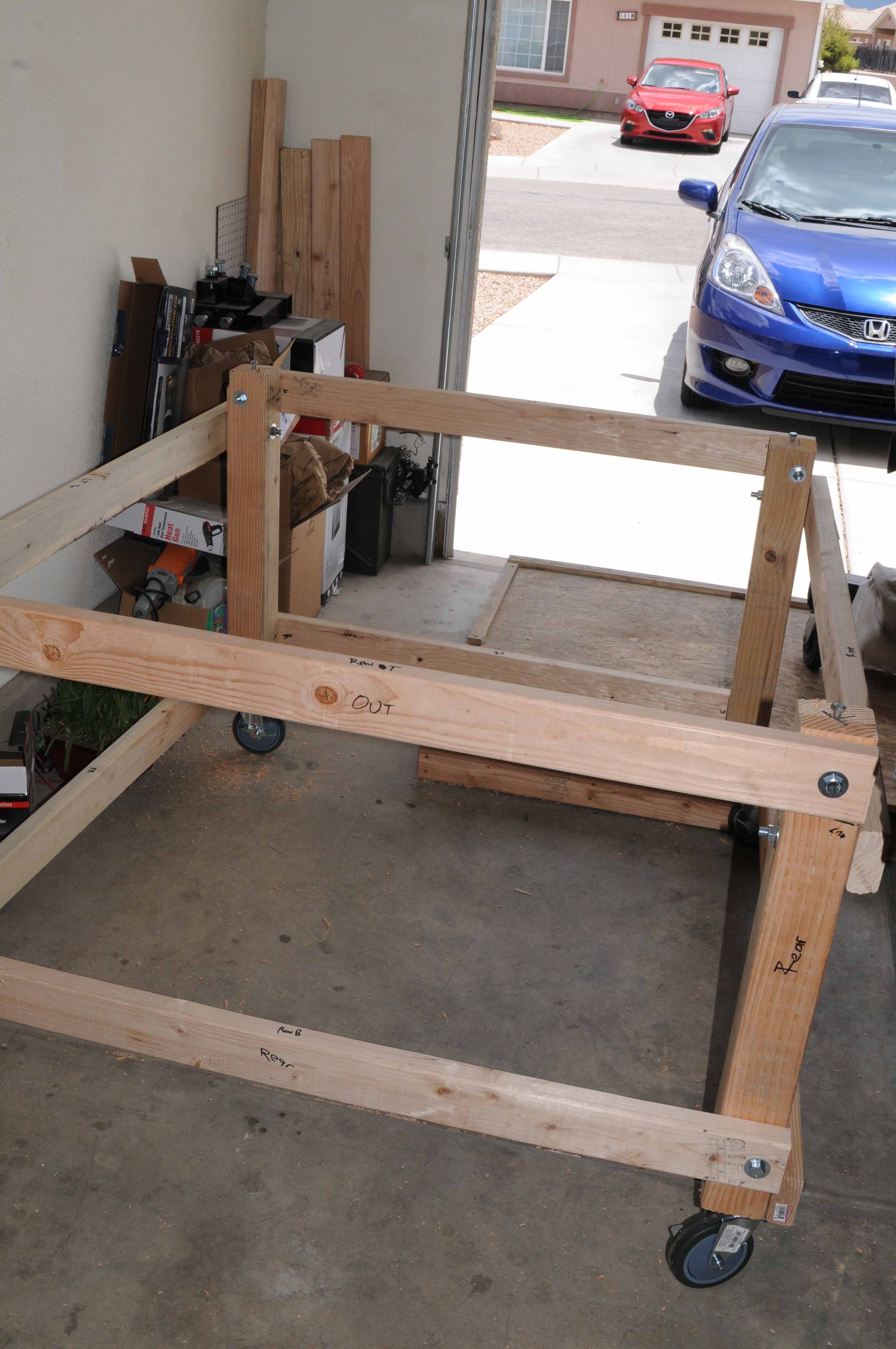

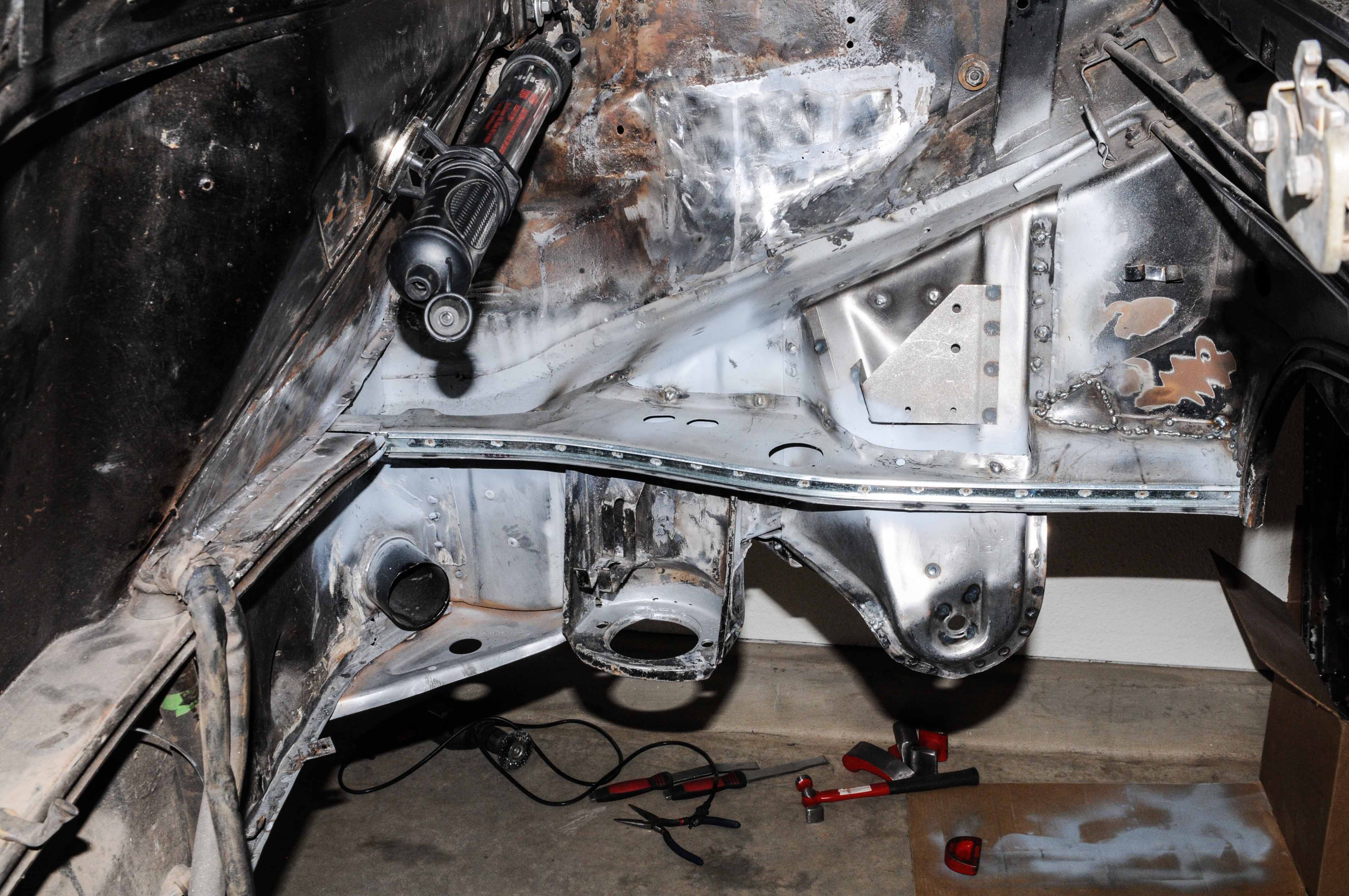

DirtyCossack   It was a long weekend but that did not equate to a...   Jul 4 2016, 09:06 PM

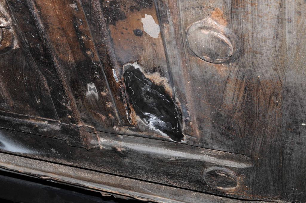

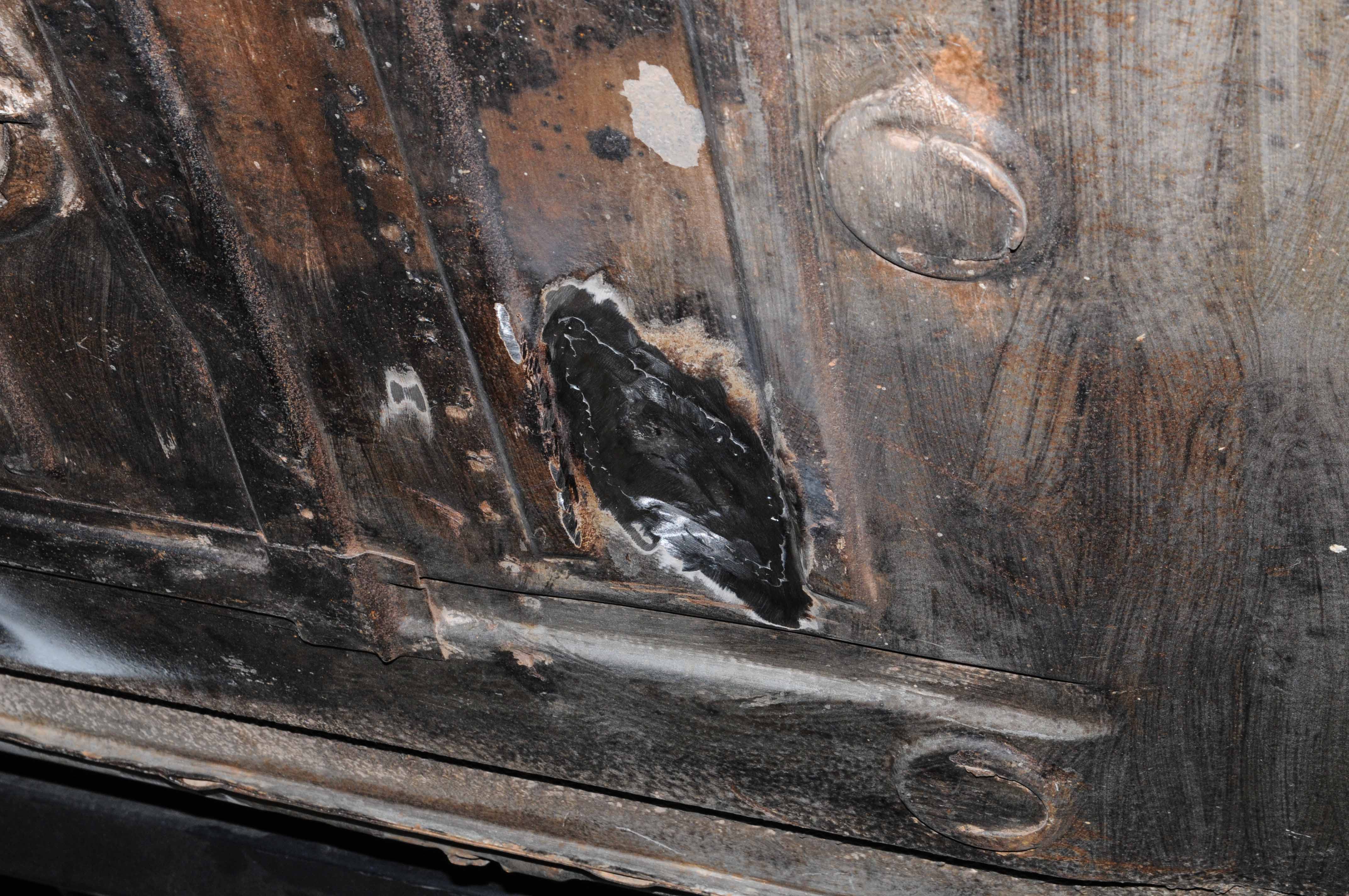

DirtyCossack   Pics of the other side of hell.   Jul 4 2016, 09:09 PM
DirtyCossack   Is it crazy that after I drilled out and cut aroun...   Jul 4 2016, 09:38 PM
