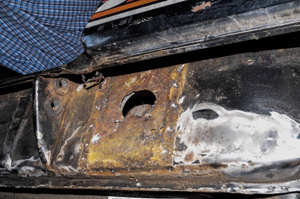

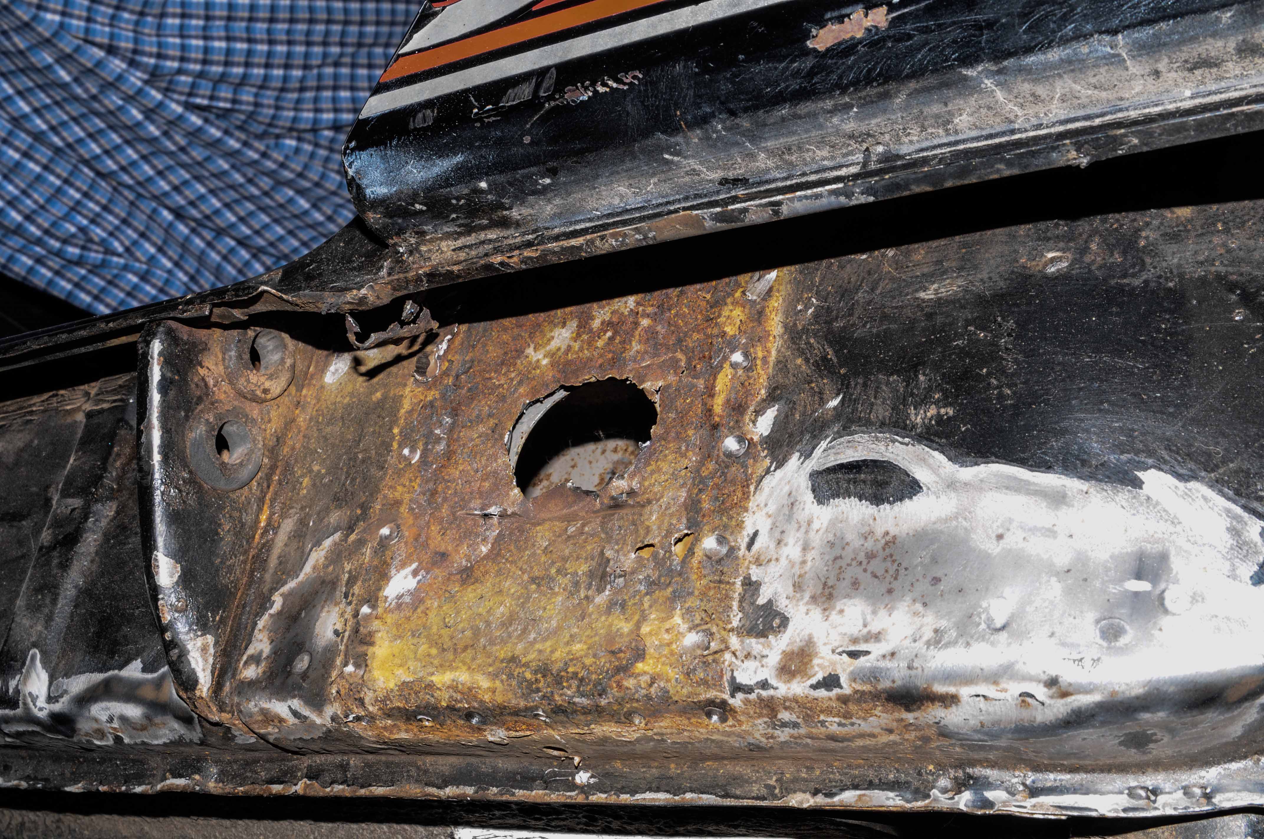

Is it crazy that after I drilled out and cut around the cover, the post ripped off wih a few quick blows with the rubber mallet?
