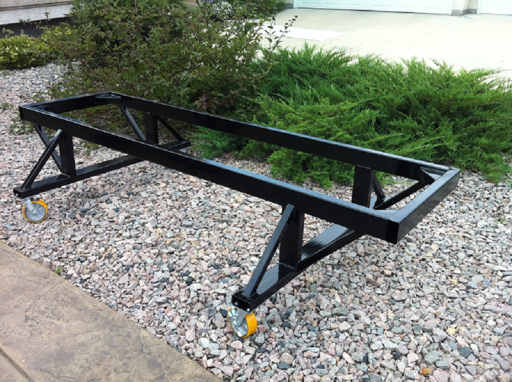

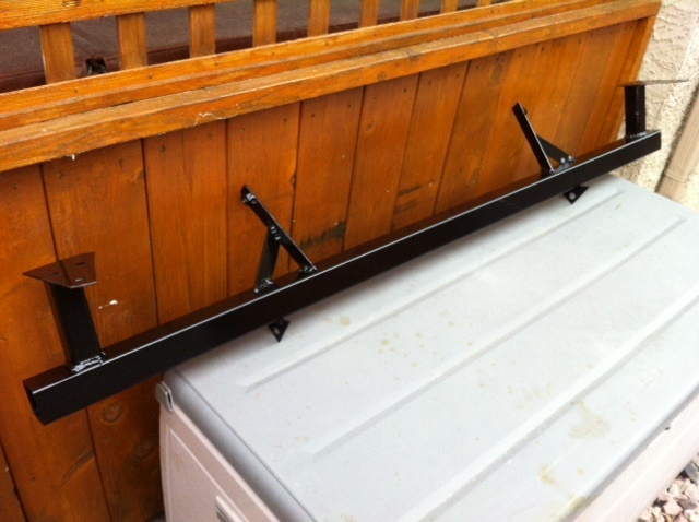

I followed your plans for the bench and fixtures. I also followed Wes's transmission fixture for the back and used his post in your thread about employing a laser level to get it true. I didn't know that he had died. I had emailed him and now I know why I didn't get a reply (IMG:style_emoticons/default/sad.gif) .
Here's the bench before making fixtures (I subsequently put non-swivel castors on the front so that I'd have more control when loading and unloading from the trailer):

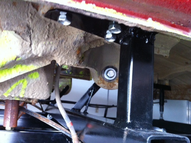

And the latest fixture I made this summer for the suspension mounting points:
and in situ:
