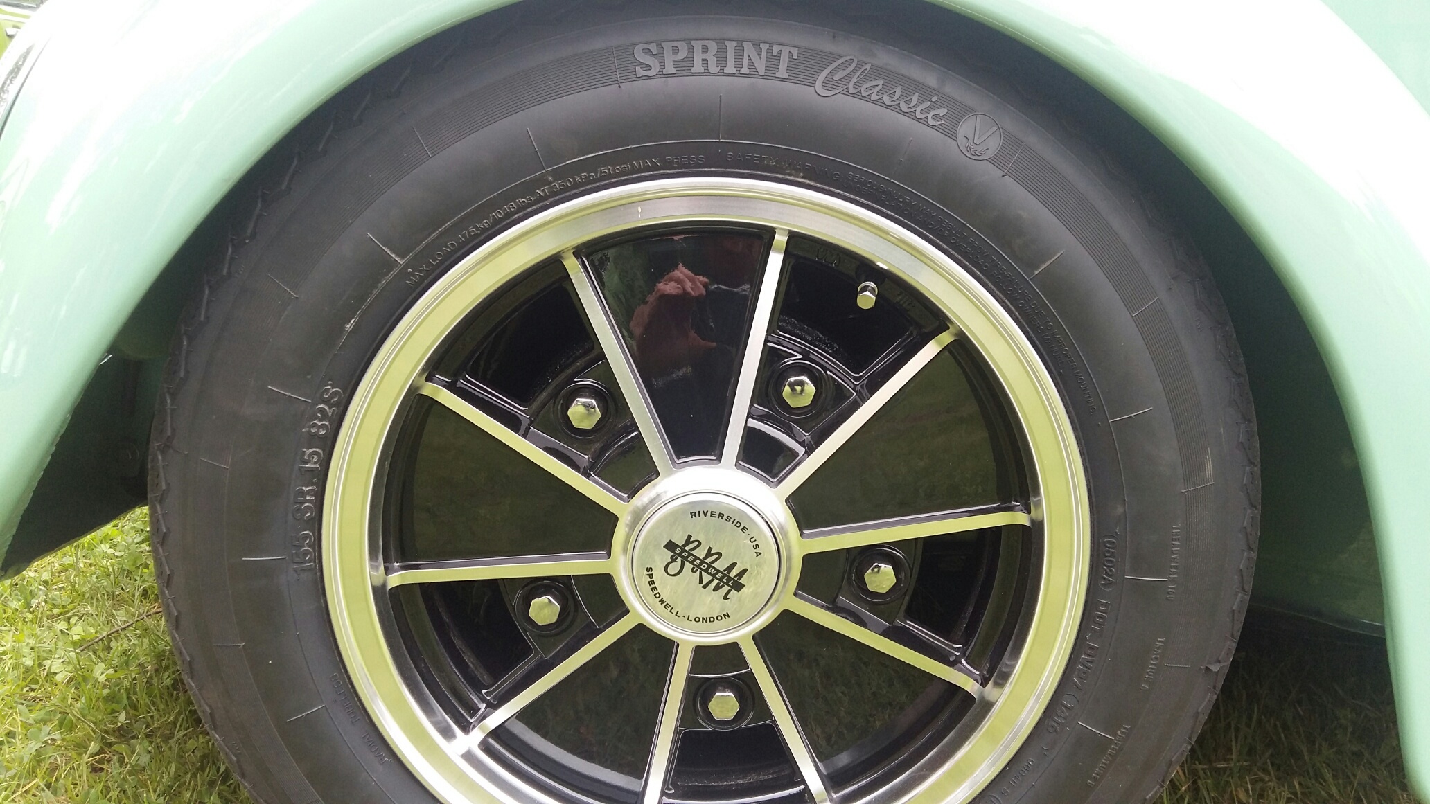

I like the Vredestein Sprint Classics, they are commonly used in Holand (and Europe) in the VW scene, modern tire with classic look, see pic attached. It is a 155 vredestein classic sprint mounted on the front wheel of a lowered bug, but you get the idea.
But there are many tires and types. Vredestein is a Dutch company (from origin) so that is a extra reason for me to like them I guess (IMG:style_emoticons/default/smile.gif)
