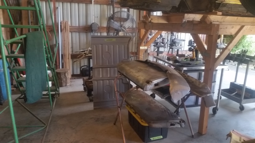

The day has finally come to start on Doug's car. Best we can tell it's a pretty solid car. But we won't know the truth until all the paint comes off.
The parts that are here on site were unloaded and labeled.

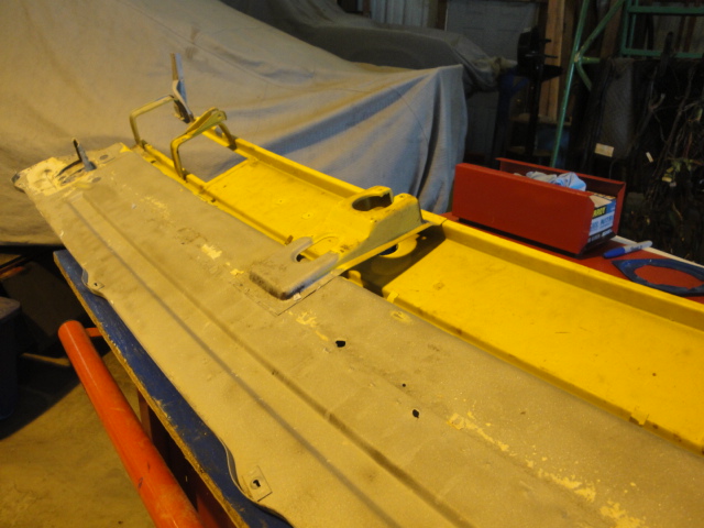

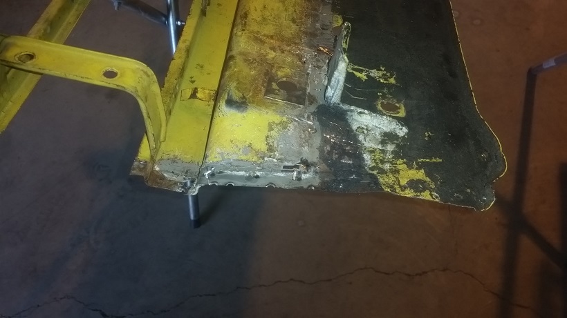

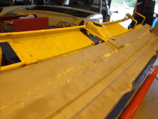

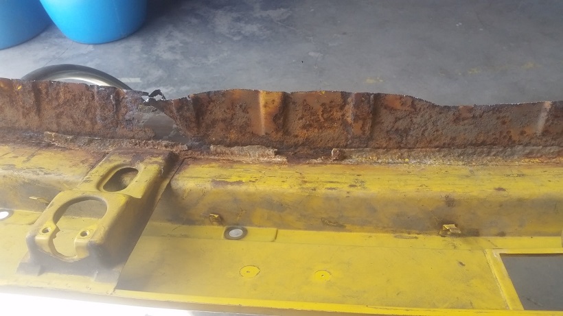

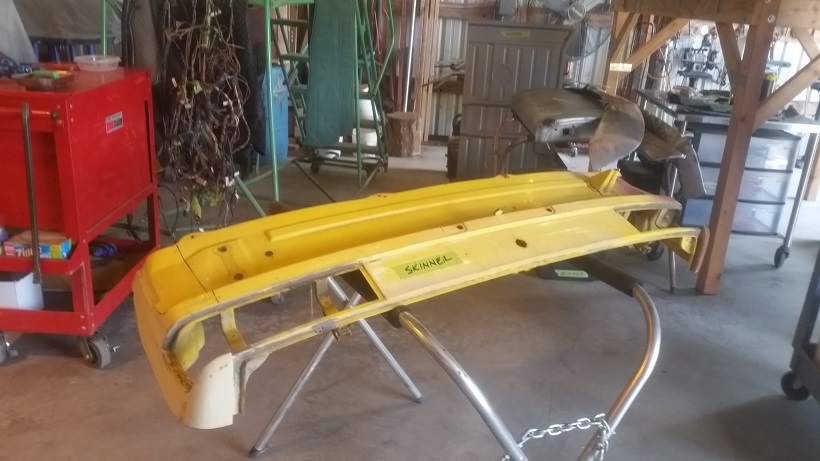

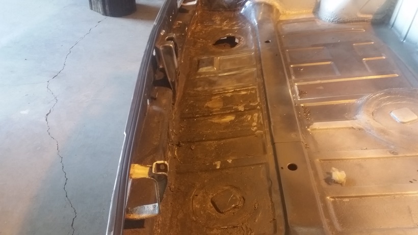

So time to dive in the deep end. I take a few minutes to survey the donor tail light panel. The rusted off trunk panel is a little concerning at first glance.

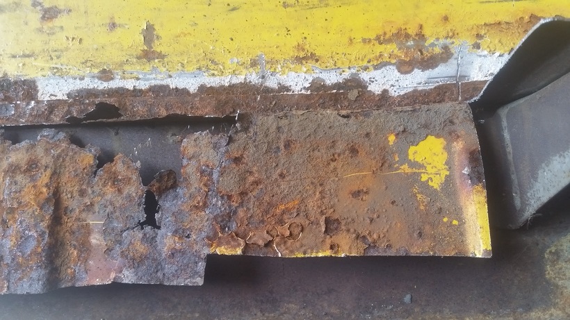

Here's why we're changing out the tail light panel and the rear half of trunk.
The rusty old trunk came out/off without any issues.
Added 7/7/2106

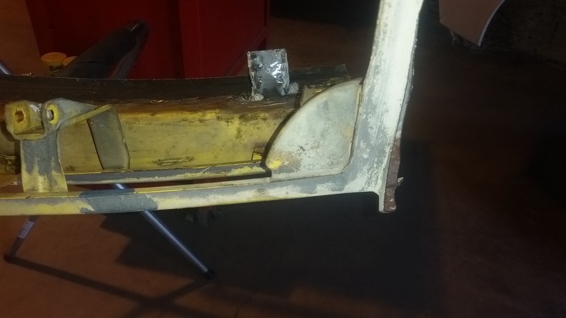

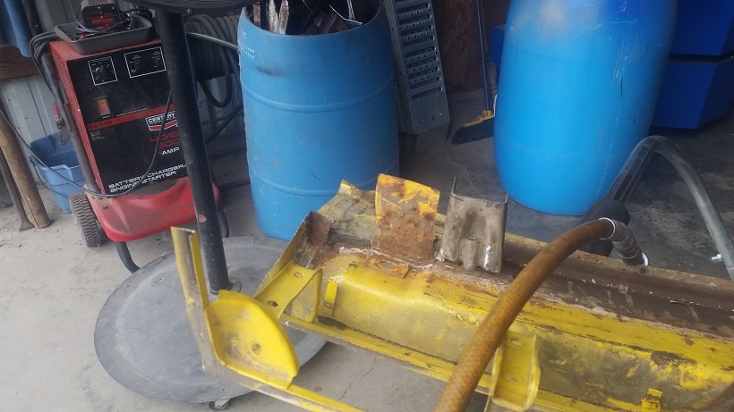

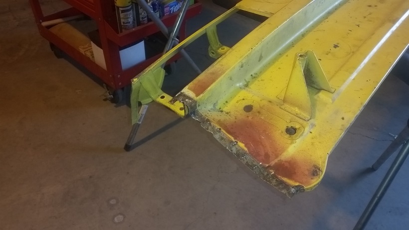

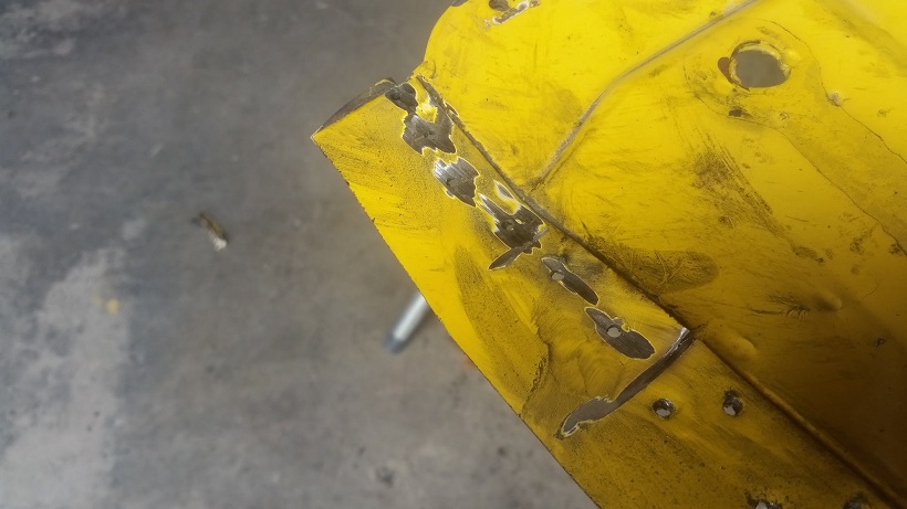

So on to removing the qtr. panel corners. Once again I'm using Rick's grind down and pop off spot weld removal technique. I've given it my own twist. To eliminate as much damage as I can to the piece/panel we're going to reuse. I cut down the welds on the side that will be discarded with the 3" die grinder on a mandrel. Like so ...............
I did drill an 1/8" hole in each spot weld to make sure I didn't miss any spot welds. This section is 3 layers thick in places.
Once again, to eliminate potential damage I take things out in 2-3 inches sections. You can see the remaining section of the rusty old trunk floor next to the support.

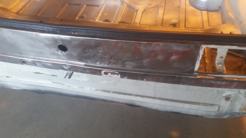

At the end of the day it came out relatively easy. A couple nicks, cuts and tears to weld up. But it's in good shape.
Tomorrow I'll get out the steam cleaner and get all the grease cleaned off. Then maybe I'll blast the paint off. That will be followed by getting the torch out to remove the corner tail light brazing.
