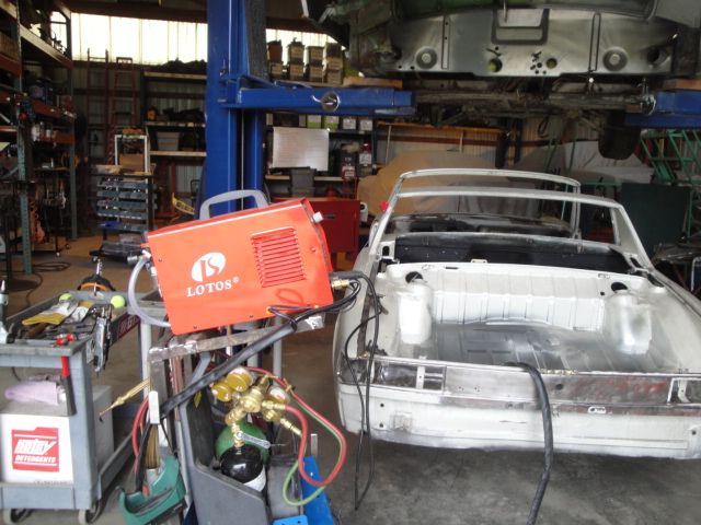

I decide its time to start using the plasma cutter for the cutting tasks its designed for.
Steve, one of my co-workers at Rothsport said changing the tip every time you use it is the primary issue I've been having. Easy Deal ....................
Big bite .........................

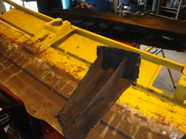

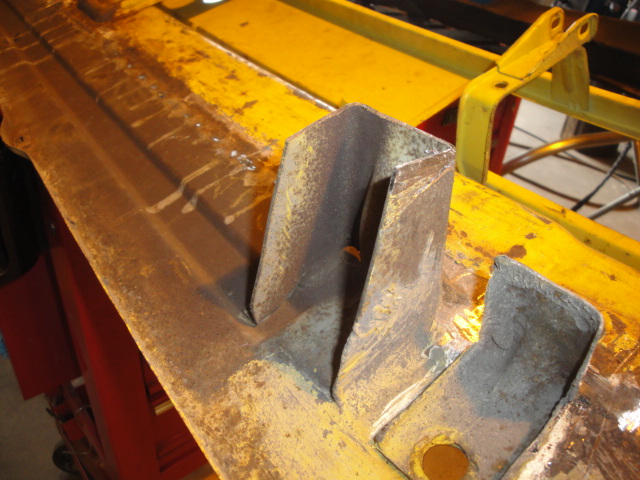

I discover that a portion of the tow hook brace is missing on the donor panel. I'll need to cut it off the original tail light panel piece.
There's a couple wicked welds were the tube is welded to the support frame. I'll have to see if I can delicately cut them out with new plasma cutting skills.
