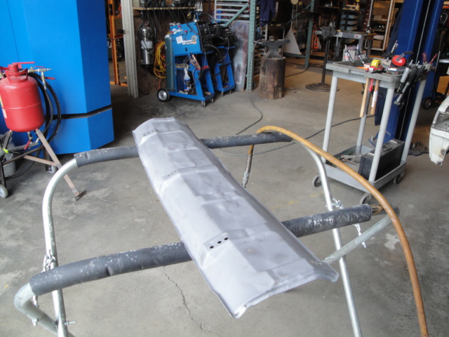

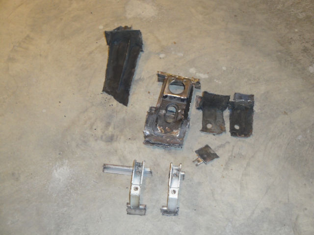

Then on to removing the exhaust shield from the old trunk panel.
Then I discover that the last person that removed the exhaust shield didn't have a MIG welder. The supports were brazed to the bottom of the trunk panel.
So they have to be separated with a torch.
Get that done and then run the stand offs thru the bead blaster. They'll need a little refurbishing.

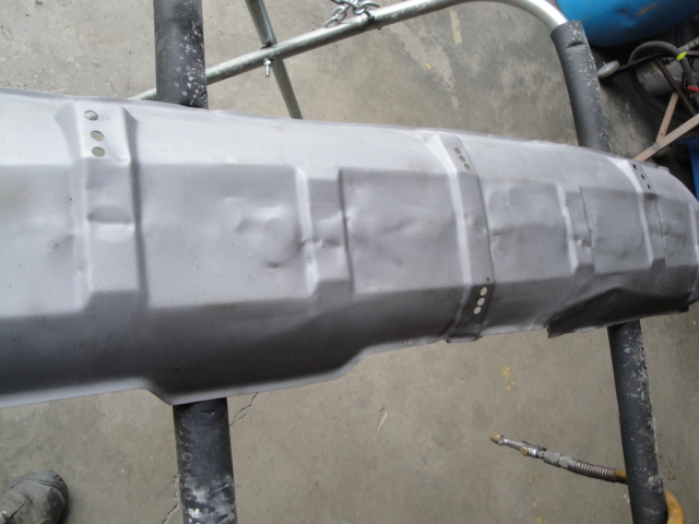

Then I decide that the exhaust shield needs to be taken outside and sand blasted. It's filthy. Covered in oil and dirt.
After the dirt and oil are removed it looks like its been beat on with a hammer.
I did remove all the odds and ends off the old tail light panel. You never know what one might need in the future.
