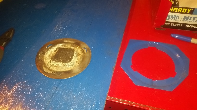

We did extract the other hole plug. Have the template ready to go.
I think I'll pick up the compass gadget for the plasma cutter.
