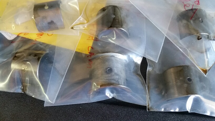

Looked at the bearings I took out of the motor, makes sense now.
Only one shell has the thrust surfaces, middle bottom shell.
Bearings not shown in assembly order, the pair that has one thrust bearing surface is the 1st bearing in the motor. The middle is a tad narrower than the rear bearing.

DavidSweden   Use the extra thrust bearing on the cam. BTW type...   Jul 10 2016, 10:29 AM
Mueller   Don't used straight cut gears, my great big e...   Jul 10 2016, 10:41 AM
Tbrown4x4   Only 1 half of a cam bearing has a thrust surface....   Jul 10 2016, 11:12 AM
Mark Henry   On the double thrust cam bearing couple ways to go...   Jul 10 2016, 11:26 AM
Mueller   Looked at the bearings I took out of the motor, ma...   Jul 10 2016, 11:32 AM
Mark Henry   If that used DT bearing has a copper face and is i...   Jul 10 2016, 12:04 PM
Mueller   If that used DT bearing has a copper face and is ...   Jul 10 2016, 12:22 PM
