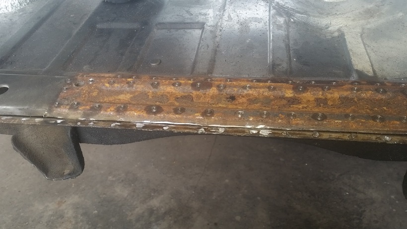

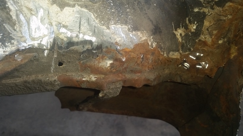

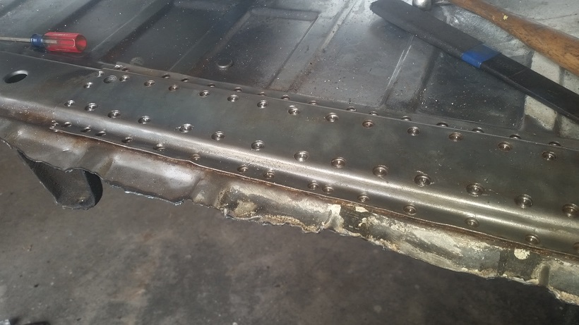

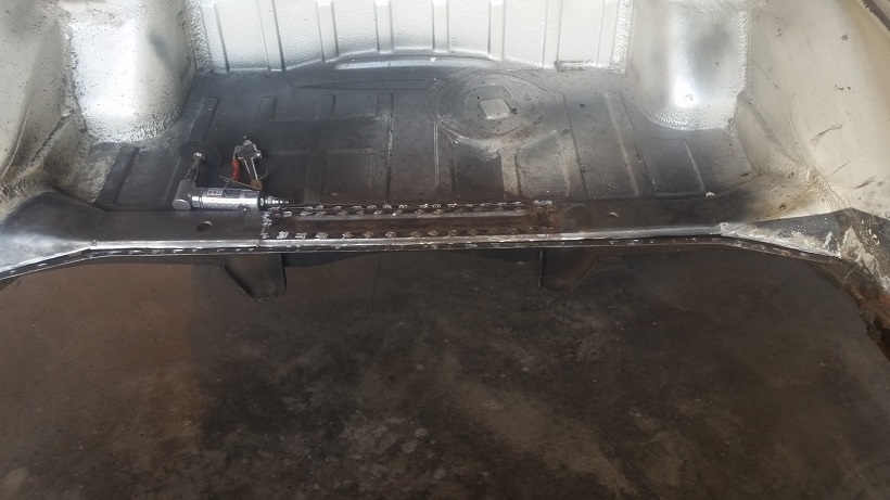

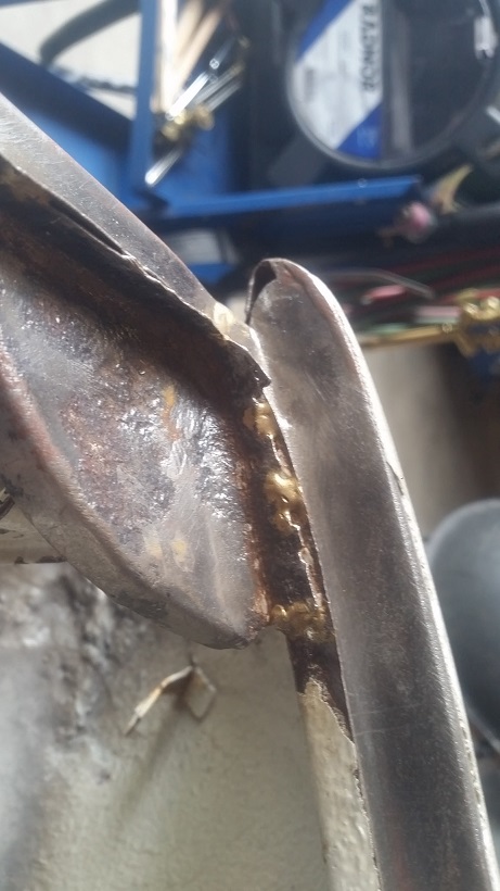

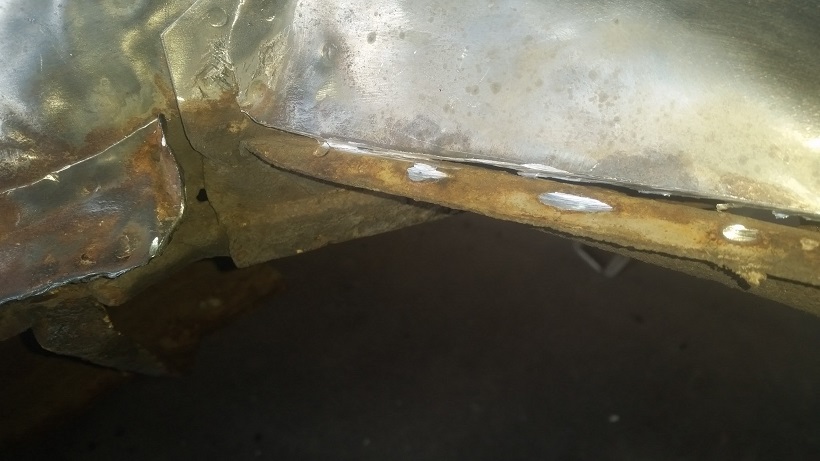

Monday AM :
Pulled out the torch cart and started with the remainder of the left tail light panel.
The car had been hit in the rear and been poorly repaired on the past. The entire tail light panel was brazed in, not welded.
Then started working my way around the remainder of the trunk panel.
Then on to removing the center reinforcement panel.
Making my way into the right corner. We're finding the inner fender above the trunk panel is pretty wrinkled on both sides.
I may look at cutting both back corners out of my parts car. We need the fender support straps too.
End of the day ......................... got farther than I thought I would.
