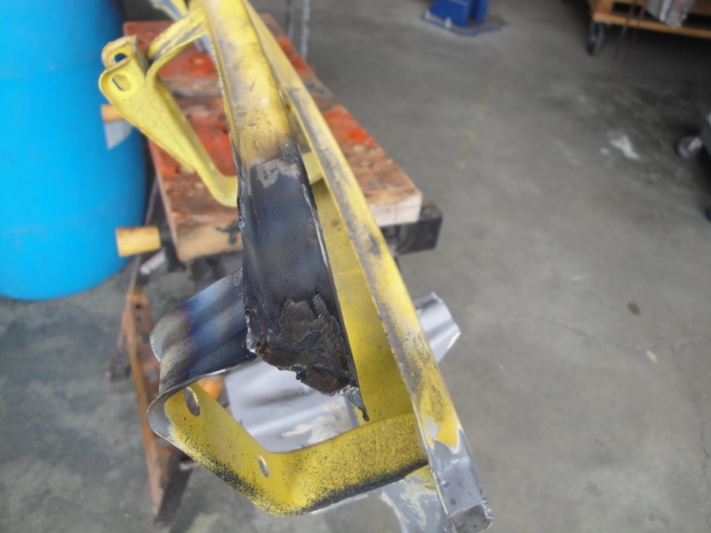

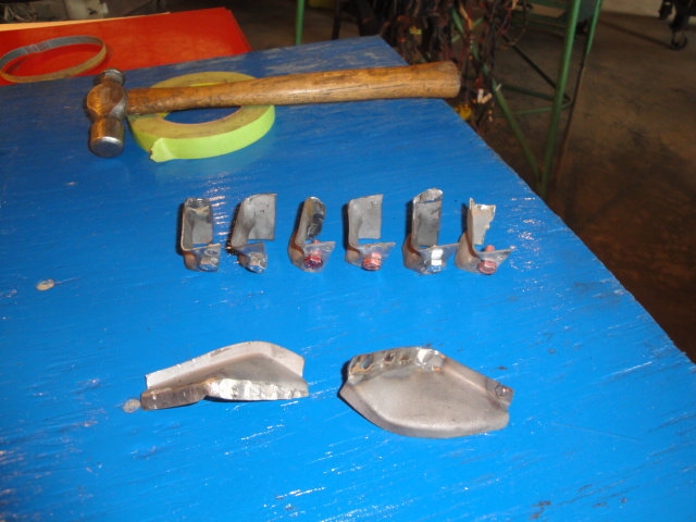

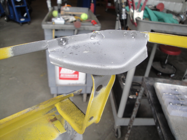

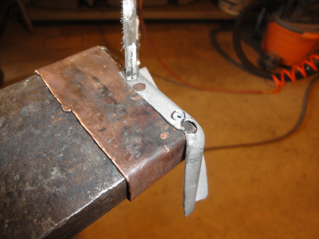

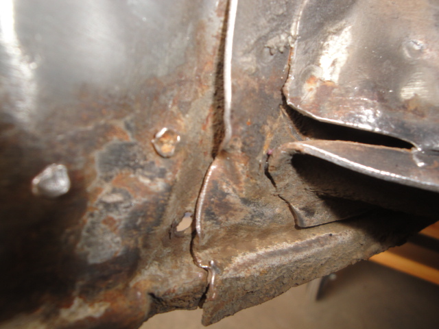

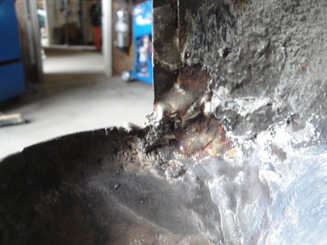

Came in this am and did some more examining of the wrinkles in the trunk corners and some magnetic testing on the qtr. panels.
While I'm digesting my research I begin removing the corner braces and refurnishing them.
This time I run into lead and brazing.
After finishing the corner braces I move onto the exhaust stand offs. Three or four needed some welding, but pretty simple stuff. All drilled and ready for welding on the nuts in the am.
I decided before I start cutting on the trunk I'll sand down the back corners of the qtr. panels to check the less than stellar previous workmanship. From the inside of the fender it feels like the previous shop didn't own a hammer and dolly. (IMG:style_emoticons/default/mad.gif) Which means we have quite a bit of filler. Lazy ........... But only dimples, no creases.

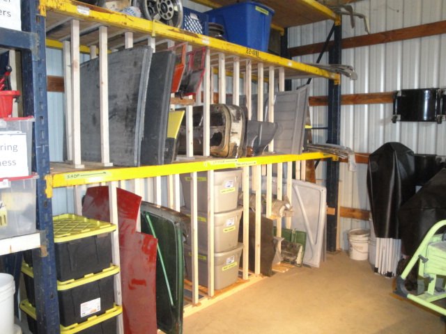

Super In Law finished up the rack and we filled it up.
We'll need to create a wall racks for the valances. They're too wide. But other than that it turned out great.
