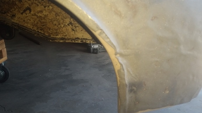

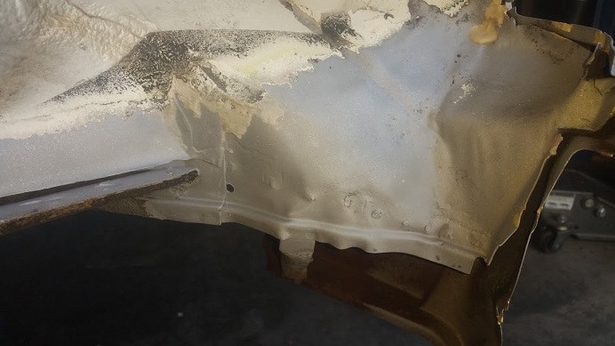

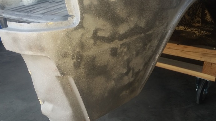

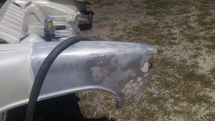

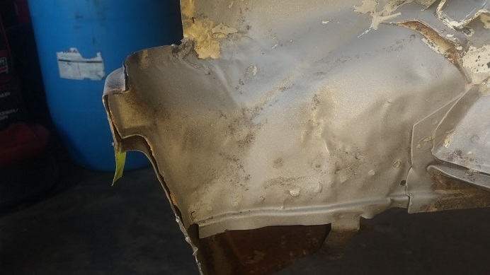

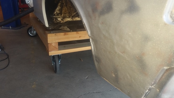

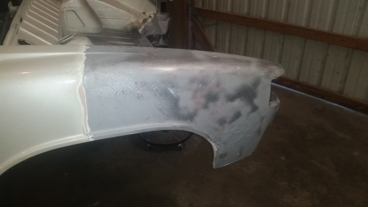

Short day ...................spent the am at Rothsport doing a little housekeeping.
Got there after an early lunch and rolled her outside for some media blasting.
Looks like we'll be needing a couple lower back qtr. panel corners.
Mud in the dimples ....................
Right side, not much better.
Filled with mud, rather than repairing.
Better shot of how rippled the left fender is.
Now that I can see the entirety of the inside corners I think I should be able to doctor them up. I'll start with hammer and dolly and see if we can make them presentable.
In the end they get completely smothered in seam sealer.
I'll let Doug look for some qtr. panel patches and I'll get back to the trunk and tail light panel.
Edit : Forgot we can cut the right one off my parts car. Left was butchered for a flare install that never happened.
