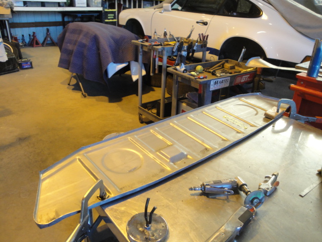

Start the day with trimming the trunk panel. Not an exact cut. I leave about 1/4 too long.
Then I give it a test fit.

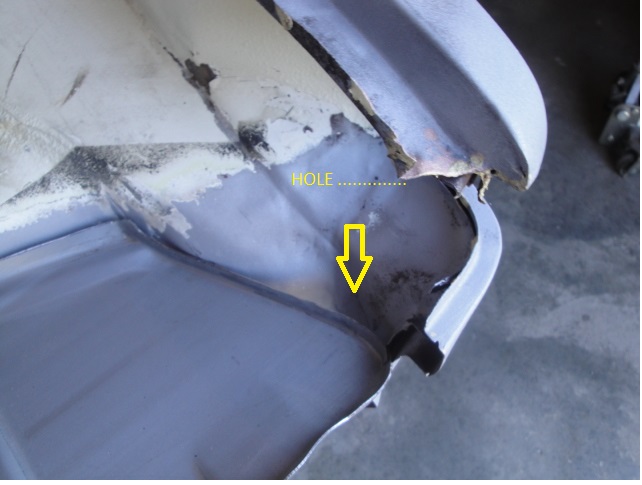

Left seems about like normal.
Right side, not so much. Giant hole.
Poorly done repair.

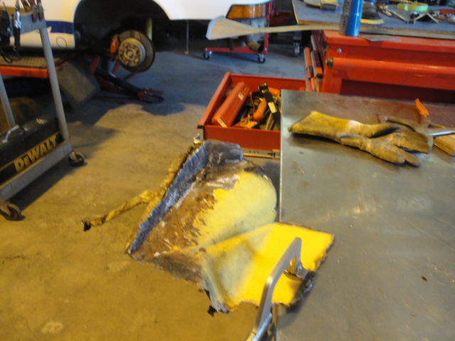

I make the decision that cutting the same section out of my parts car is the best answer. Creating the bottom lip would take too long.
Cut it out large. Then took it to the bench and removed the trunk floor portion.
Trimmed off the top.
