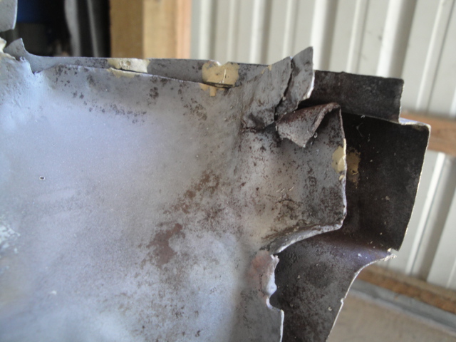

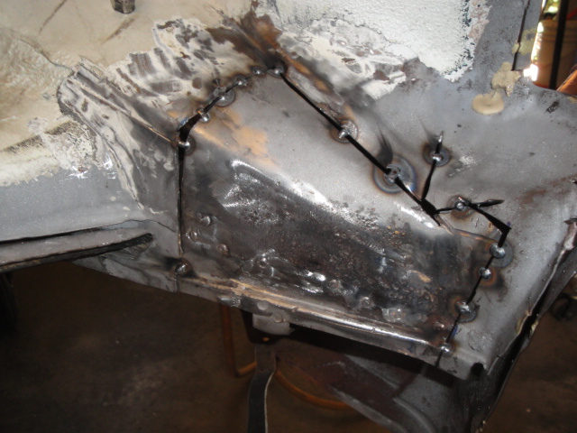

So in goes the patch after the usual fiddling and fussing. Trim, grind, repeat. Trim, grind, repeat. Had to make extra cuts to reshape the existing panel. They hammered the crap out of it.

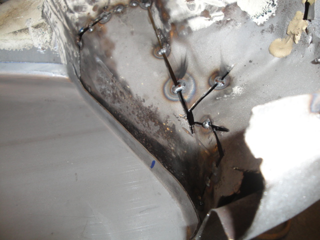

After I finish welding in the patch. Here's the next challenge.
Going to try something a little different with welding in the sides of the trunk pan this time. Rosette welds on the front portion. Then in the back where we have the gap. Instead of rebuilding them I'll bend/fold them over and tack weld the top edge.
Once again, they'll be smothered in seam seam.
