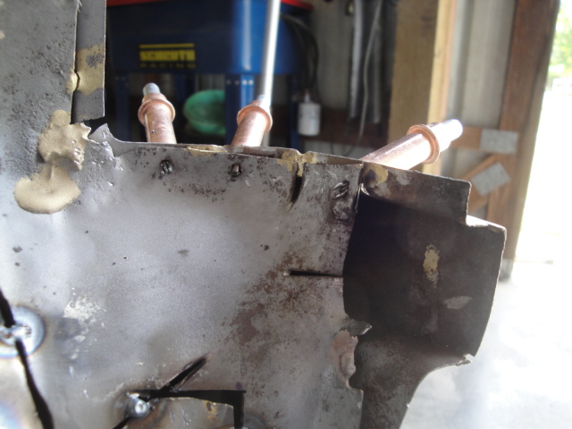

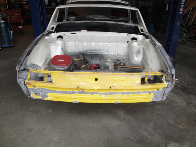

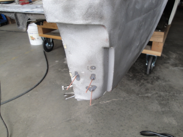

Here's a shot of the buggered up tail light panel frame.

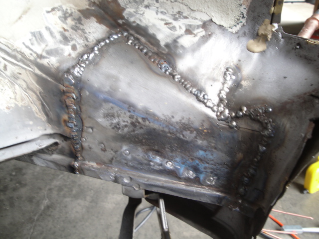

Finish welding in the donor patch.
Then I do some tinkering on the back end of the qtr. panel. They hammered out the crease. (IMG:style_emoticons/default/sad.gif) . Why ?
Might be changing it out too ...............
Then I test fit the tail light panel. Other than bottom portions on both sides, it fits real well.

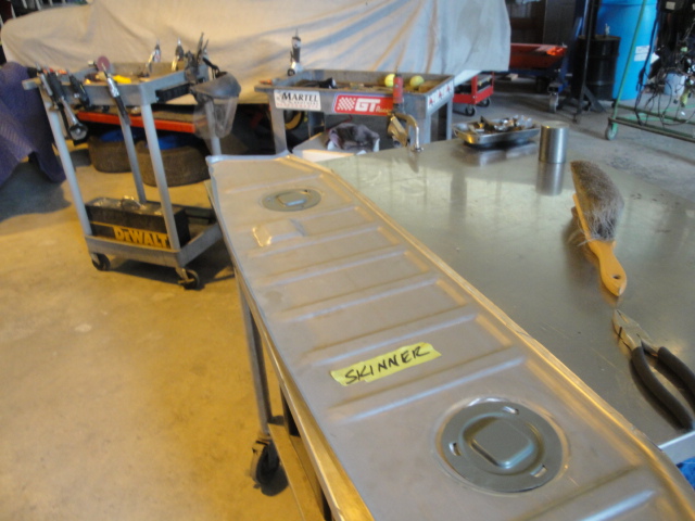

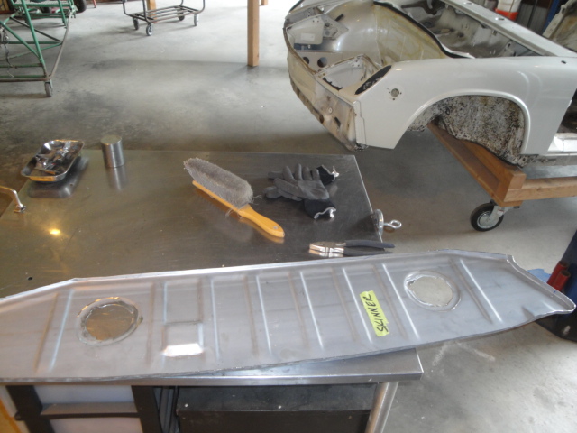

Next I cut out the trunk panel for the pan plugs.
Doug stopped by after lunch to drop of the hoods. 2 old metal ones. And the new fiberglass rear trunk. Cool

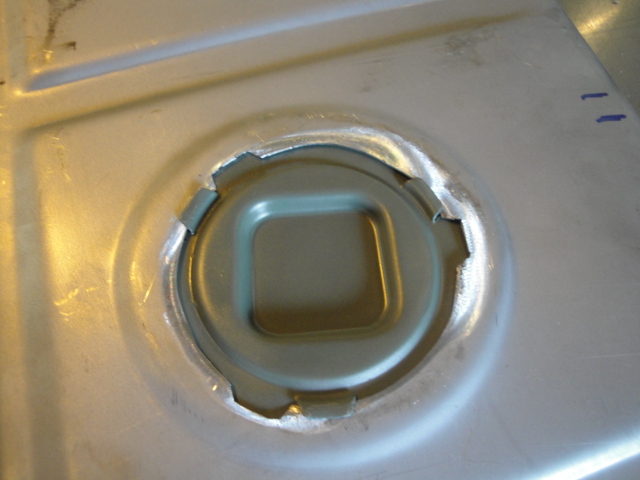

cary   I decide its time to start using the plasma cutter...   Jul 7 2016, 09:17 PM
cary   Then on to removing the exhaust shield from the ol...   Jul 7 2016, 09:41 PM

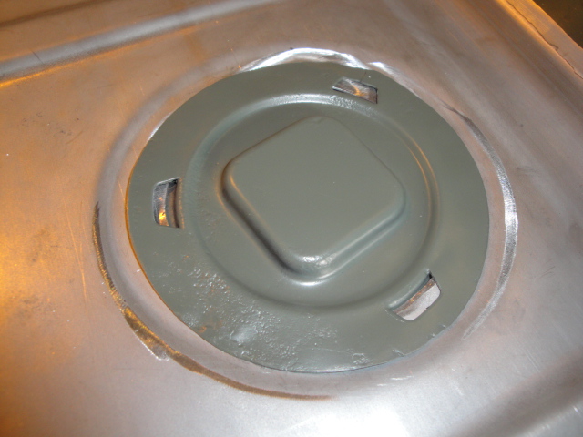

cary   We did extract the other hole plug. Have the templ...   Jul 7 2016, 10:09 PM
cary   Monday AM : Pulled out the torch cart and started...   Jul 11 2016, 09:50 PM
