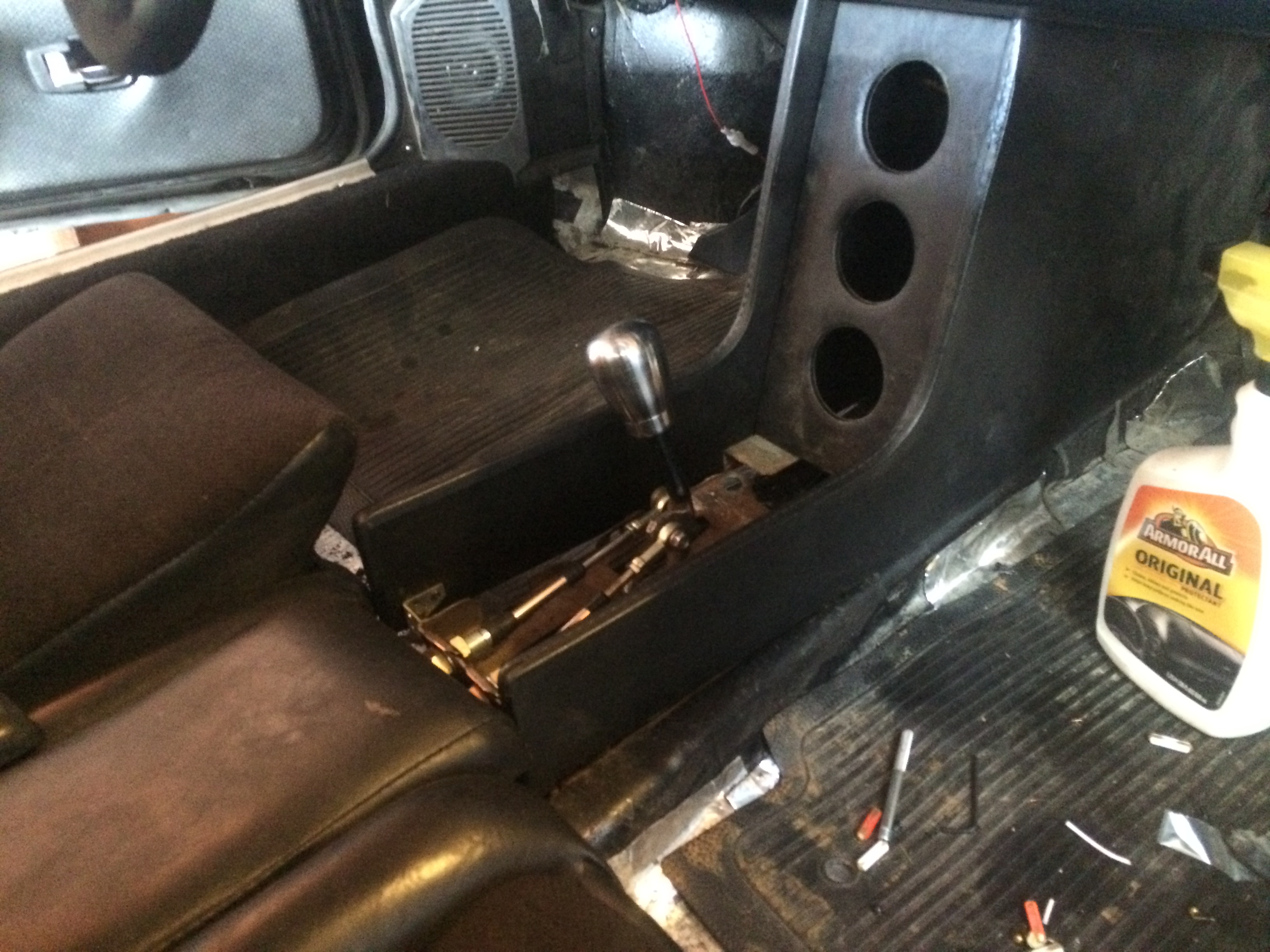

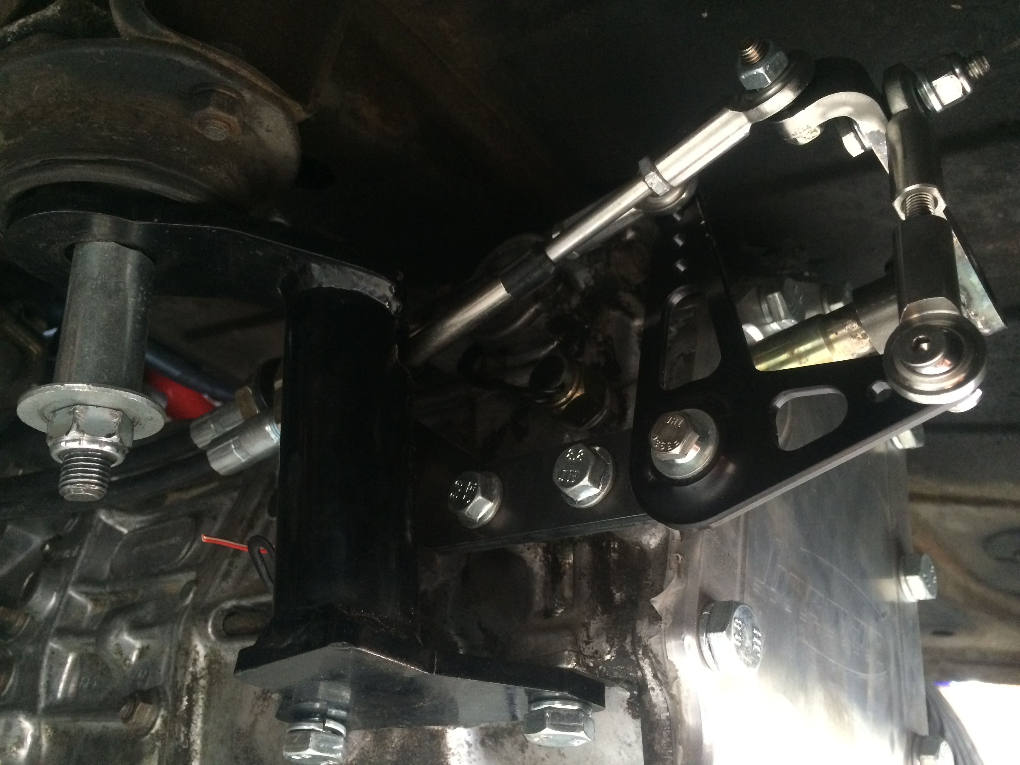

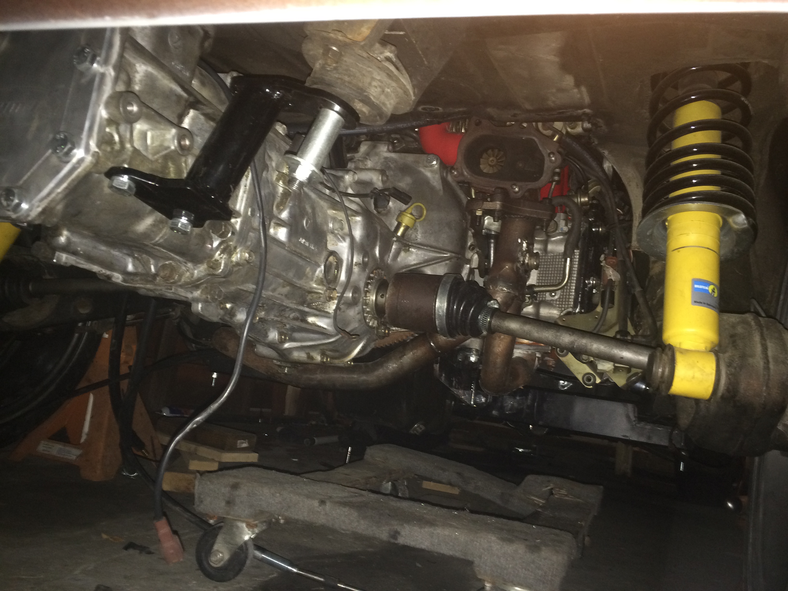

First off in the above picture i haven't cleaned up the hoses it will look way nicer. I have also completed ians cable shift install and man is it fun to bang through the gears of a stationary car!Attached Image Attached Image Another thing is i have installed the axels after having them resplined twice: a 150$ mistake But i will say this OFFICIALLY when using Subaru inner cv the axel is cut to 17 3/4" Attached Image
