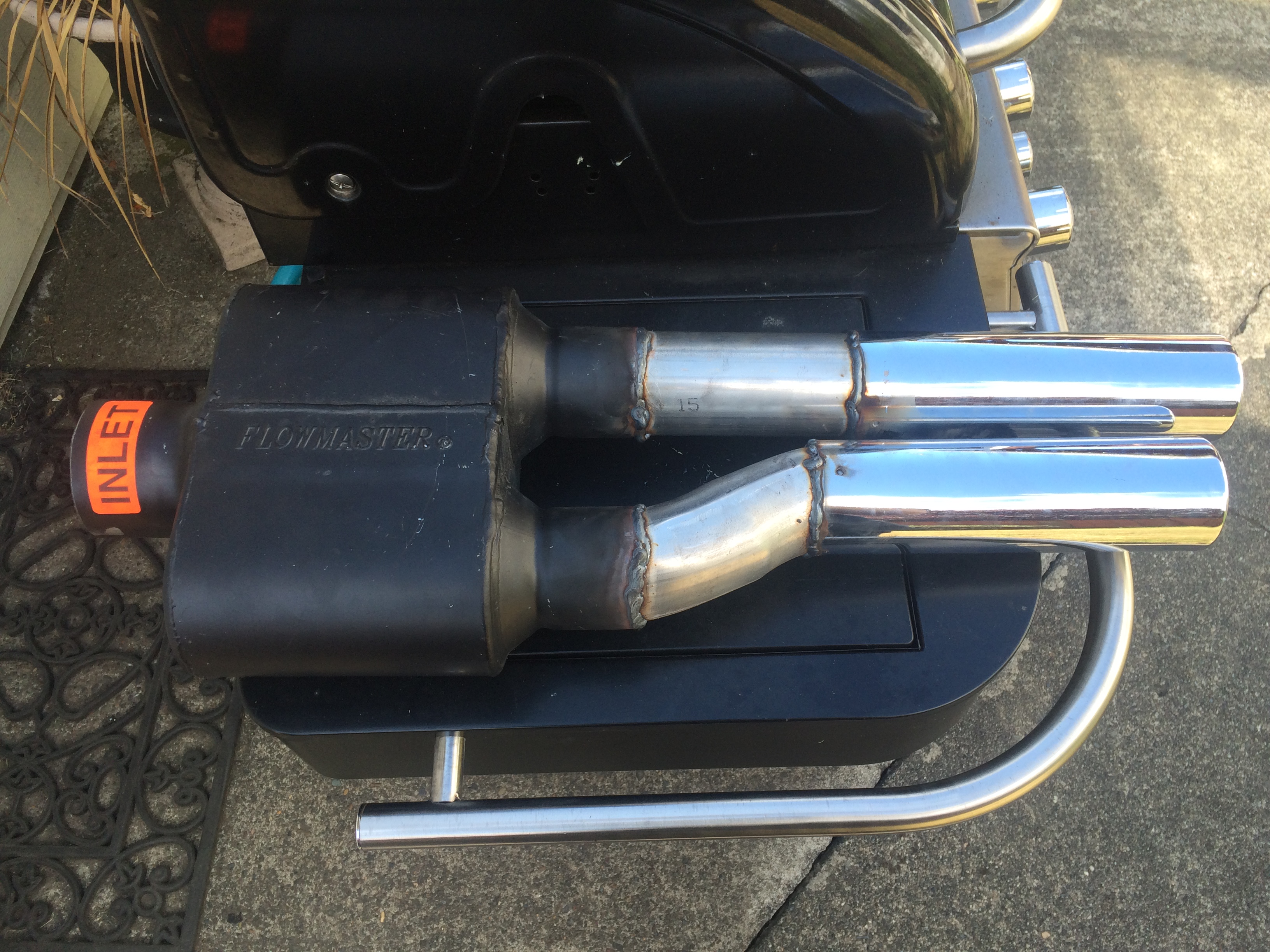

One more hopefully awesome thing before i get back too it, because my car is low and I don't like things being ripped off, i will have my exhaust exit through the bumper, its a fiberglass one so no one is butt hurt. The exhaust is a 240z style attached to a flowmaster super 10!
