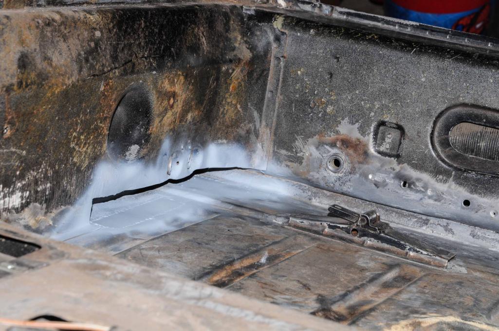

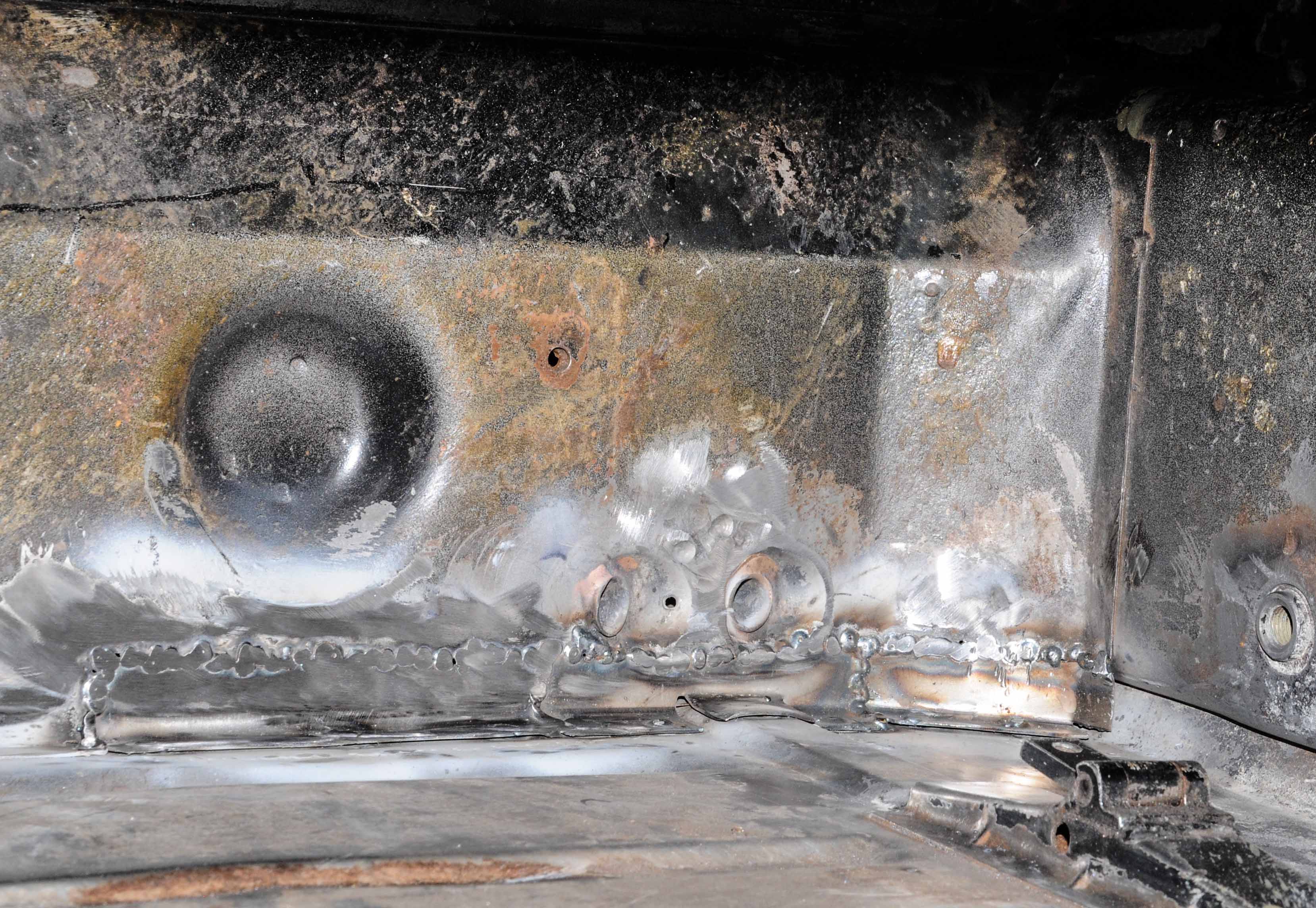

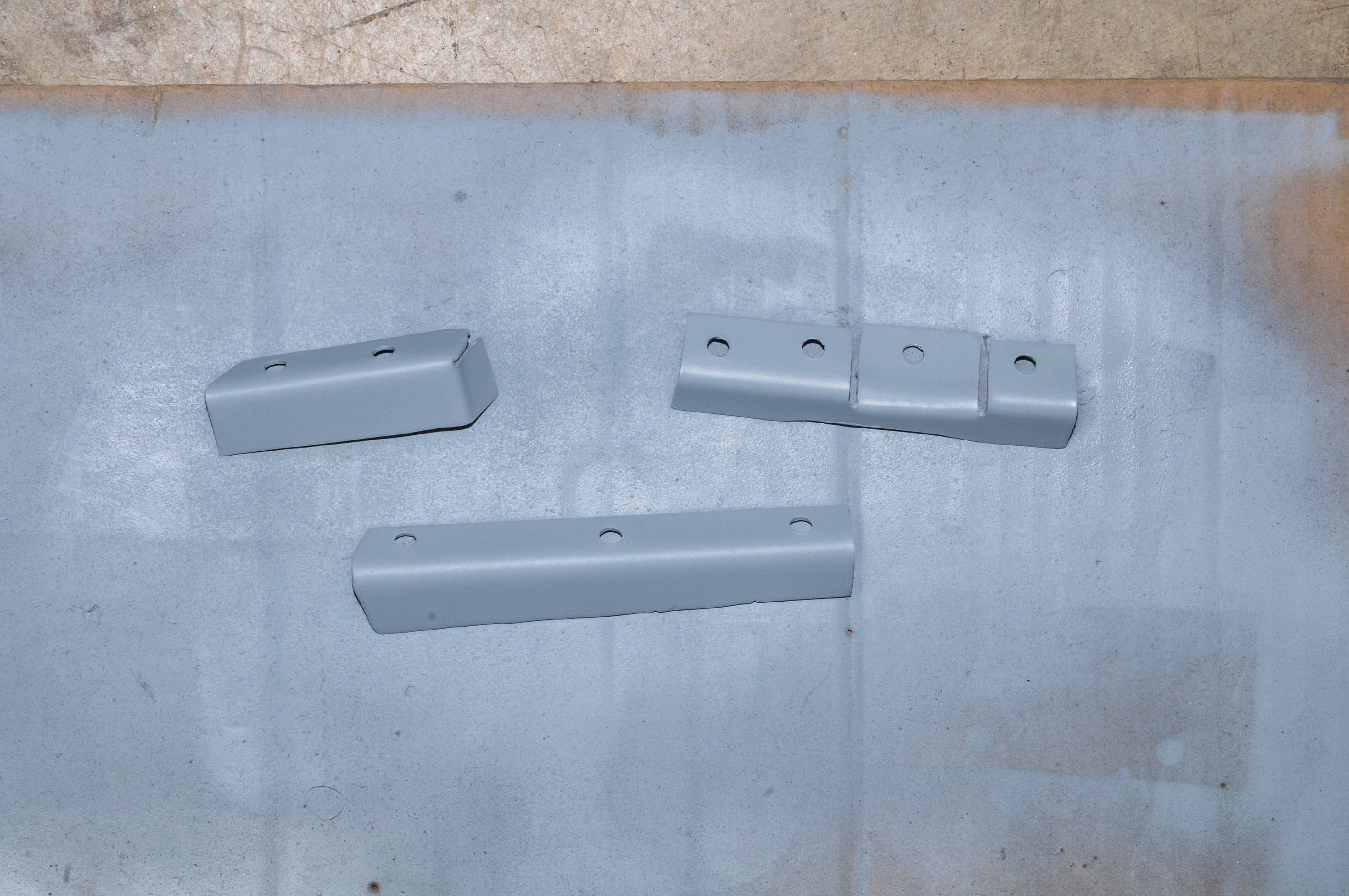

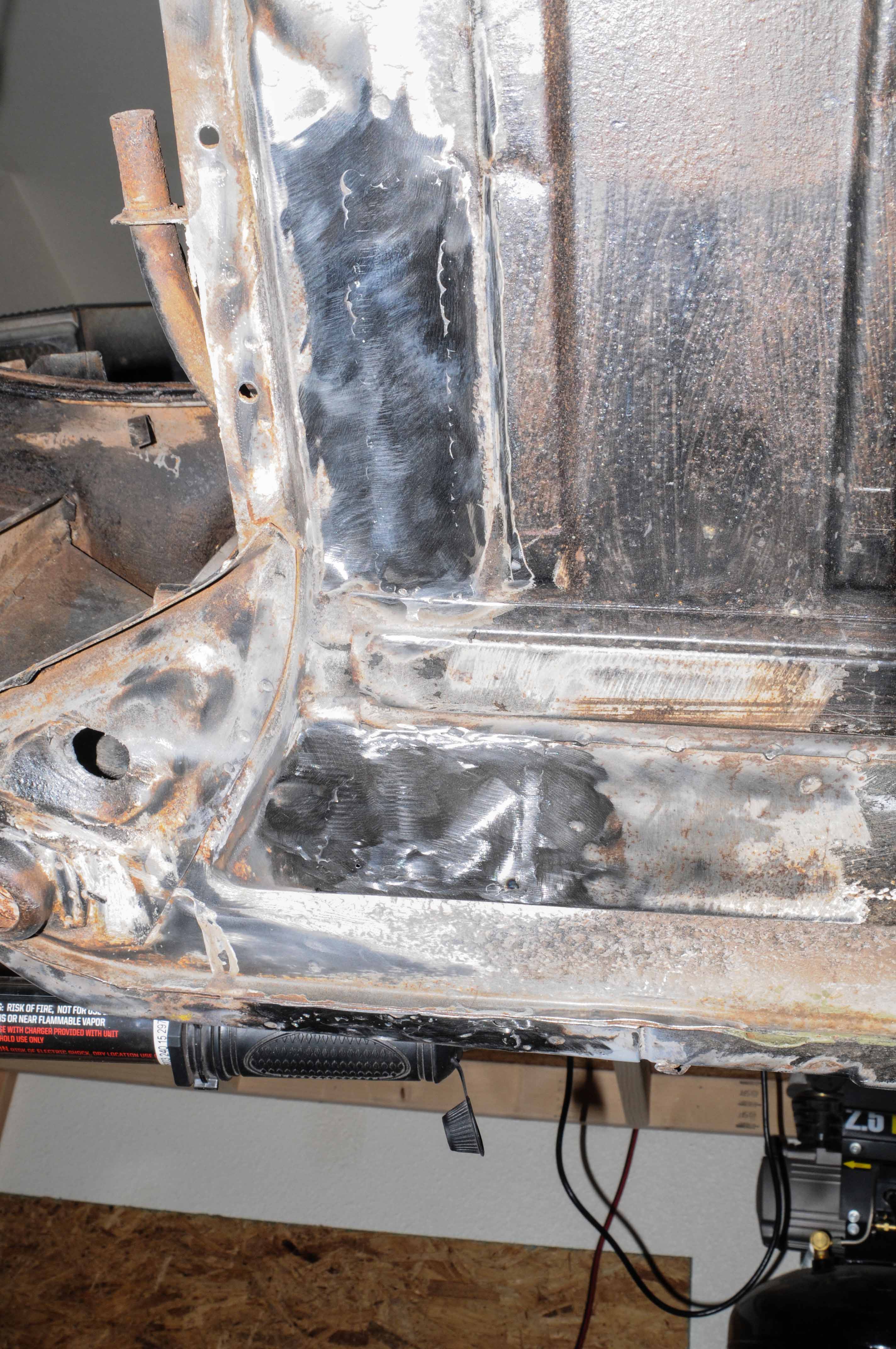

Sunday. Shop soundtrack: Ramones discography.
It was a really straightforward day, the biggest challenge was using scrap pieces of sheetmetal prudently. Step 1 was just cutting some metal and welding it into the holes in the floor. Step 2 was to make the 3 firewall patch pieces. 3 was the weld-thru primer. 4 welds. 5 be lazy grinding.
The floor stuff was simple, and the firewall pieces weren't that bad considering I learned the tricks when I did the other side, but this side was harder since I had to work around the e-brake cable holes, and I had the floor in. At some point in the afternoon my soundtrack ran out as did my patience so I gave up on the grinding. It's a really tough area and may require the Dremel to really get the welds ground down, but I also know that I didn't get the pieces perfectly lined up so it will never be perfect. I figure I'll reevaluate next week and decide what to do...because my attitude today is thinking: "it'll all be slathered in seamsealer and hidden behind the backpad anyways..." Attention to detail, just didn't have it today.
I also didn't get around to the foam removal, which considering my attitude is probably a good thing.
I forgot to mention that Saturday's rust discovery resulted in also having to remove the e-brake cable guide. It's not really rusted but the stuff behind it had a little surface rust killed by the wire wheel.
