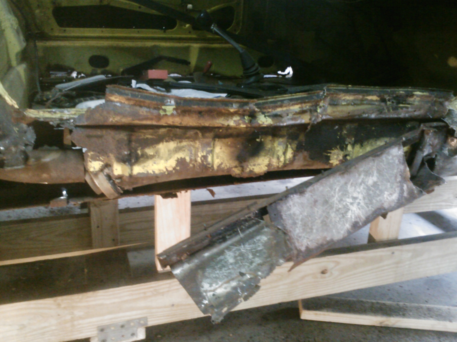

New member to the 914 world. I just bought this car yesterday as a project car for me and my son and now wondering if I may have bitten off more than I can chew. I am mechanically inclined and do most of the mechanical work on the cars I have owned but this may be a little more than my pay grade. I have never welded or done body work.
It is a 1972.
I purchased it from an older lady for $1000, it belonged to her son who passed away about 5 years ago. She needed the money and I initially thought it would be a good project. It has been sitting in the elements and baking in the hot sun of Las Vegas for the last 5 years, so every piece of rubber and the interior is shot. The engine is there but I have no idea what condition it is in. She thought it may have ran when it was parked but is unsure. No keys to the car.
We are on a budget and would like to bring the car back to a daily driver status. What do you all think?
She tried to cover the car with tarp and tape it down with duct tape but that didn't last long.

If the longs are good then go for it!
If it is too rusty you can start repairs with your 15 year old, and finish the car when the 4 year old grows up!
Good luck and Save the Porsche!

Jeff Bowlsby   With all that context...sell it or part it. It wi...   Jul 18 2016, 09:48 AM

DirtyCossack   I think it really depends on the condition of the ...   Jul 18 2016, 10:16 AM

DirtyCossack   Also, if it is somehow rust free, the tub could be...   Jul 18 2016, 10:21 AM
KELTY360   :wttc: First off, it looks like there are plenty...   Jul 18 2016, 10:28 AM

barefoot   Remove the rocker panels and look for rust where d...   Jul 18 2016, 10:43 AM

Mark Henry   Since it's a LV car the chassis may be in surp...   Jul 18 2016, 01:39 PM

DirtyCossack   If the chassis is solid, you can do it for $4...   Jul 18 2016, 01:53 PM

rick 918-S   We need more photos to be able to assist with advi...   Jul 19 2016, 06:03 AM
RobW   :agree: Strip it down and assess the common probl...   Jul 19 2016, 06:44 AM

Lemmonhead   Thanks for the replies. I can see some rust on th...   Jul 19 2016, 10:12 AM
